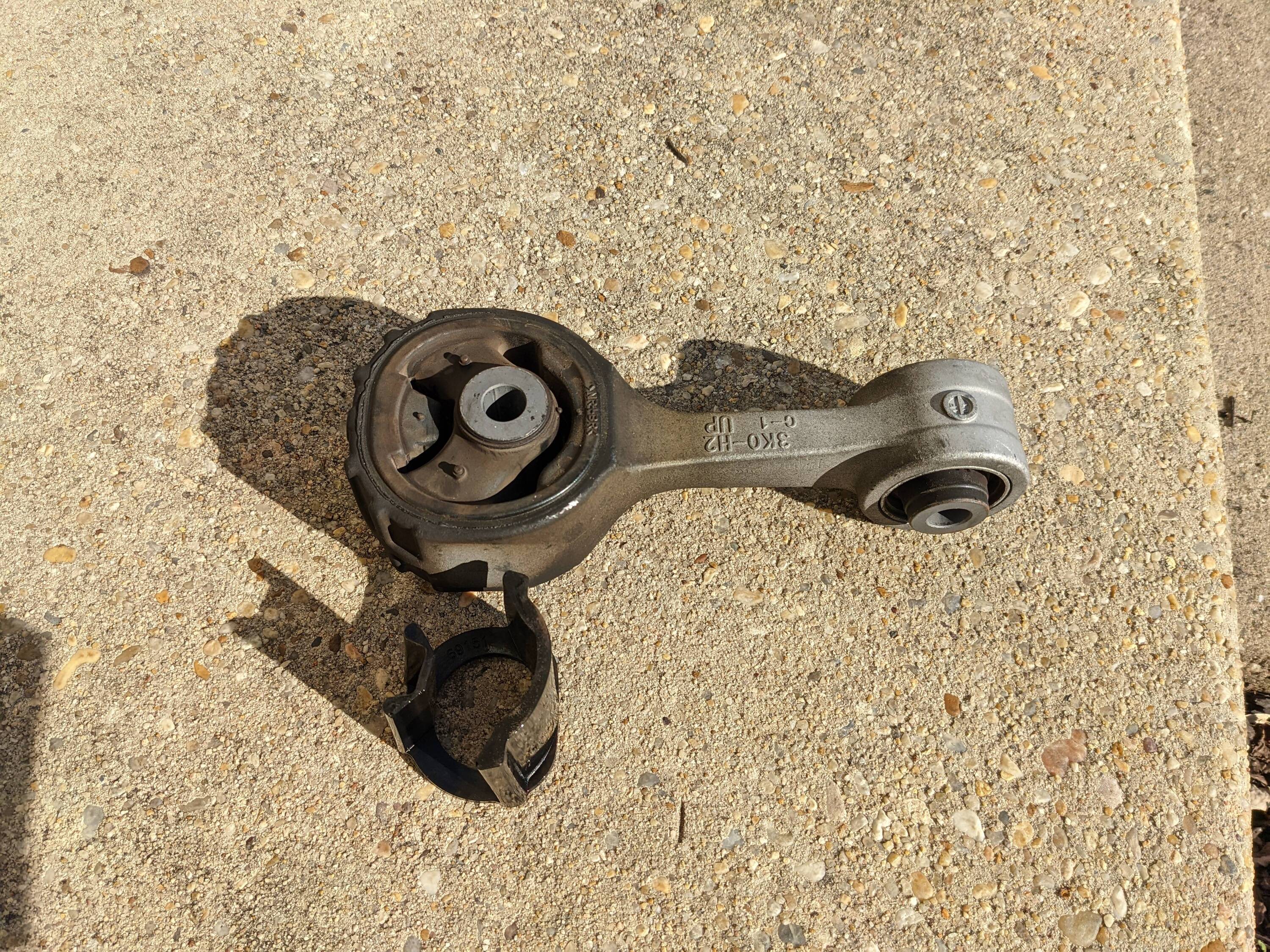

On an educated guess, I bought myself a Whiteline RMM insert for a 10th gen Civic and tried to fit it into my 11th gen Si. It went in perfectly without issue, but doesn't completely fill in all the voids in the 11th gen mount. If anything it might make the mount feel a little less vibey.

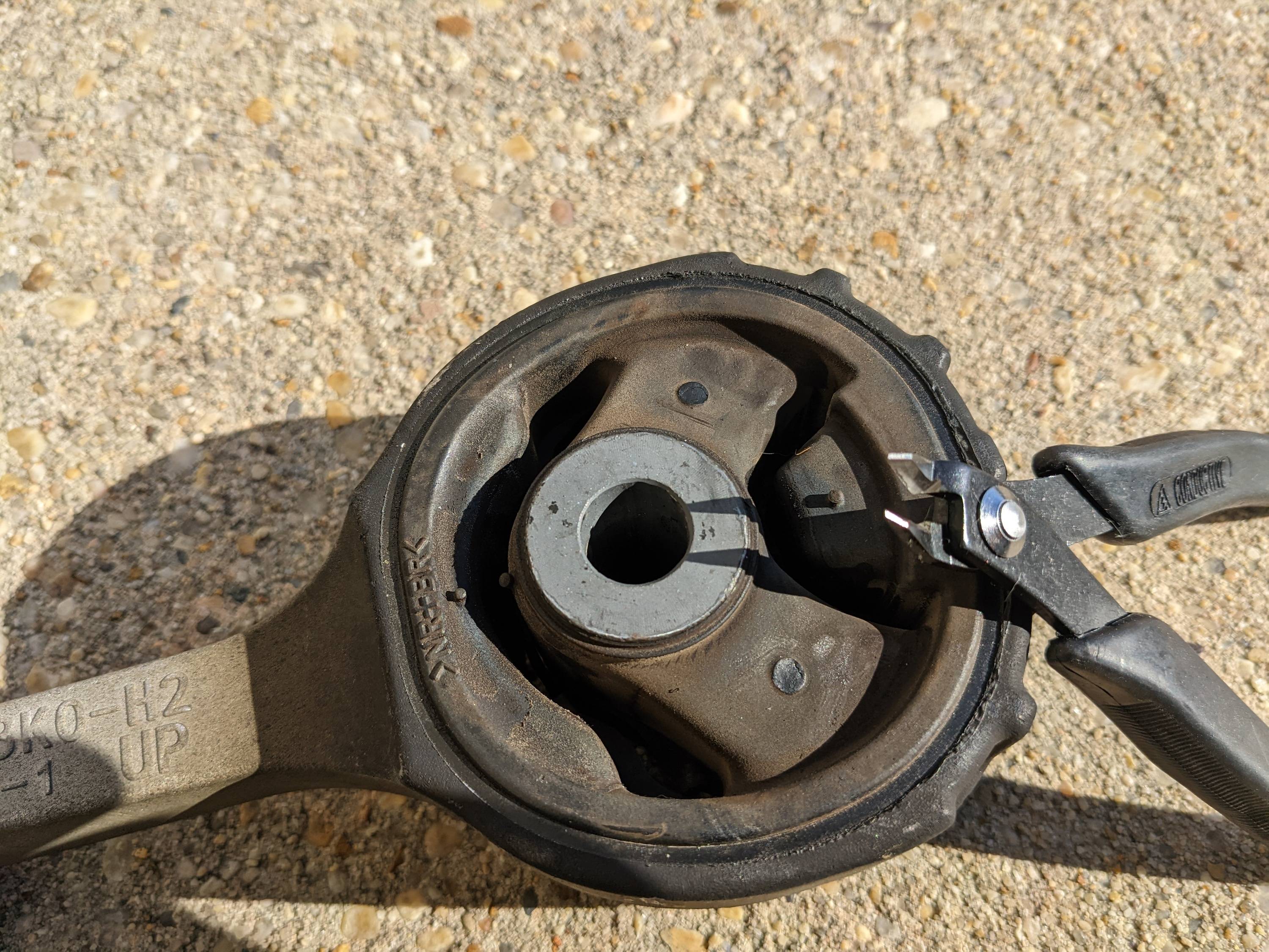

Clipped the nipples one the OEM rubber.

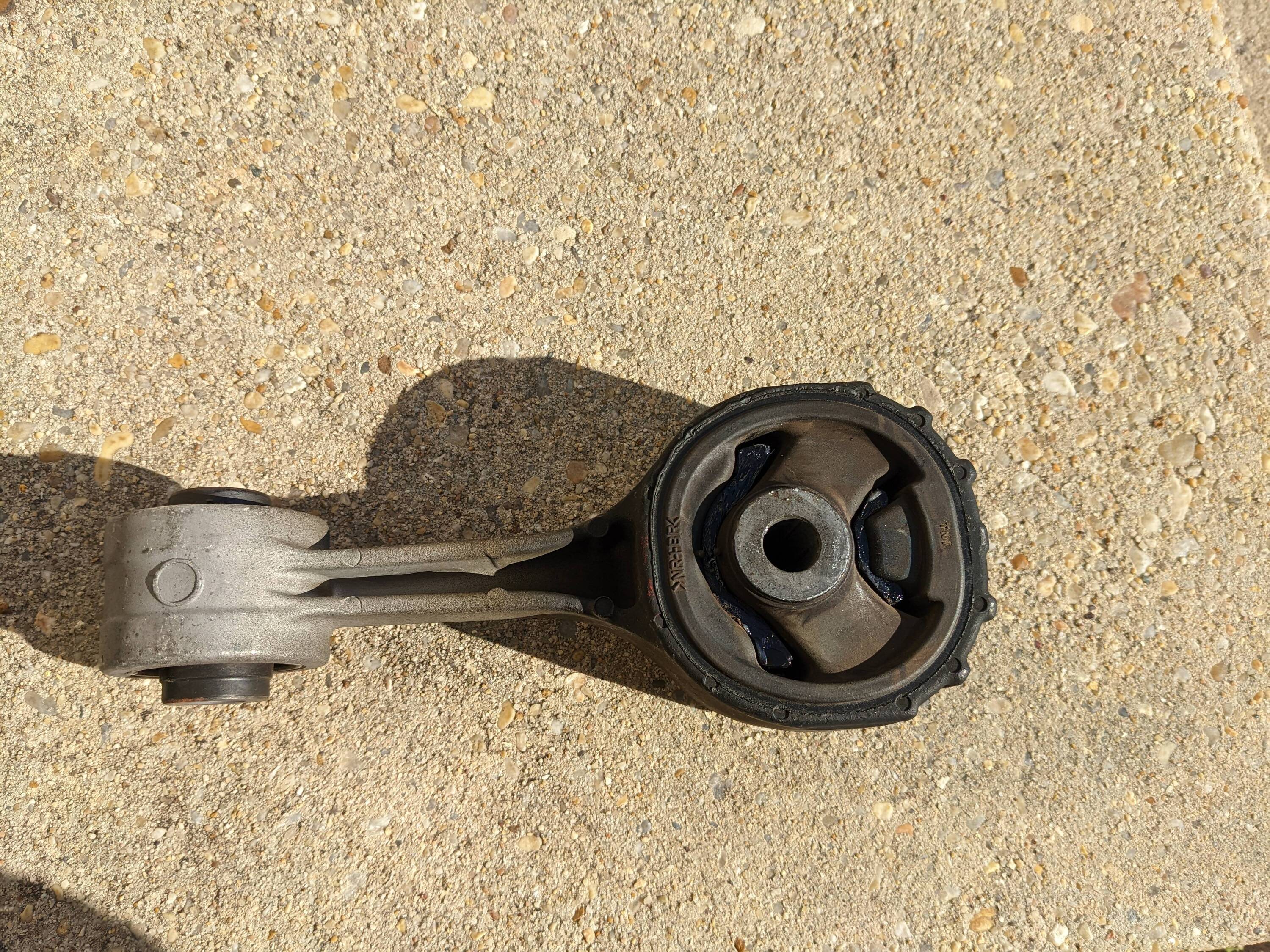

Top side.

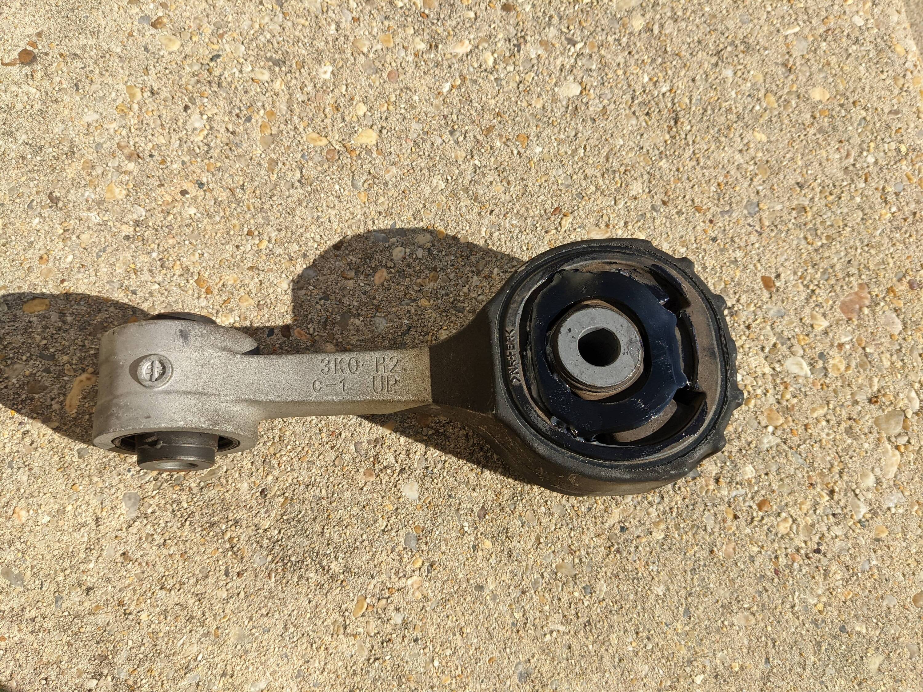

Bottom side.

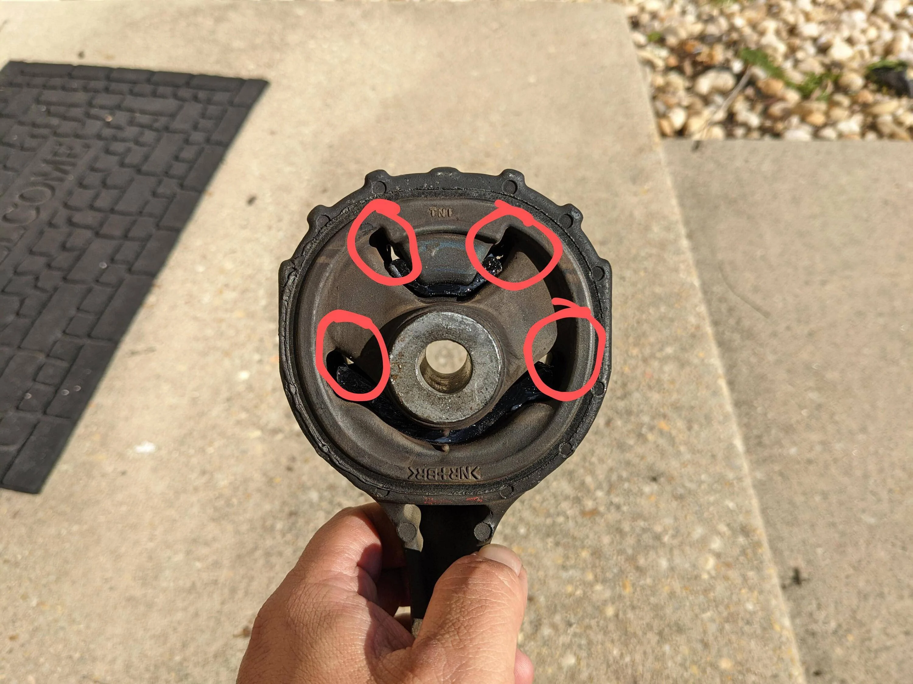

Circled the areas that don't get filled by the mount.
After driving the car it definitely feels a lot more solid, much less rocking of the motor under acceleration and when letting off the gas. I haven't yet launched the car or grabbed a gear hard to see how much it reduces wheel hop. I'm sure it will reduce it a good amount after feeling how much it reduces motor rocking. As for NVH it's there, but not annoying at all. I feel just a small amount vibration though the steering wheel and pedals at idle.
