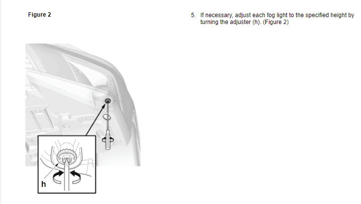

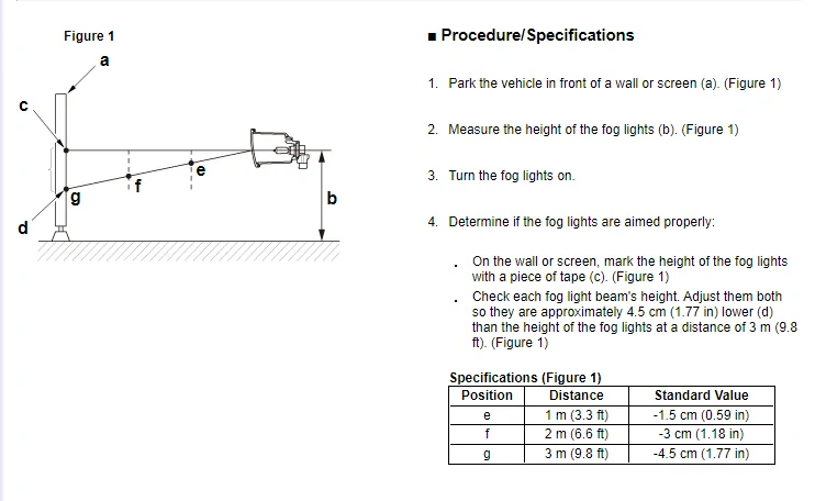

Here's a rear-view of the fog light assembly for anyone wondering.
Looks like a super easy swap!
