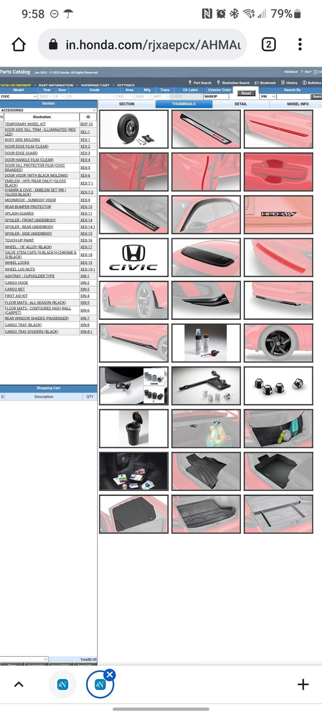

Hatchback does though ?

^There's a lead if the hatch wheel is available that means Honda USA will sell replacements, though I am sure other spares will fit if needed. I can measure my spare tire if anyone needs to know the sizing /measurements etc.
