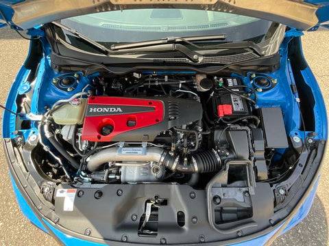

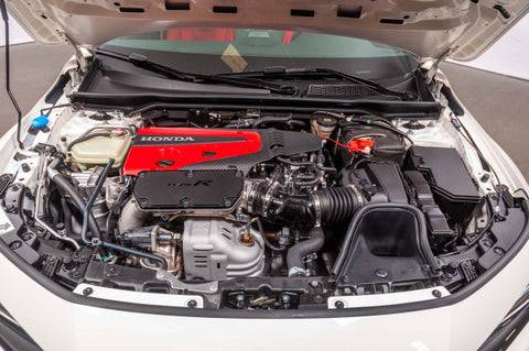

At a first glance, the FL5 engine bay and turbocharger design appears to be very similar. We have already confirmed that our P700 Drop-In Turbocharger bolts directly onto the 2023 K20C1 engine, meaning that any FK8-style turbocharger can be fitted. However, upon closer inspection we can see that the factory FL5 turbocharger's design is quite different than the factory FK8 turbocharger in terms of wheels/aero.
2023+ Honda Civic Type-R Turbocharger Part Number 18900-66V-A01
2017-2021 Honda Civic Type-R Turbocharger Part Number 18900-5BF-A01
