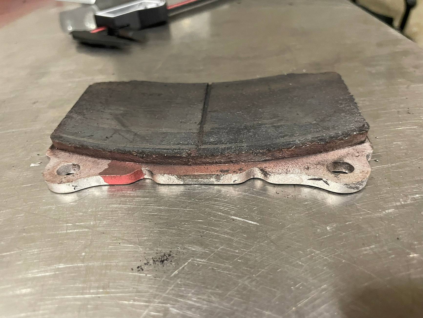

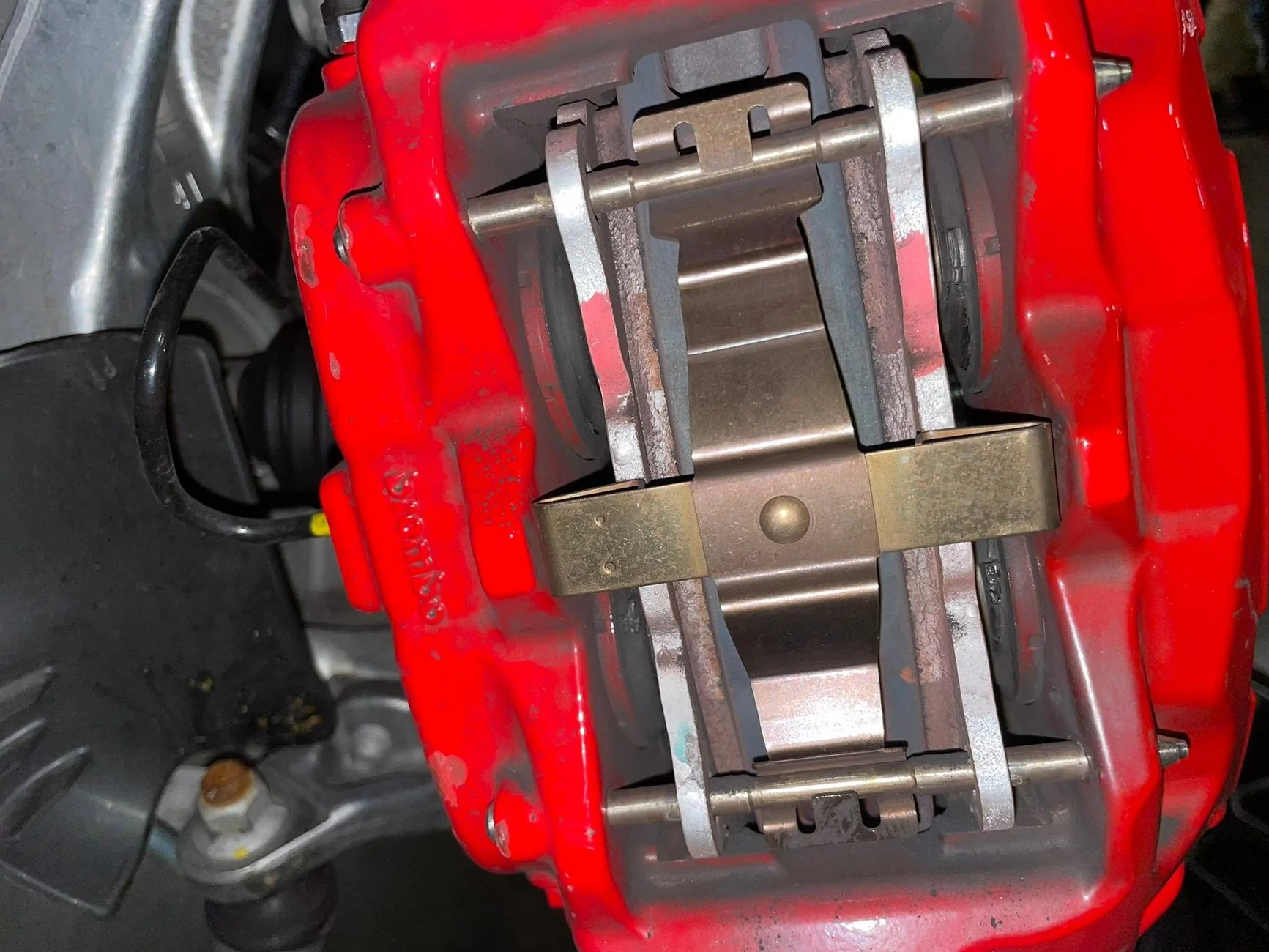

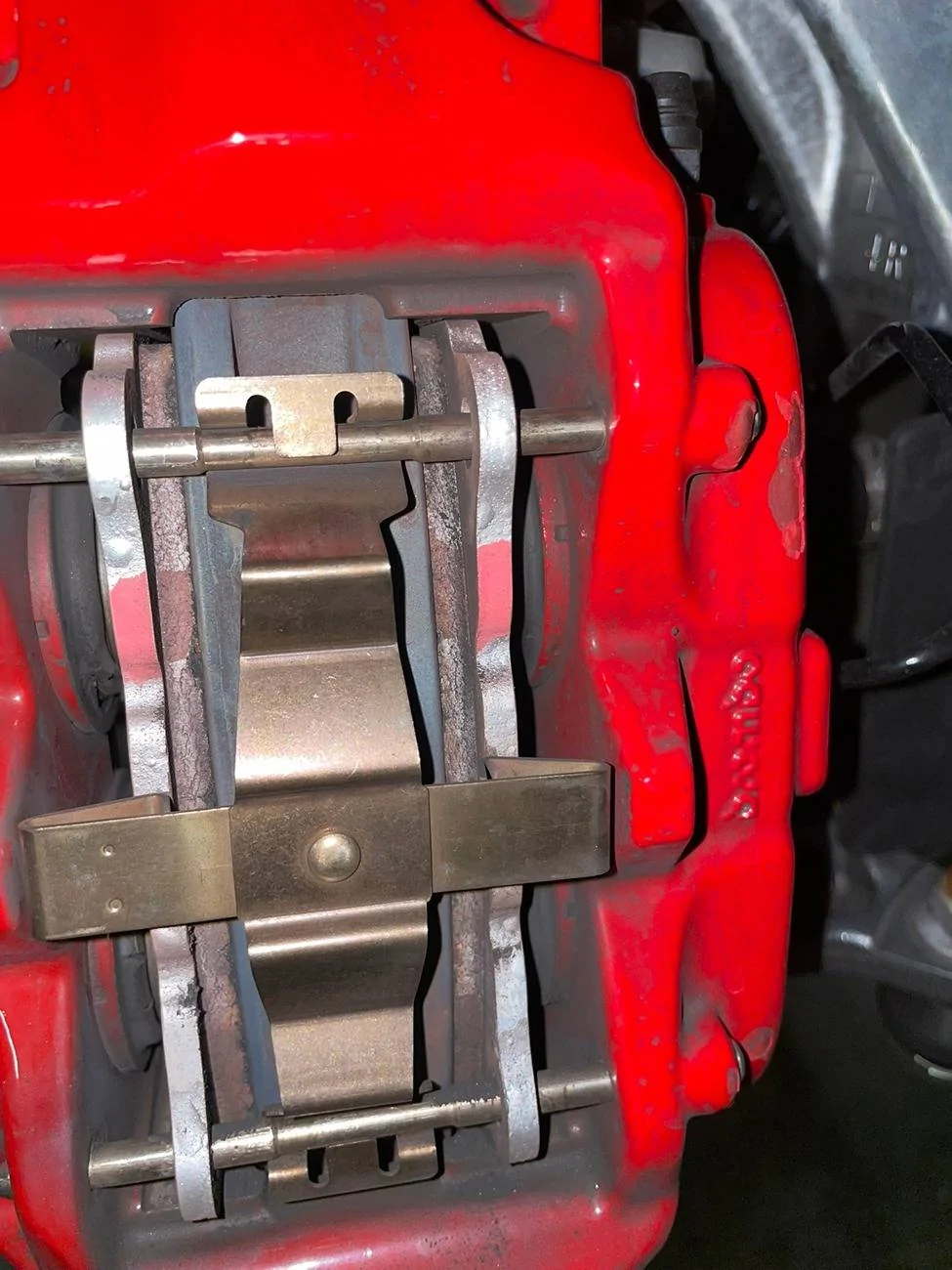

PADS - Counterspace Garage (CSG Spec)
Every CSG compound tested performed incredible, without fade over the course of a session -- even the "Street" compound, the CP. Excellent modulation and release, and the complete opposite of the On/Off switch that plagues so many other pads.
The C1X is the newest compound for the FL5, and I have been on it, both on track and street driving, since GTA in August 2024 -- and it's ABSOLUTELY my new favorite.
  • Laps: 182 at Ridge
  • Track Days: 8 Track Days
  • Track Sessions: 30 on-track sessions
  • Street Miles: 1000+
After all of that, every pad, from every angle (Outer/Inner/Top/Bottom) still had over 5.0mm of pad life remaining. Given the pad has a 5.0mm backing plate, and comes with ~10.mm of a pad material, there's still quite a bit of life left, since we have only used 50% of the material. Will I go down to sub 2mm, likely not intentionally, but 10 Track Days with 225 Laps on C1X looks promising, and an excellent value.
C1X Measurements Taken on 11/30:
  • Passenger Outside
    • 11.2 - 11.6 - 12.3 (Top to Bot - IN)
    • 10.1 - 10.5 - 11.4 (Top to Bot - OUT)
  • Passenger Inside
    • 10.6 - 10.6 - 10.7 (Top to Bot - IN)
    • 10.2 - 10.2 - 10.4 (Top to Bot - OUT)
  • Driver Outside
    • 11.1 - 11.6 - 12.1 (Top to Bot - IN)
    • 10.0 - 10.4 - 11.1 (Top to Bot - OUT)
  • Driver Inside
    • 10.7 - 10.7 - 11.0 (Top to Bot - IN)
    • 10.1 - 10.2 - 10.5 (Top to Bot - OUT)
**Note -- I rotated the pads back in September about 33% through this use to balance taper. I swapped Driver Outside to Passenger Inside and Driver Inside to Passenger Outside.

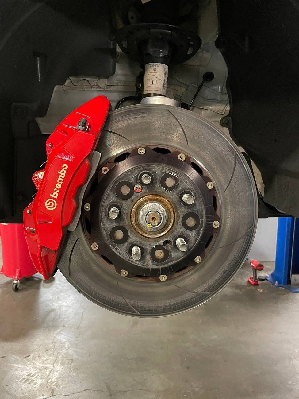

ROTORS - GIRODISC
Girodisc Rotors -- Front and Rear. They were put on in February, and the same set have been on the car ALL SEASON. That's:
  • 21 Track Days
  • 532 Laps
  • 1307 Miles on Track
  • 4000+ Street Miles

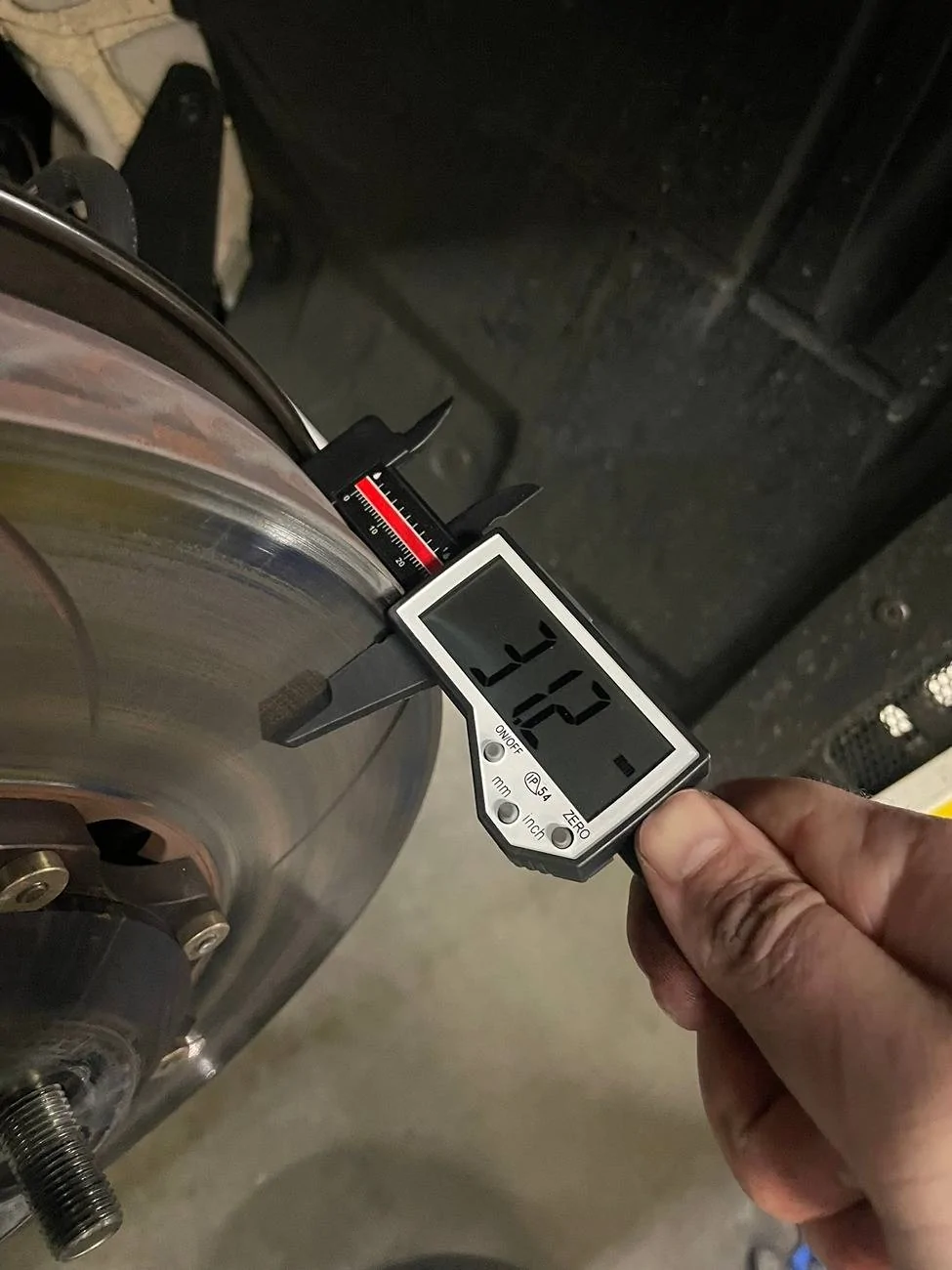

Measurements
  • Front - 31.2mm (Min Thickness is 30.0) (New is 32.25 - per photos I've seen)
  • Rear - 10.6mm (Min Thickness is 9.0)
That's an incredible wear rate and value for how much use they had all year.
So that's it -- long season -- lot of driving on track, lots of ferry rides/driving to and from the track, some new hardware to show off, and discovered what can easily be a full season pad and multi-season rotor for many, or a half season pad + full season rotor for a power user.
****Sad Note -- I now have a bit of red bleed on my "Brembo" lettering thanks to a friend who drove my car for one session. If it wasn't for that, they would still be perfectly white!!

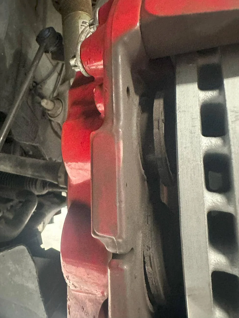

Great write up!
looks like you'll need some dust boots. Wonder if the Racing brake high temp ones will hold up. Some say they work and others don't

They will be fine for a bit. My A90 boots were way worse after 3+ years. I'll likely rebuild a fresh set with Girodisc's kit at some point.

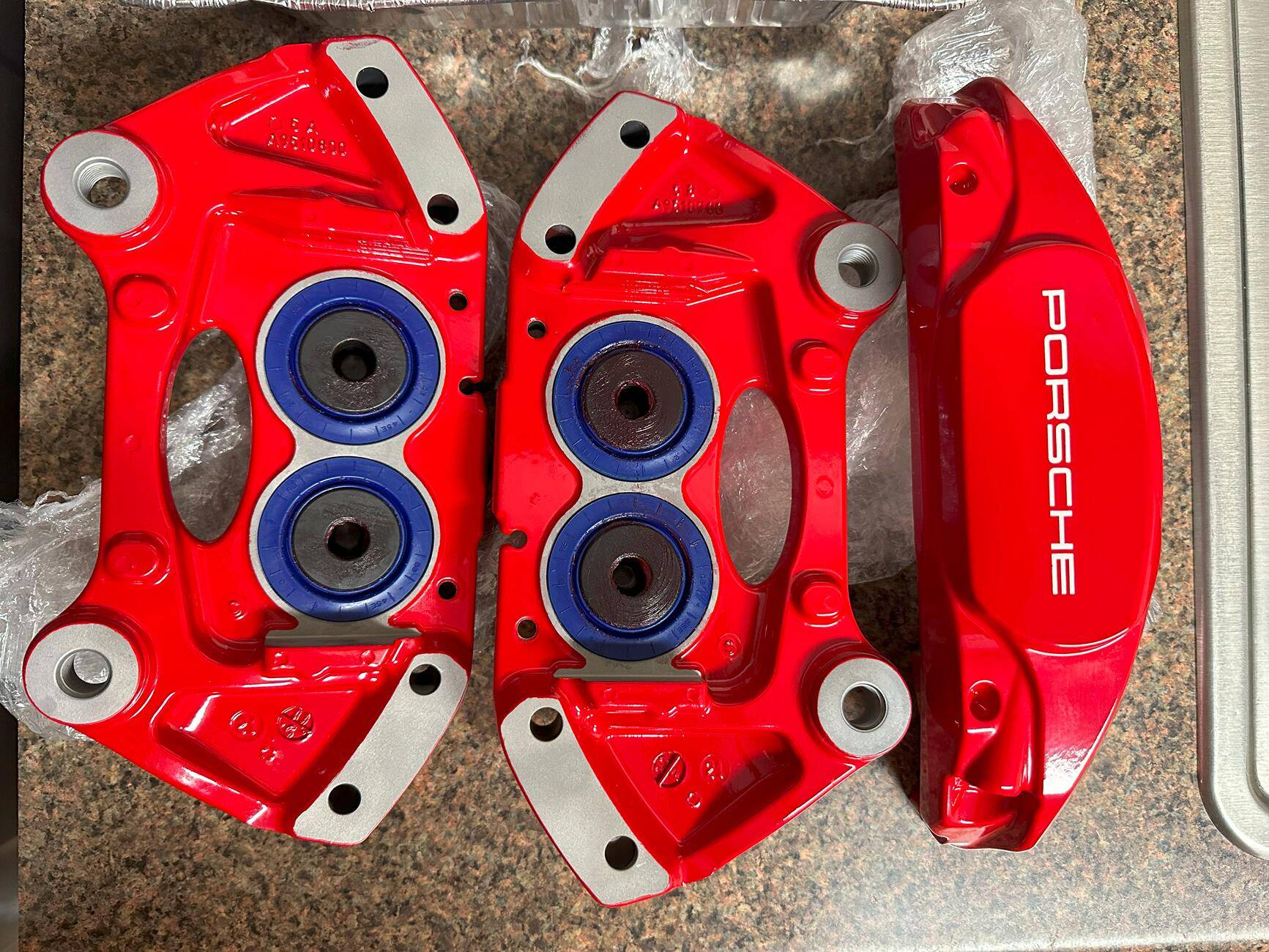

Long time lurker, first time posting.
Firstly to OP: very informational, thank you!
Regarding the Racing Brake higher temp rated dust boots: have not used them on the FL5, but coming from a MK7 GTI that had Porsche Macan 4 piston Brembo front calipers (which took the same 1001 pad pattern), they did not do well in my experience.
11th Gen Honda Civic 2024 Season: Brake Hardware Recap Macan
11th Gen Honda Civic 2024 Season: Brake Hardware Recap Dust Boots
Pictures show new vs after ~7 track days. Unfortunately only took pictures of one side, but I recall having one boot so torn with a good chunk hanging, I had to rip part of it off before replacing pads.
At this time I was mostly at a novice level, moving into intermediate later that season, so some of the wear could be attributed to dragging the brakes and overall poor braking habits at the start. Looking at their site later, I found out that they put out a disclaimer that they do not recommend using any grease and avoiding contact with brake fluid which I find a little absurd (and did not see at the time of ordering).
One of my track instructors with a faster car and similar brake setup was also going through boots seasonally. He tried a brand called BCB and had better luck with it this season with no rips or signs of scorching. It appears they are a small China based operation where you can buy directly through facebook/instagram as per their YouTube channel. Not sure if they sell the exact size for the FL5, but I hope the GiroDisc ones last a while as they are a trusted name.
On the GTI, I installed the higher temp Racing Brake boots when the calipers were brand new, as I disassembled them for powder coating. Ran with Hawk DTC-60 (and HPS 5.0 pads in a pinch), with Neuspeed titanium shims on OE 340mm blank rotors with Techna Fit stainless lines, Castrol SRF and Audi RS3 brake air ducts.

Hey! I too come from the MK7/7.5 world having a manual MK7 GTI Sport, then a DSG IS38 GTI, then a 7.5 Golf R 'Stage 2' FBO with Bilstein coilovers, all the bushings replaced, etc.
I had the Macan calipers, but never worked out for me. The pad knockback and feel was not for me. I ended up just getting a Stoptech ST-60 6 Piston kit and that was amazing. Probably the best mod for the car outside the coilovers.
I haven't really put this car through its paces like the Golf R, so hopefully the calipers will work better on this platform. I did see that Racing Brake said no grease, so I guess the jury is still out if they actually work, but the other company you mentioned might be worth a try.

To be fair to paragon too think and they will be a pain to put on when the pad is new, its arleady pretty tight in there iirc

the pragon shims are definitely very thin but they have to help some? I wonder if there is some data on this because that could make a huge difference on longevity of the boots..
I was reading somewhere that stainless steel actually can handle heat better than titanium, it has higher thermal conductivity, not by a lot but its there
I'm sure they may help on certain pads that are not focused on thermal efficiency and bleed a ton of heat into the calipers. But if the data shows it's not needed for all, that's money better spent elsewhere, than adding another factor into the equation.
