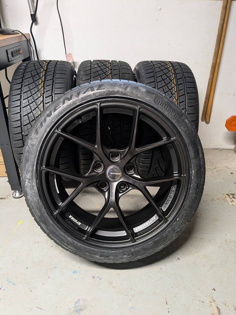

us17094
Mar 26, 2024
42
35
Tenny
Accord 2.0T 6 speed
^^ Yep, i've had the old Continental Extremecontact DWS (non-plus) as a winter setup for my BMW M2 and it was perfect for non-snow, but cold [occasional rain] climates.
I just ordered a set of 18" wheels with 265/35 DWS 06 Plus from TireRack (taking advantage of their $110 rebate).
Also i'd get 18" wheels, more sidewall, a lot more tire options, and cheaper too.
This is exactly what I am doing - following suggestions posted in other threads. Tires were mounted to my 18s this week and will have them installed towards the end of this month. I live in East Tennessee (very infrequent snow but cold temps) so the Contis should do the trick.
