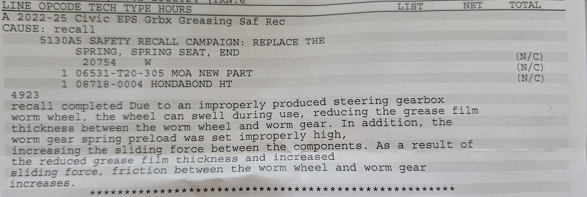

I think I am starting to experience the issue. On small adjustments to the steering wheel feels like the wheels slide as opposed to a smooth turn. Hasn't felt difficult to turn the wheel more lacking a smoothness to the turning on small adjustments. I reached out to my service dept to see if they have done any repairs yet. I can wait it out a bit until the techs get more experience with this repair.

From what it states happens leading to it, it sounds like it's milage / usage dependent as the issue gets worse until it shows itself.
talked to my dealer. they have a wait list. So I will wait until after the holidays. Probably so chaotic at the moment.

What I do not understand is why they are not replacing the defective "improperly produced" worm wheel. apparently it was not properly annealed.
