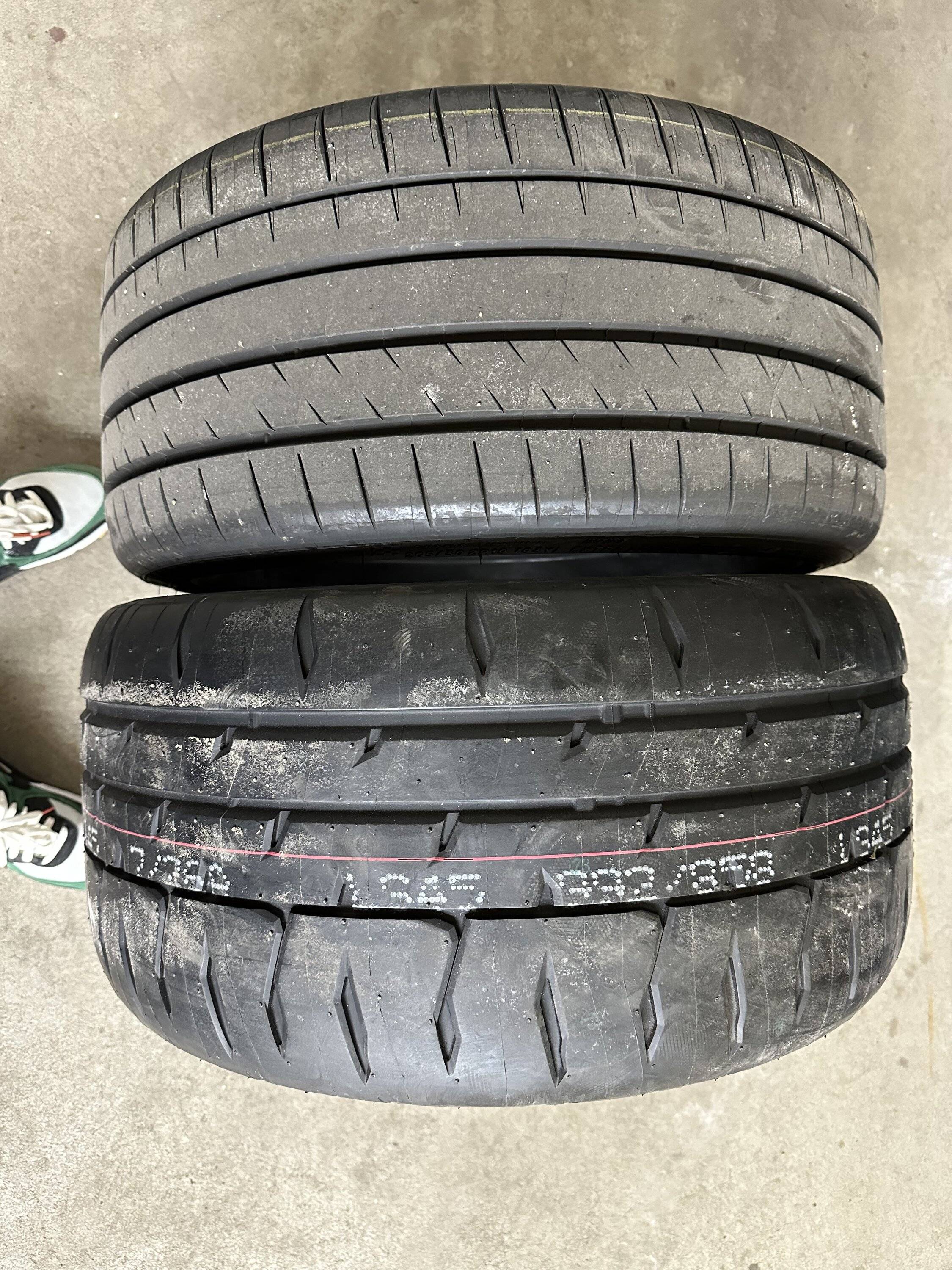

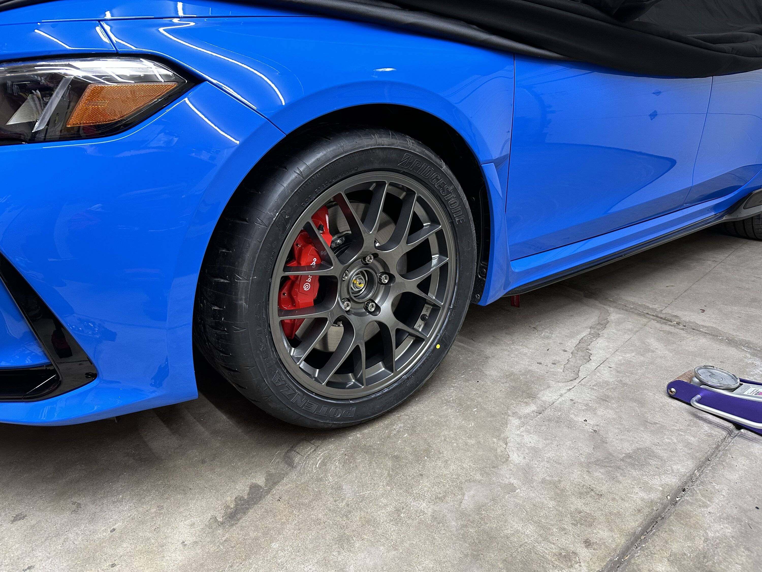

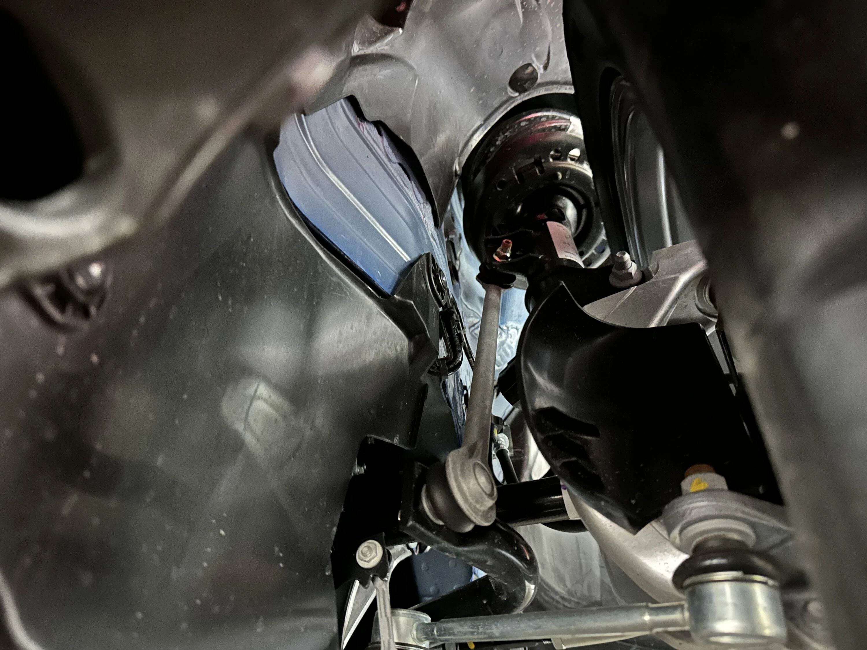

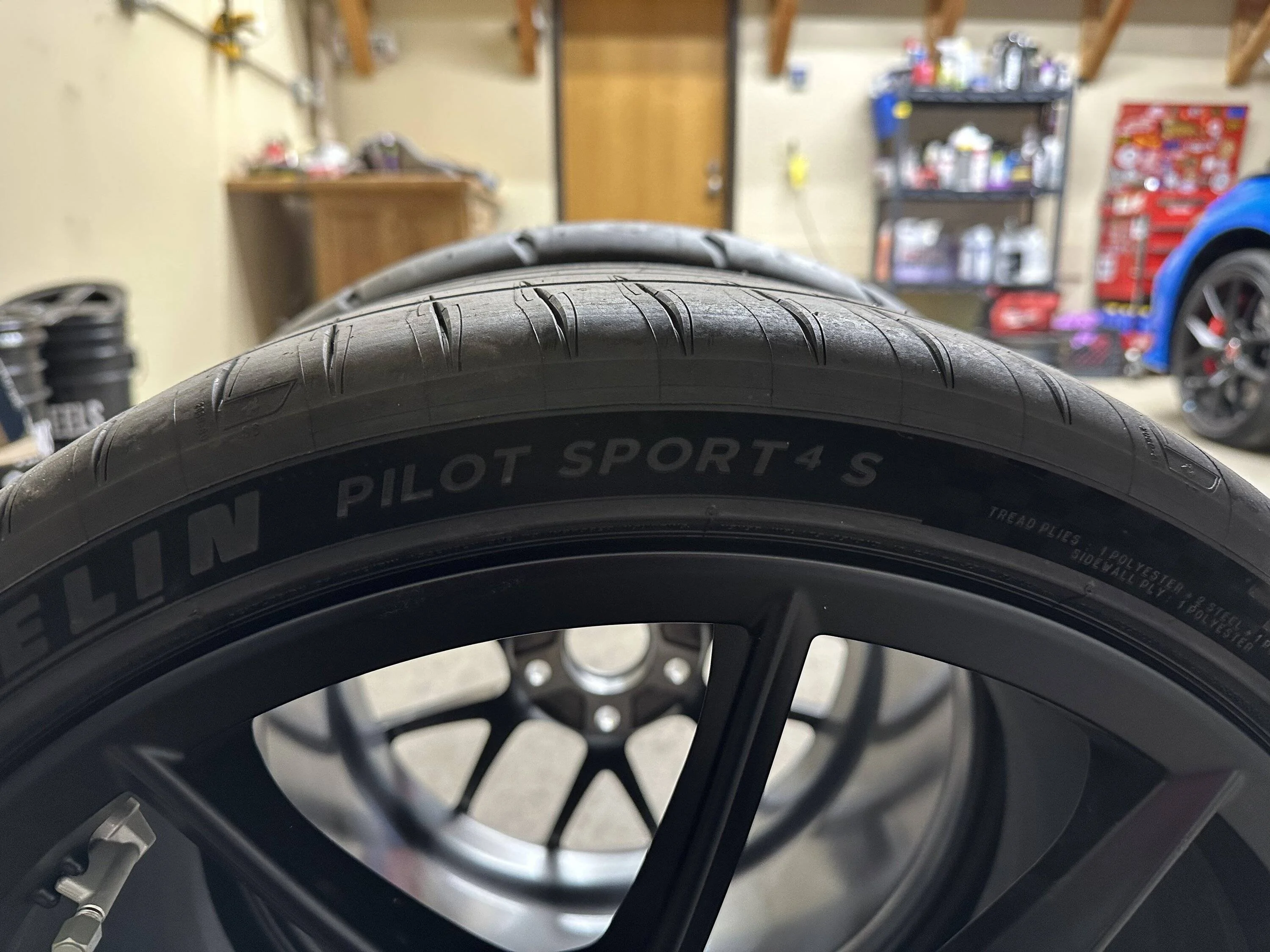

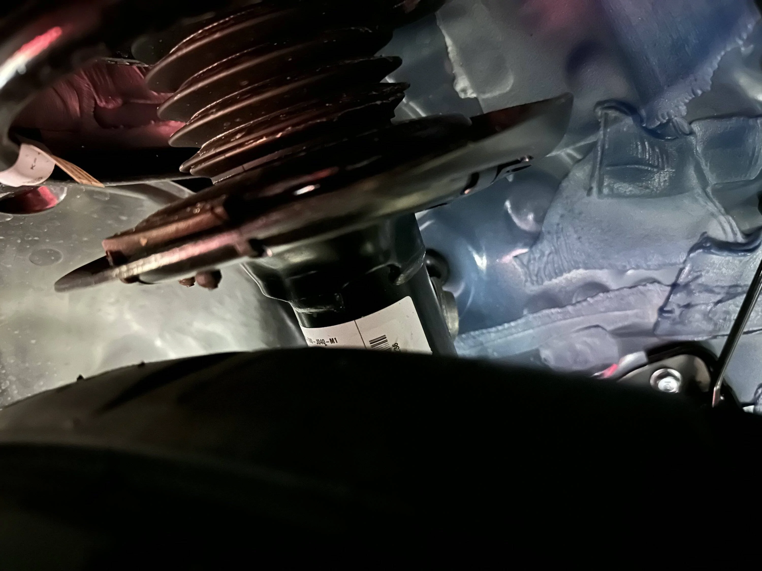

Well they fit. And probably have room for 305s as well lol.
I purchased one of these tires just to test fit. Mainly I wanted to test this set cause it taller than the oe 265/30 and that 3.4% could help from having to constantly row gears. I don’t think I’ll personally try a 305 as the ballooning on this tire is more than I’d like to see for responsiveness. Not sure if I’ll buy 3 more yet or just run my 285/30 I purchased earlier.

That 58 offset helping you fit the wide of a tire probably?

I didn’t drive on them. Only purchased one tire. Tested it on the front and rear. Loaded the suspension with a jack just to make sure.
These are only for AutoX. They won’t see much street driving.

Yeah they are a 58 iffset. Stock is 60 so you can go even lower. Ideally 55

What lug nuts are those?
They are titanium lugs from katech. Brought them over from my Camaro since it’s the same stud size.
