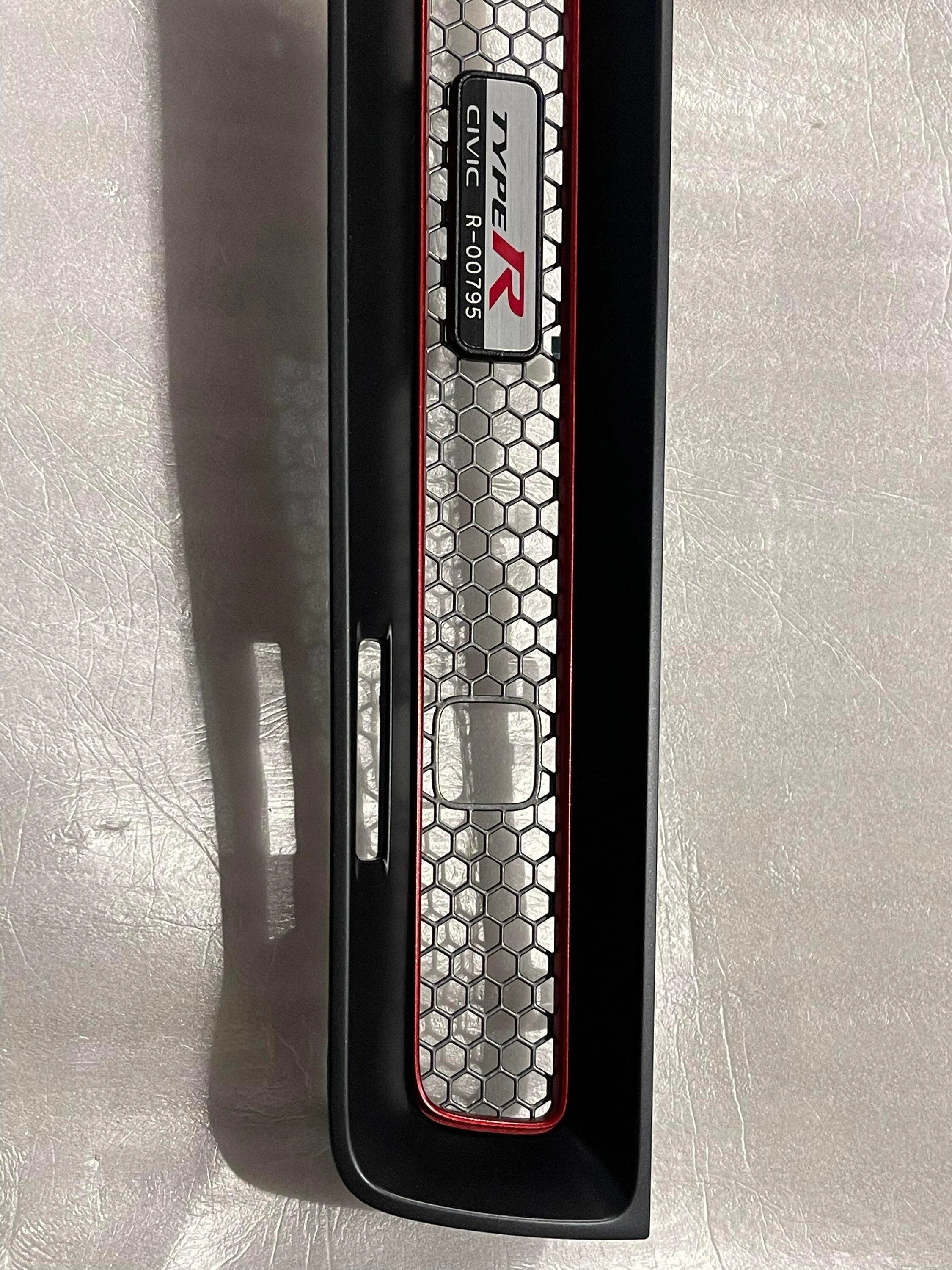

Ok I have been wanting to do this for a while since I think that the FL5 and Si got some parts mixed up as far as the interior trim accents go ( at least IMO :wave: )
So I liked the fact the when the FL5 was introduced that they went away from the gloss trim that was around the A/C vents and went to a more Matte/ Satin finish… but where I thought they kind of cheaper out was with the silver trim that was on all the base models accept for the Si… the Si had the nice red anodized finish like the FK8 had…. So after looking through the Si parts list I found the items needed to make the switch of a “few” parts to get the desired look I wanted for my car.
Here is a sneak picture of what the two cars combined parts look like together…
I will update this post in a few days once the larger center section is finished….
One thing to note that this is a total PITA to do… :banghead:

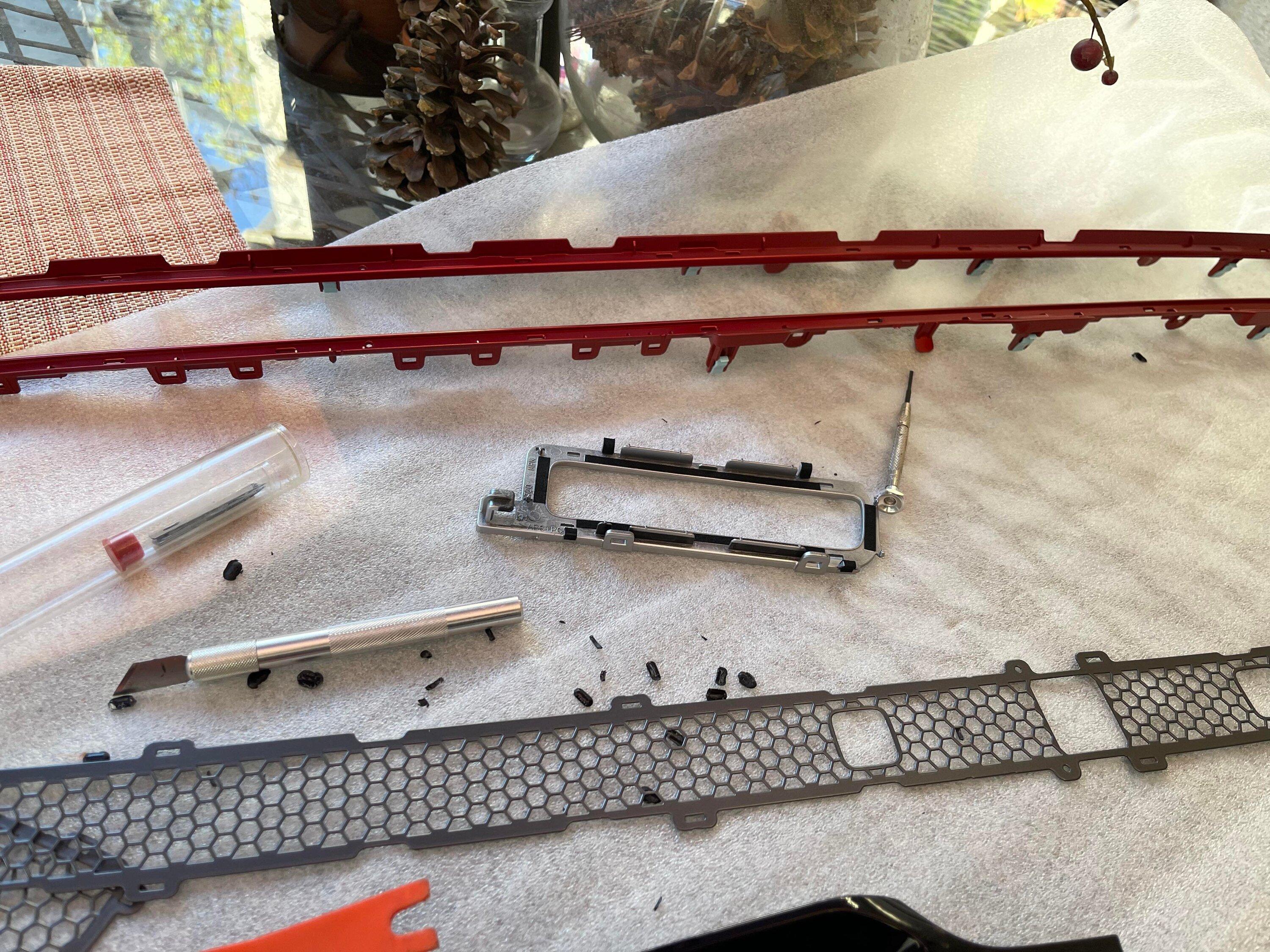

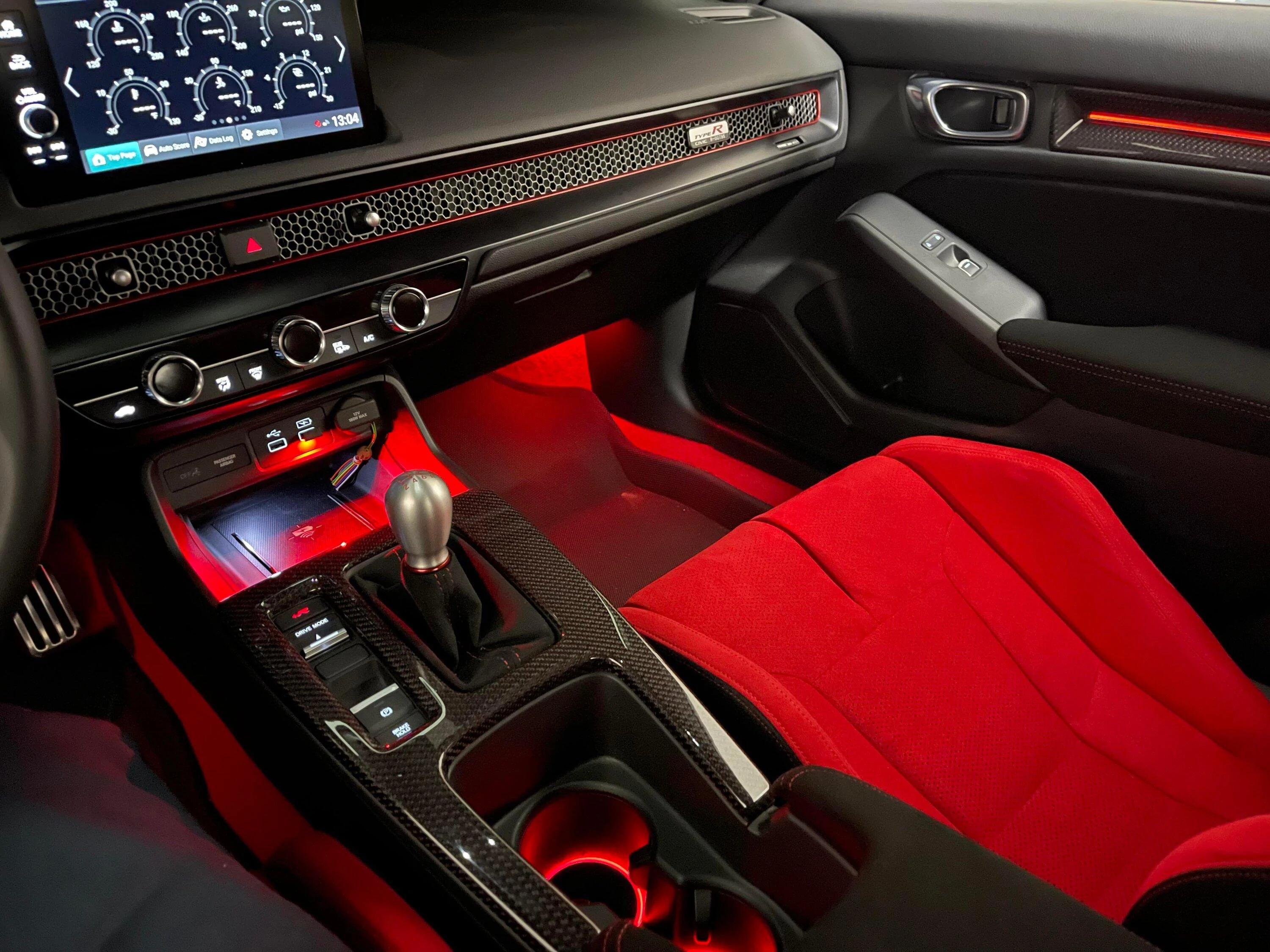

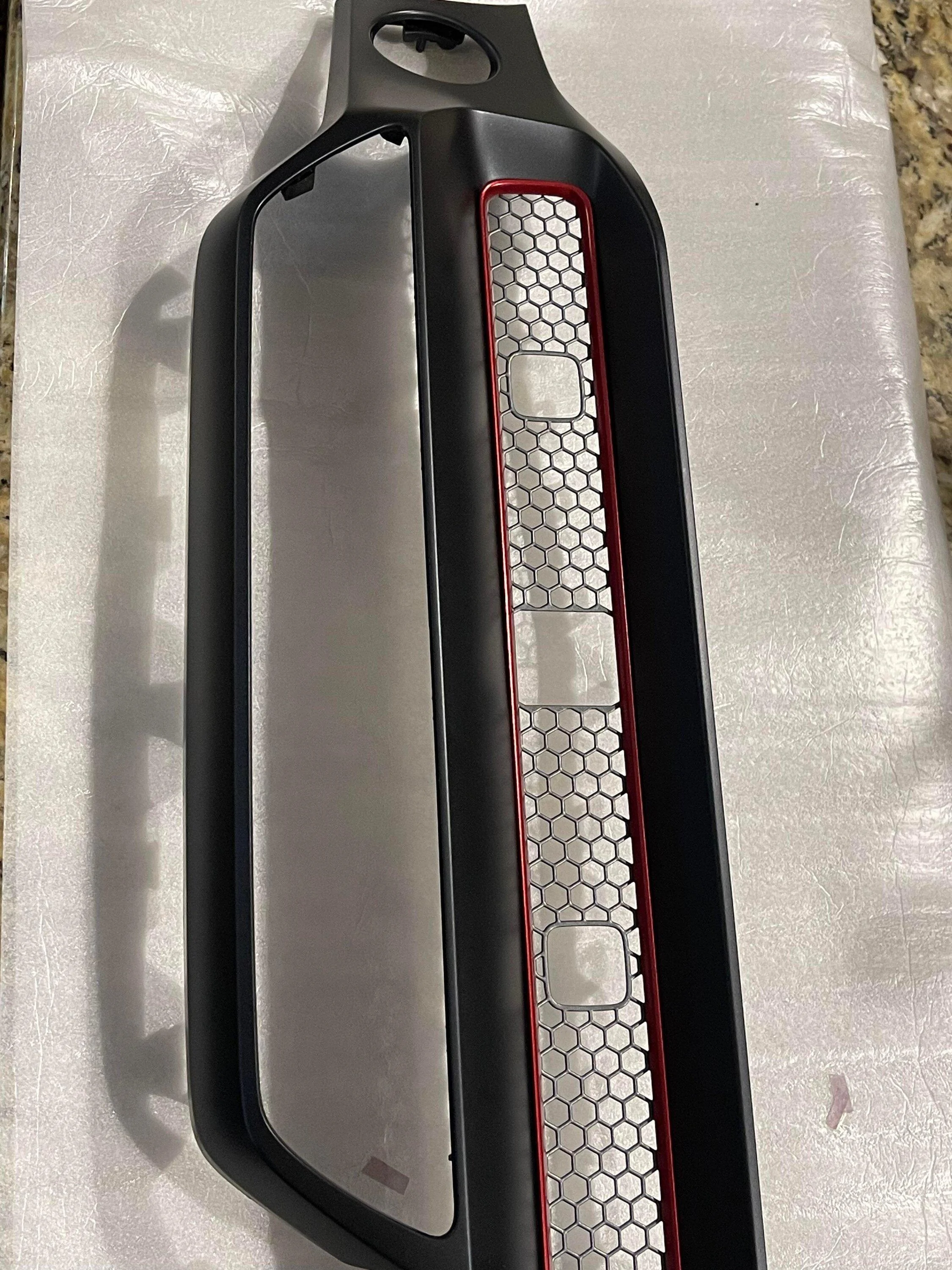

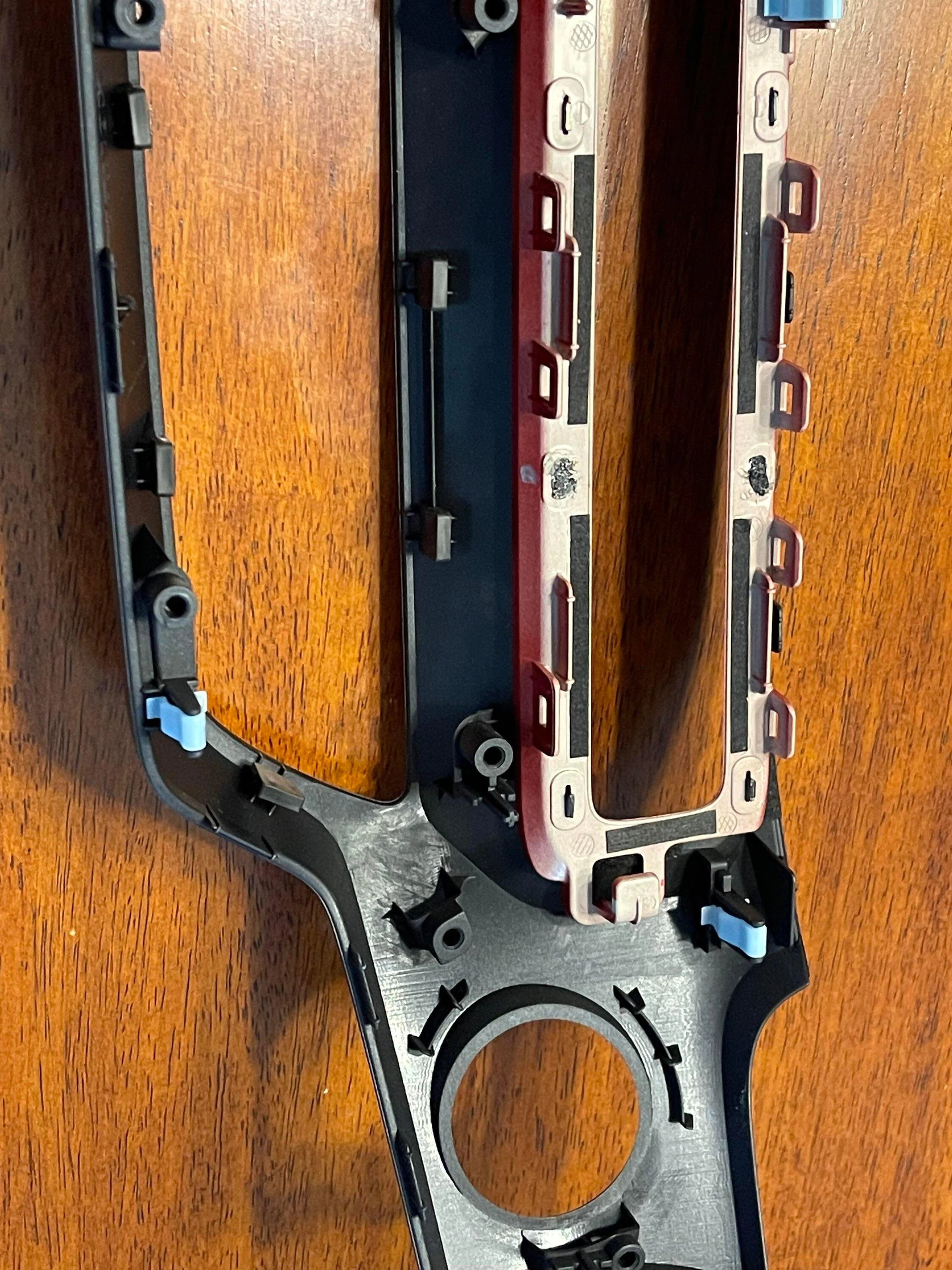

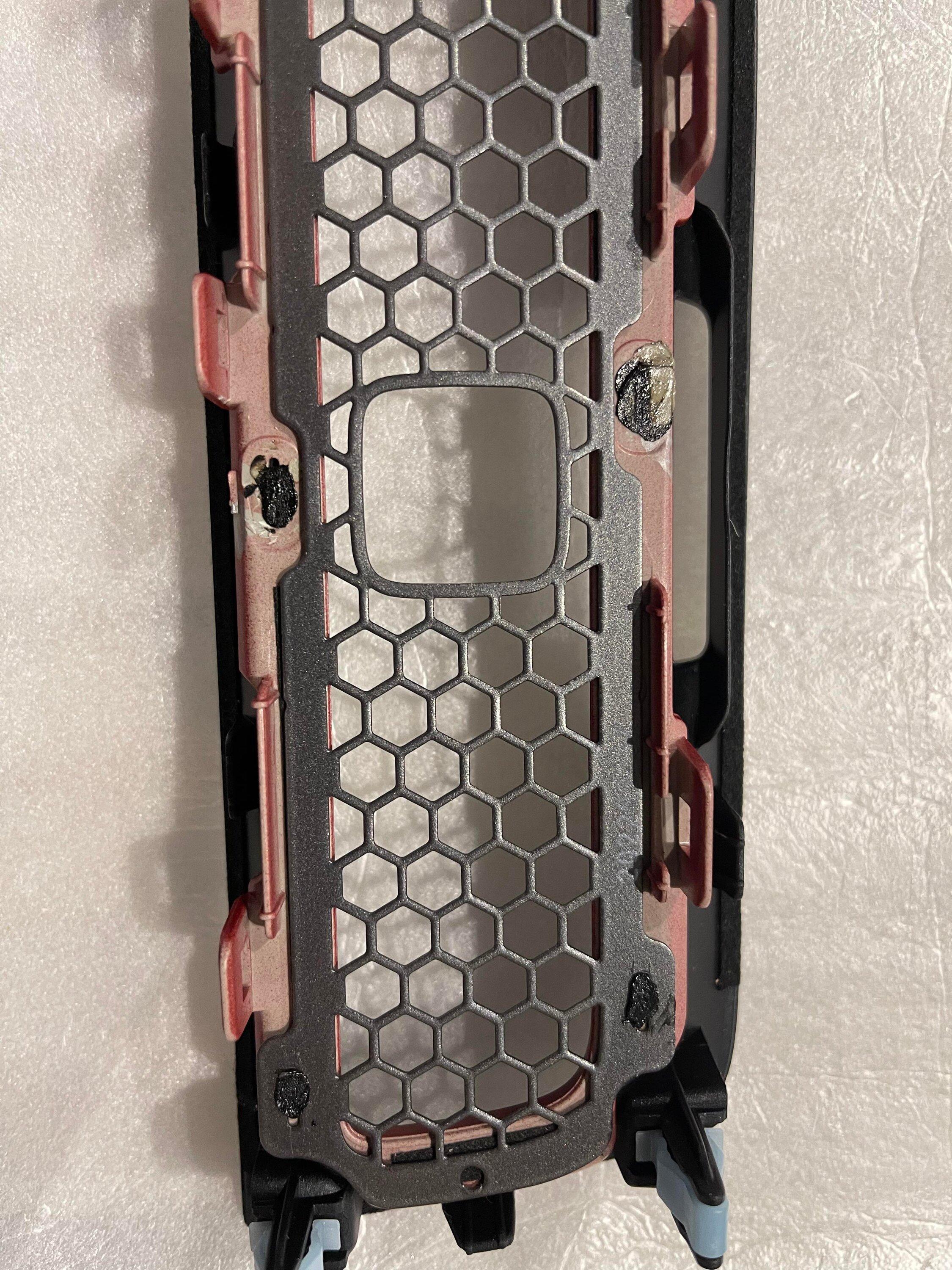

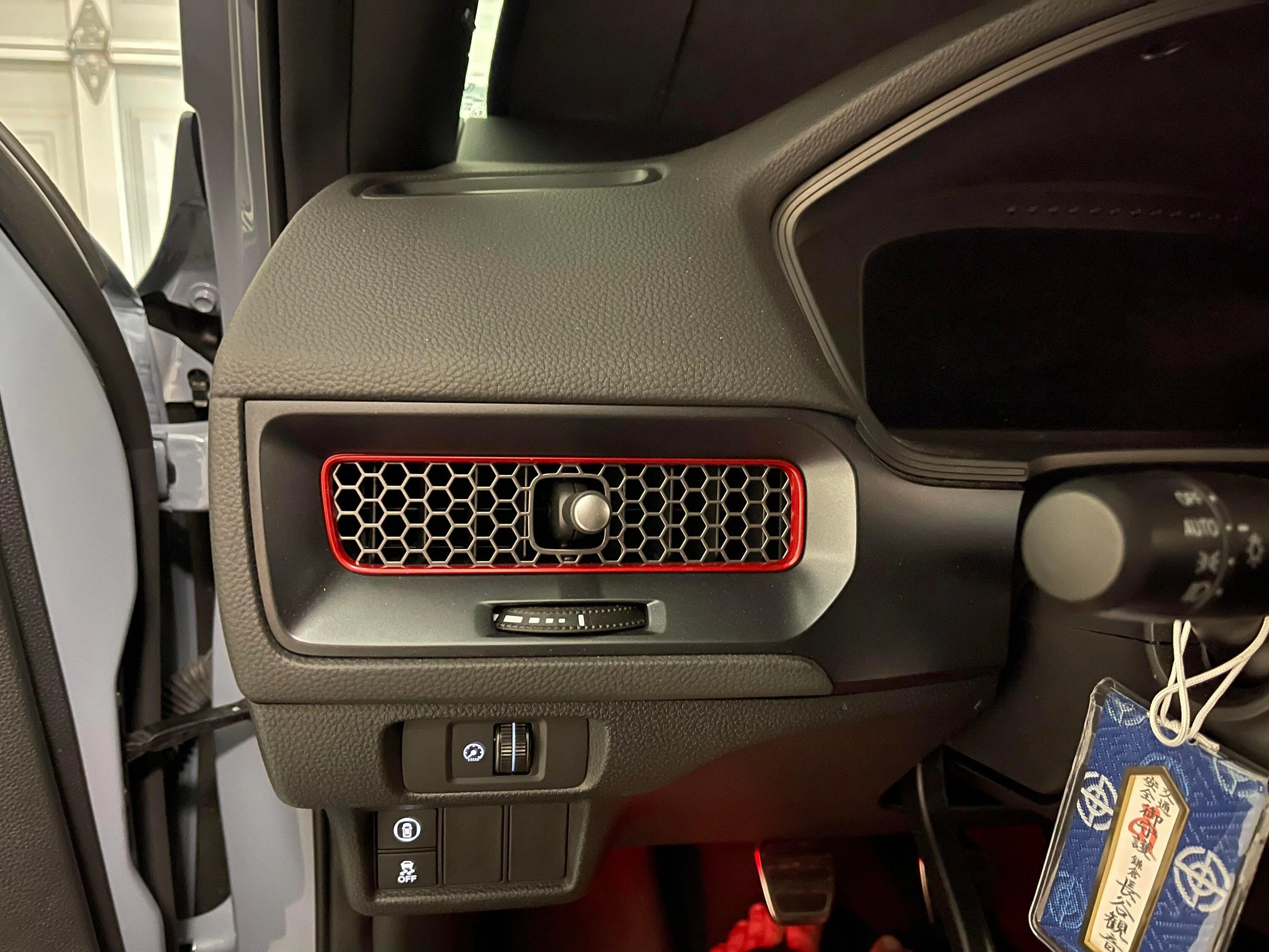

Alright ... finally finished this was the most nerve racking thing to perform that I have done in a while... I "highly" suggest if you don't have the patients, time and mechanical skills to to tackle this job "don't" try it your self :crazy:
Now the upside of doing this is that it totally adds to what the dash was missing in my opinion a little character, now I have notices that a few people have swapped over the Si full piece into the FL5 but the gloss black really clashes and I liked the satin/flat look of the OEM FL5 trim.
So here are the final pictures of it installed and what some of the back sides of the parts look like after the modes were completed.:coffee:

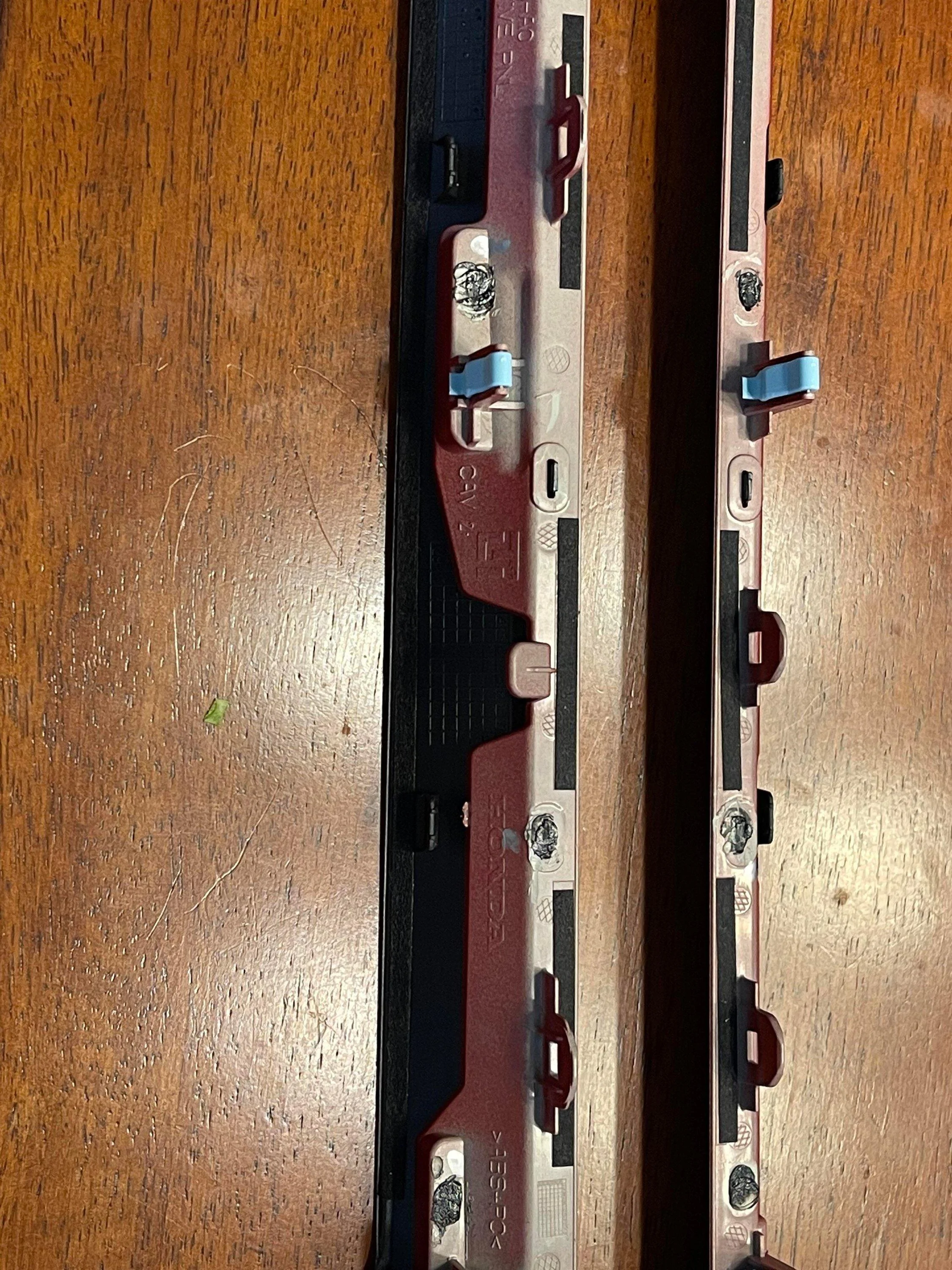

Looks great! I'm trying to track down some rattle noise. I think its coming from the ac vent trim on the left of the steering wheel. How did you remove the trims without scratching the dashboard? Did you have an instruction manual?
Thanks.
As far as the trim removal I taped up the area around the dash and trim panel itself, then used a microfiber towel with a panel pry tool these panels come off pretty easy but the main A/C panel is secured very well with clips and takes a good bit off effort to remove .. just take your time and prep the panels well and you should not have any issues with scratching them:thumbsup:

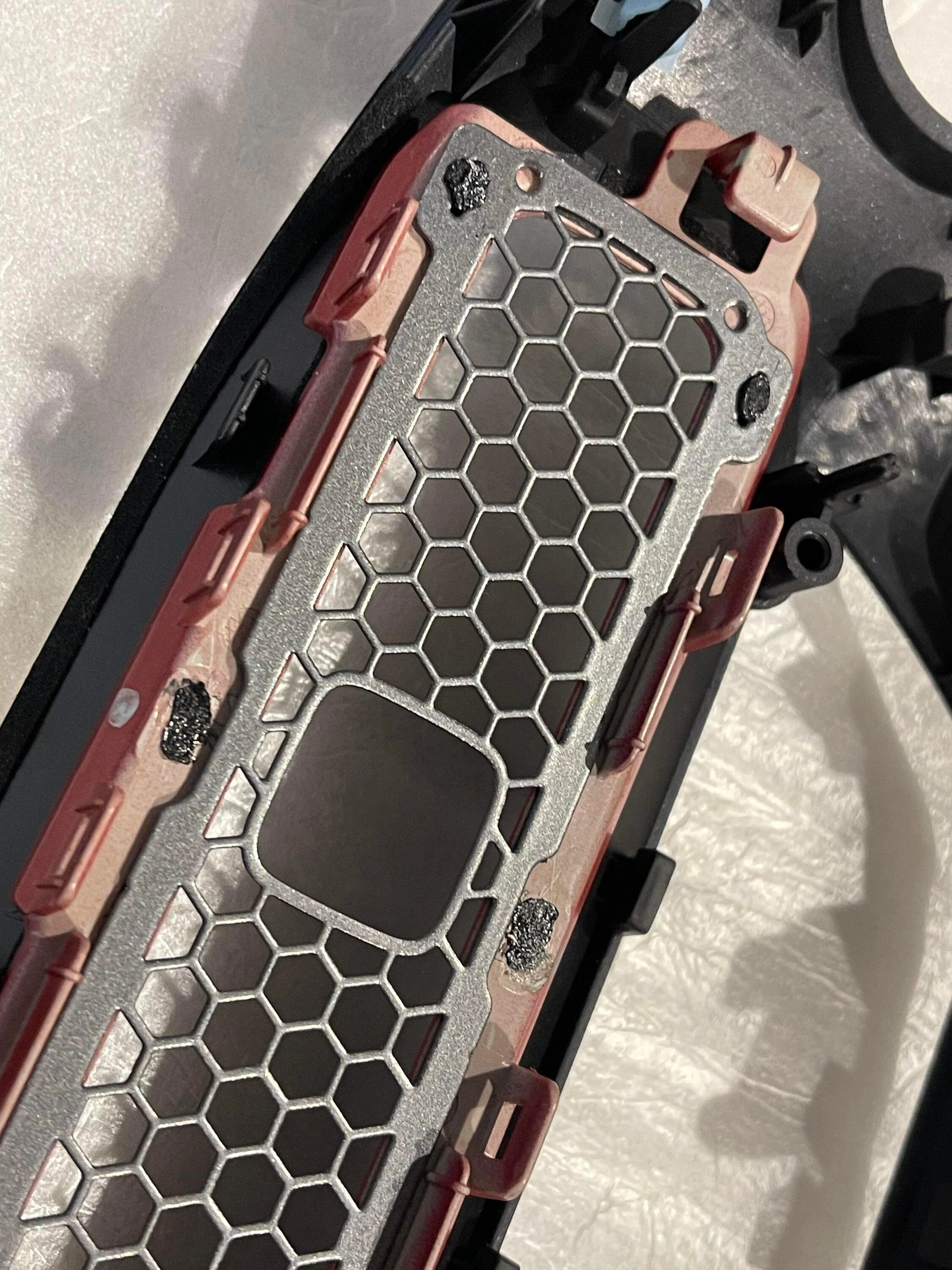

Looks like you had to do some plastic soldering there so this isn't going to be for everyone - props to going forward on this mod.
Should look like this stock - killer results man.

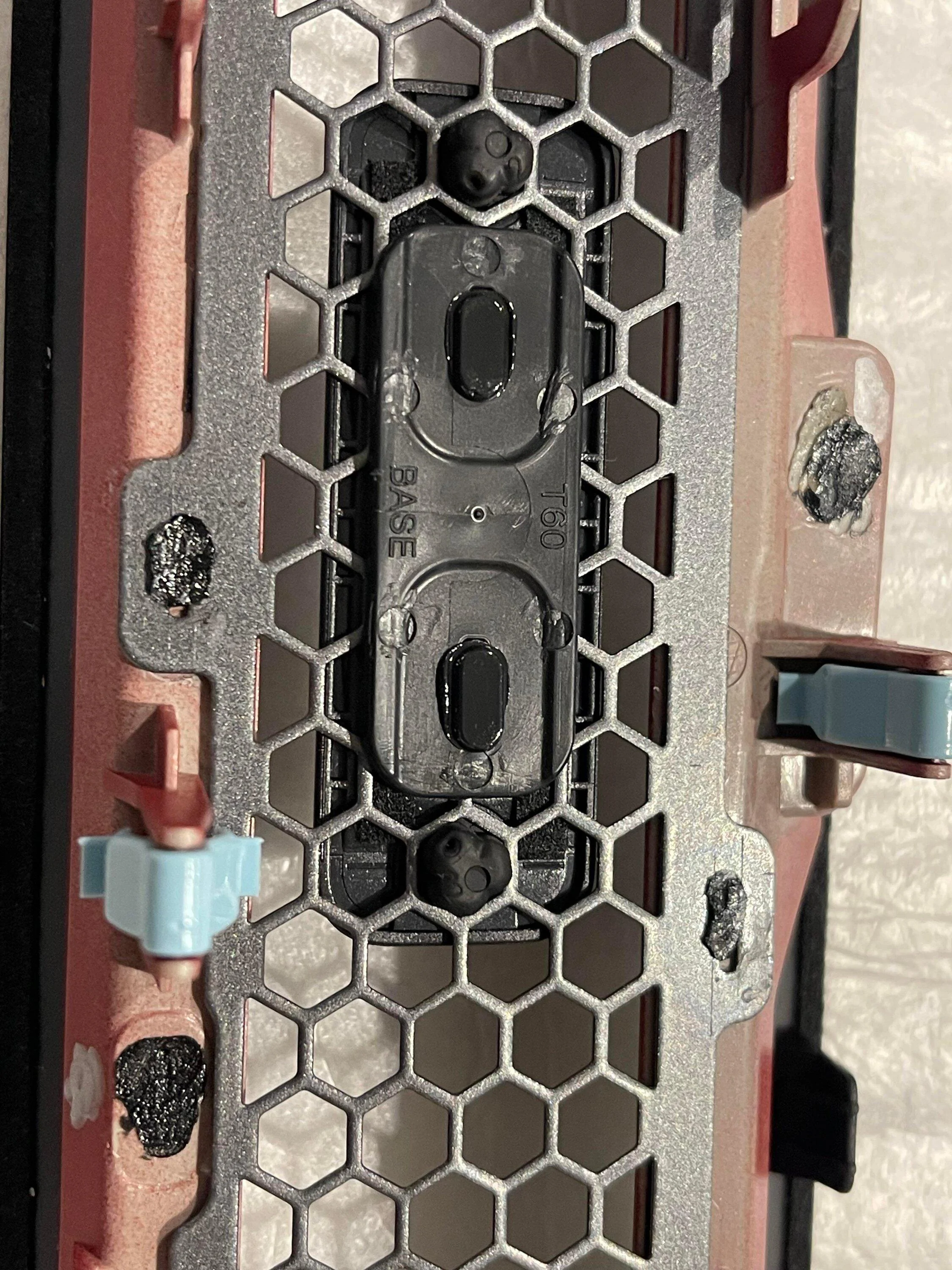

Yes plastic soldering was needed for 29 tabs:confused1: ….. was very nerve racking cutting the original tabs off so that I could leave enough back on them to melt the tabs again to secure the parts back on….
You can see in a picture above where the badge is what the original melted tab looked like.:banghead:
