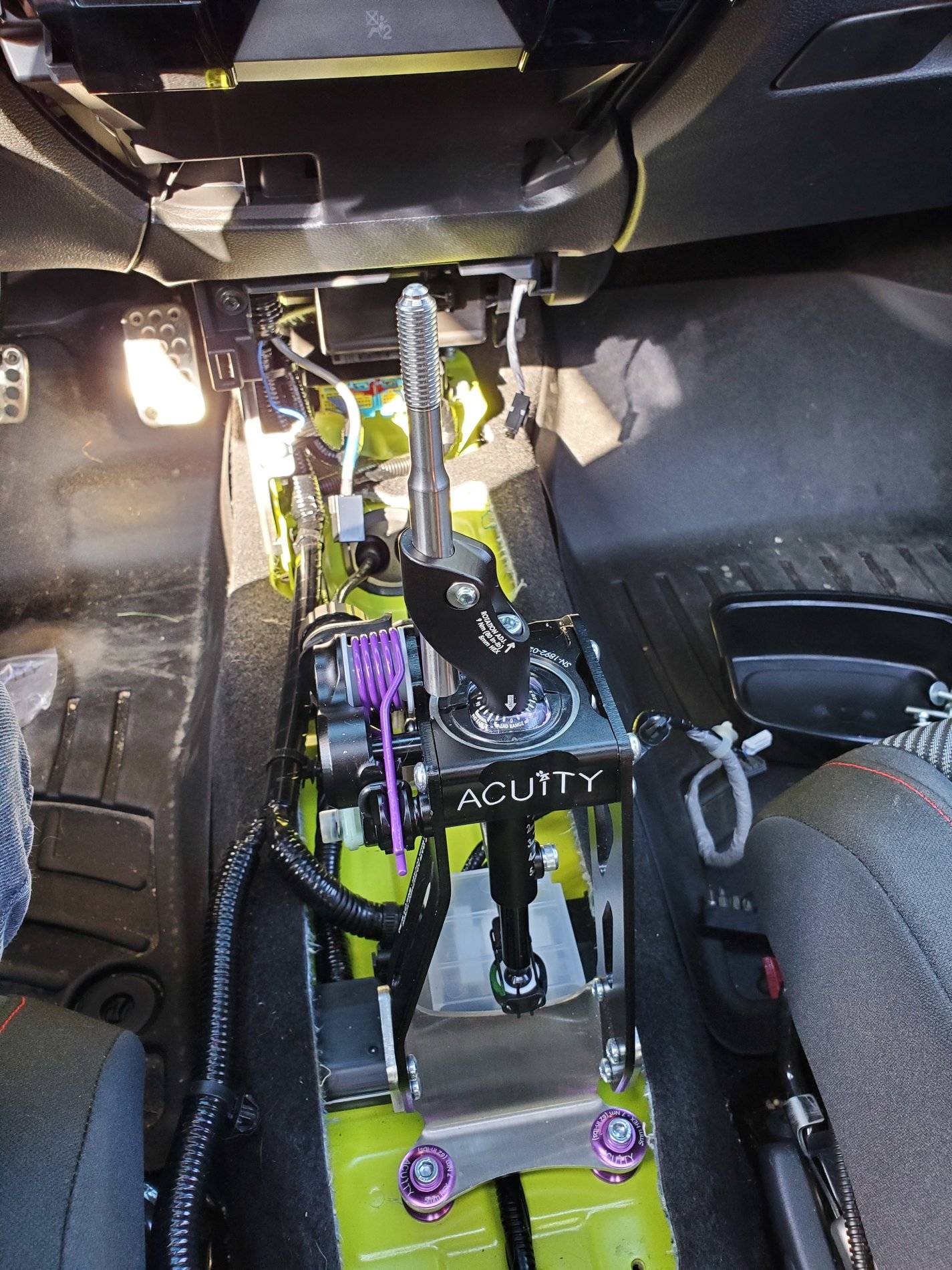

Hey so I just received my shifter kit from acuity today and I was wondering if there are any reference points to the gate and throw adjustments. It comes in a pretty neutral setting from acuity, but I don't know how much % difference those numbers mean. If anyone could shed some light as to what is most similar to stock and how far each number changed that metric I'd be super grateful. Thanks guys!

Hey Dan-O, I just replied to your original post! I have the same question as you. I just got mine on Friday and looking for a starting point. I currently set "gate" to the lowest setting, the "throw" to 5 and the "knob" height to 1. It is really tight and short, but I'm guessing it's a matter of getting used to. Then again, as of this message, I only drove it from my back yard to my front yard and only shifted to second. LOL! Hopefully we get some feedback, cheers......sincerely, R-25210

Hey! I've had mine for months now, I left my console apart for several days before I made my final decision. Just lightly clip the climate control into place and connect the parking brake, brake hold and sport (if equiped) it doesn't look too bad especially with all the shifter there! I found that having the console apart was deceiving because it felt like it was still too high. Once it was back together it was a perfect height. The height adjustment is the easiest one to access so if you have your gate and throw set. You can play with the height at a final part of reinstalling the center
I set mine as short and narrow as it would go and I have not looked back!
I will add that the height now is very close to stock as I'm running the 27WON shift knob which is taller then the stock knob. With the added weight of the knob and the short height setting the 2 go together very well.
