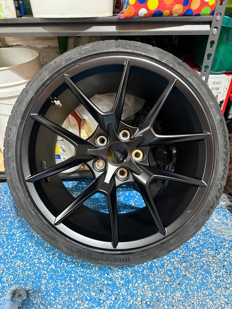

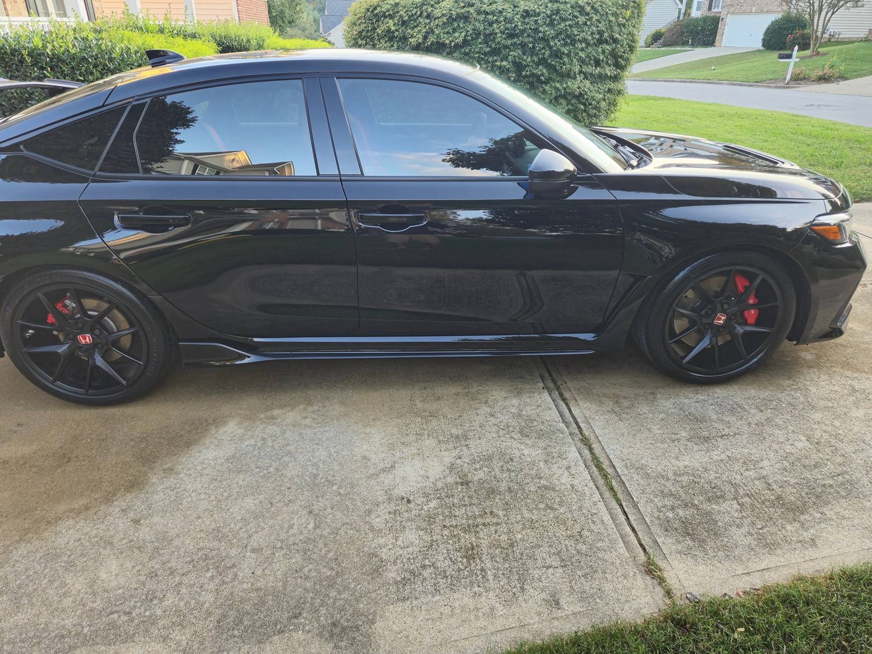

I have 275/35/19 PS4 all seasons on stock rims and stock suspension. I've got about 3000 miles on the tires so far and no issues whatsoever and the tires themselves are excellent. Only thing I don't like is the fact that it lifts the car a little higher. I'm 99% sure 15mm spacers would be no problem with this setup, but you'd need to do some research if you're lowered.

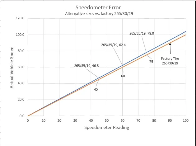

The 265/35/19 tire is "pretty close" on the speedometer, but at highway speeds (70mph) if you go 5 over the speed limit (speedo indicates 75 mph) you are actually going 8 over (78 mph) which eats into the goodwill from the guys checking your speed
The good news is if you get an @Jester04 tune he can adjust it for you to be within 1-2 mph.
