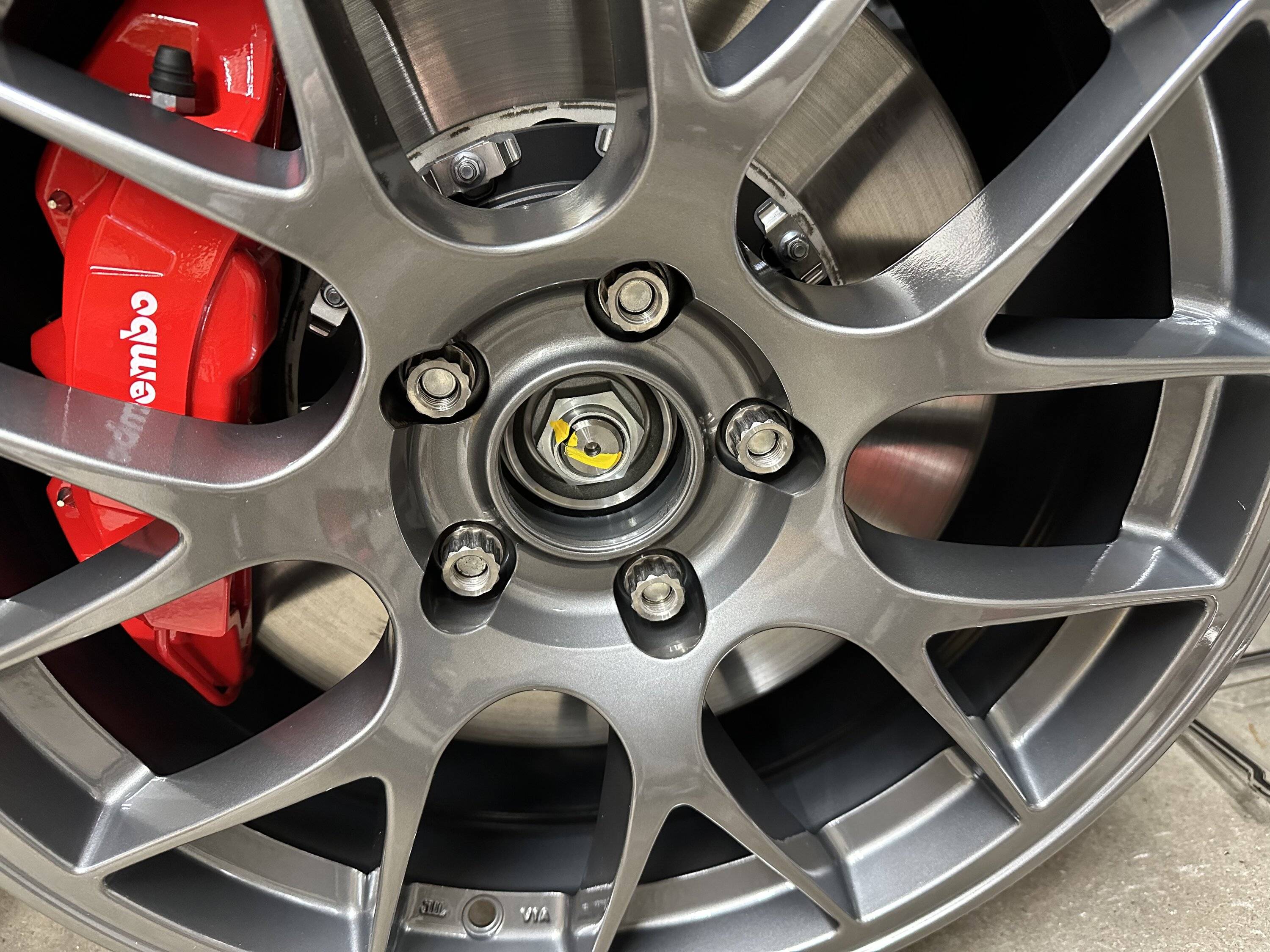

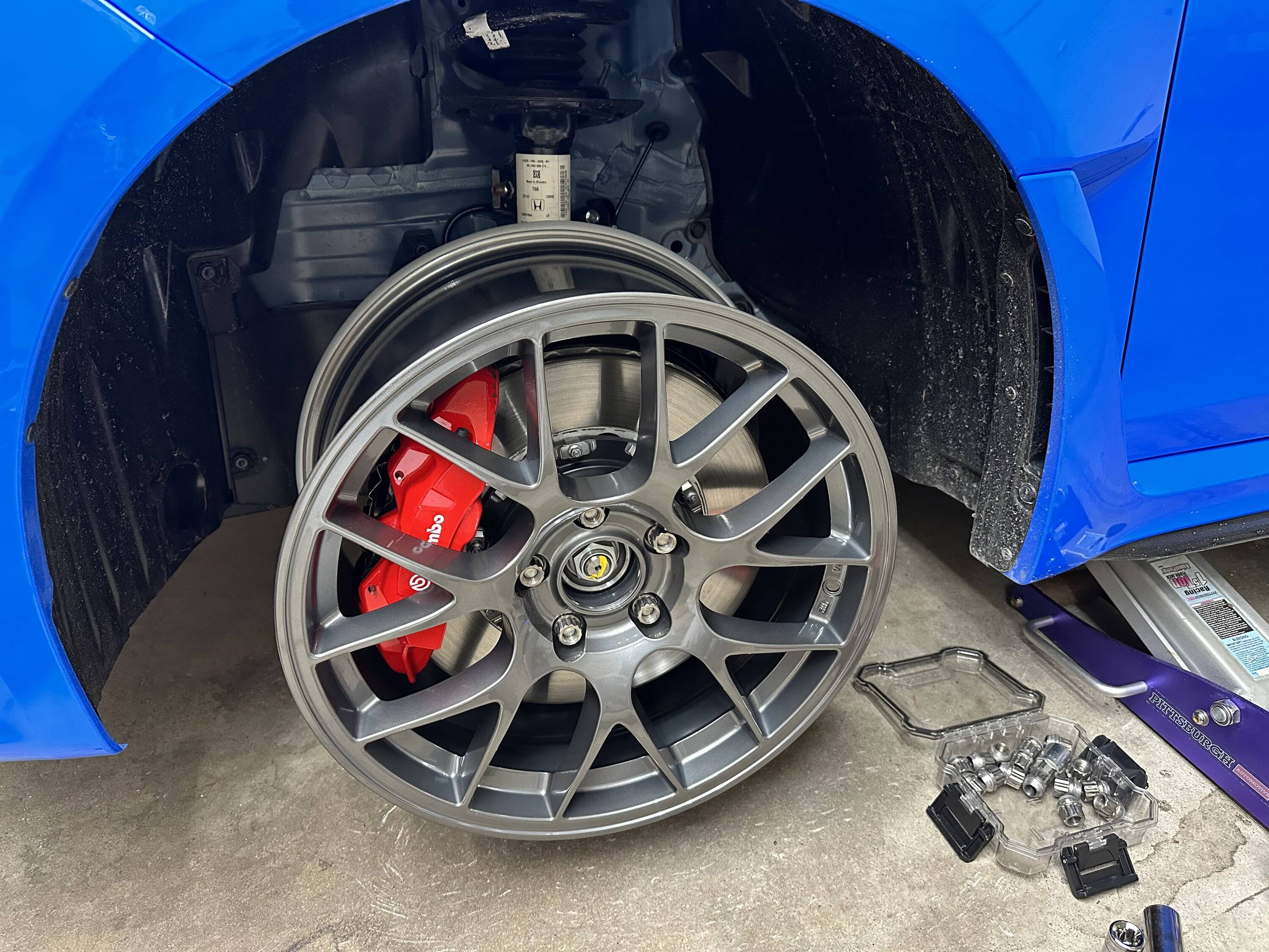

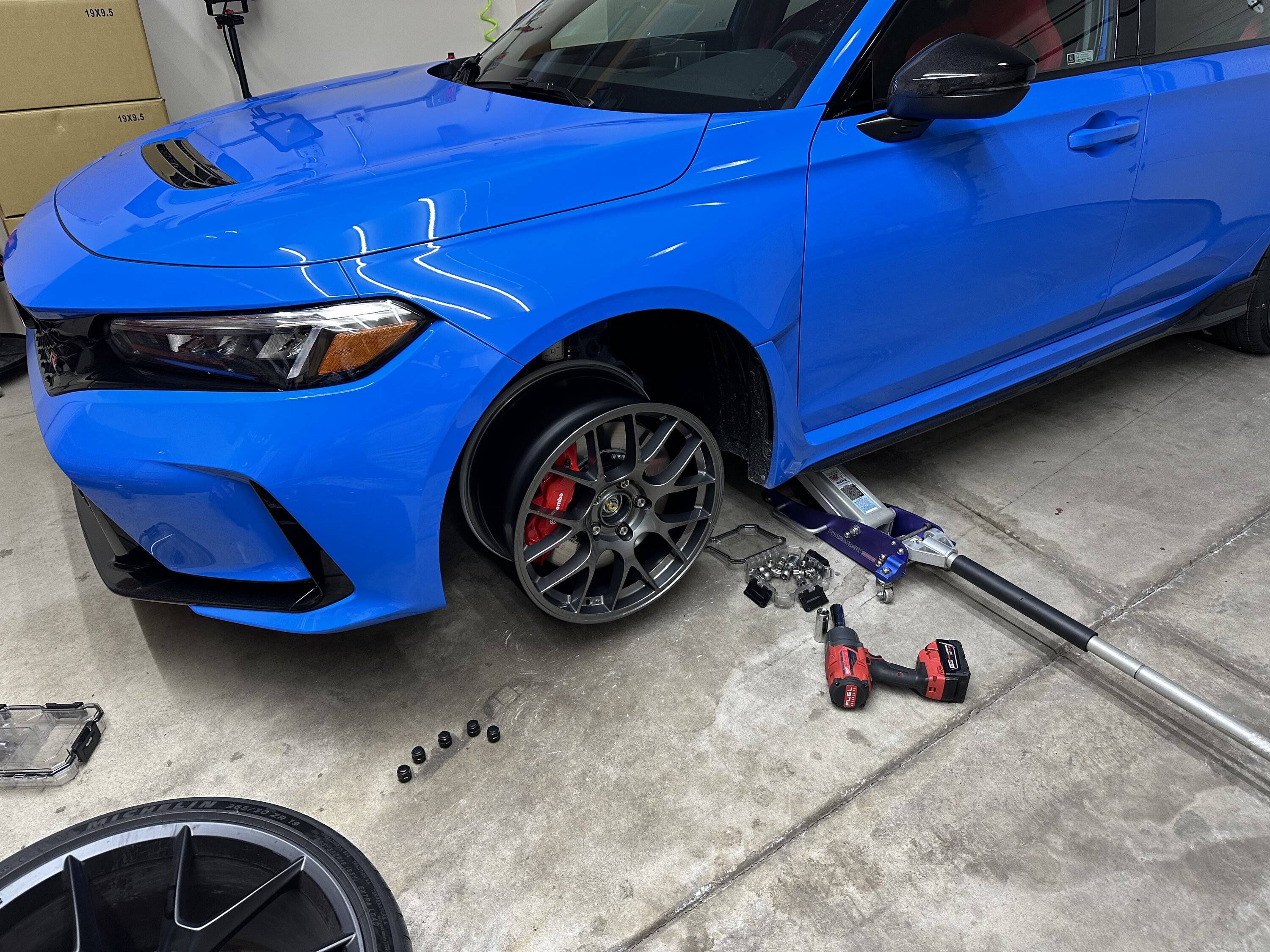

Purchase one ec7 in a 58 offset and it’s close but it fits! Ordered three more today! We have an 18” wheel that will work!

Great news. Any idea what the clearance measurement is between caliper and spokes, and caliper and barrel?

Next time I get them on the car I’ll check.

Got a few photos with a set of these wheels on it? I'm trying to hold out for @APEXRaceParts to make the wheel I want but I'm growing impatient. Looking to sell myself on waiting.

I don’t yet. Haven’t had an event to put them on. Stupid Wisconsin weather
