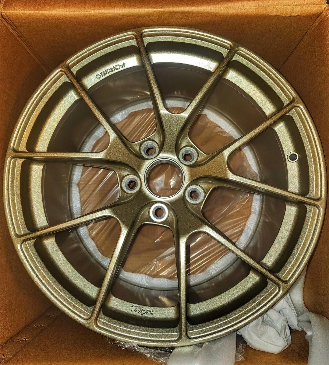

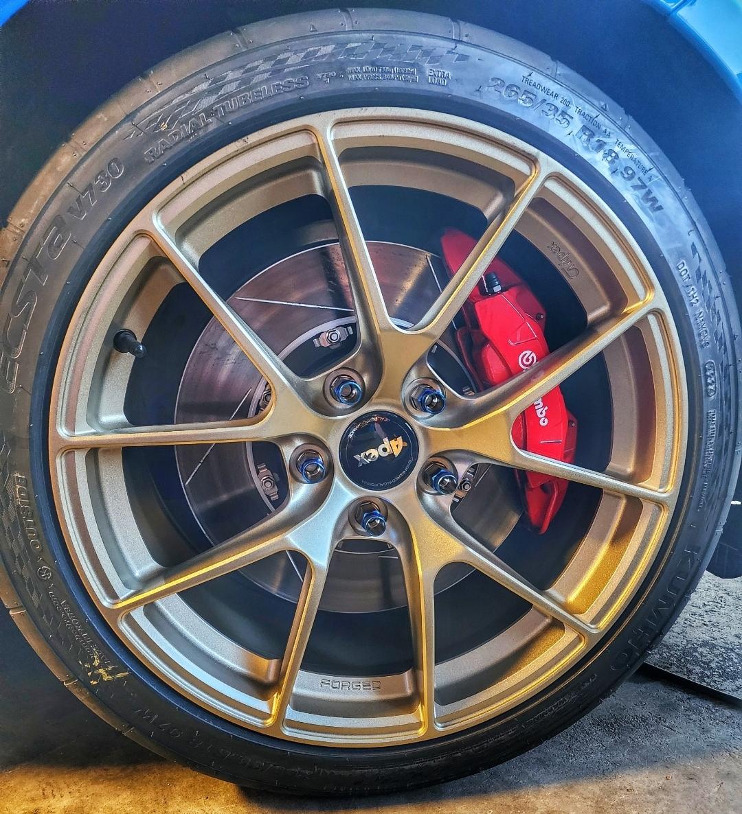

Apex VS-5RS 18x9.5" ET45 Wheel - 5x120mm / 64.1mm - Motorsport Gold
Bridgestone Potenza RE 71RS - 265/35
Evasive Titanium lug nuts
ARP wheel stud
Mishimoto hub centric wheel spacer 10mm
Brakes:
AP Racing by Essex Radi-CAL Competition Brake Kit (Front CP9668/372mm) with Pad Tension Kit

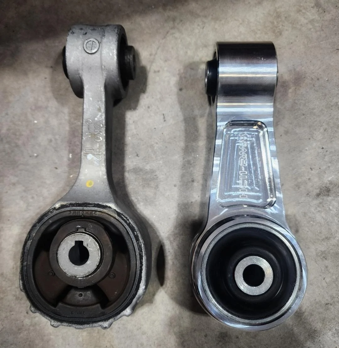

PRL Rear mount engine mount

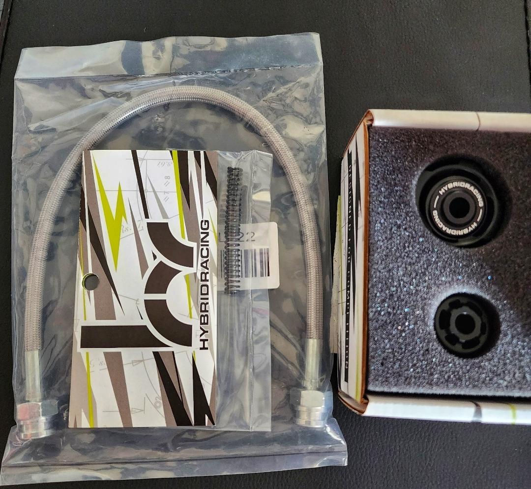

Hybrid racing short shifter assembly
Hybrid racing heavy duty trans detent springs
Technafit stainless steel clutch line

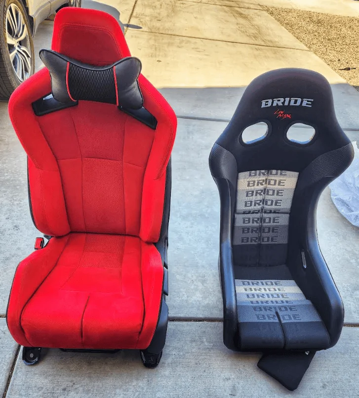

Bride rail seats
Bride zeta IV Carbon Fiber

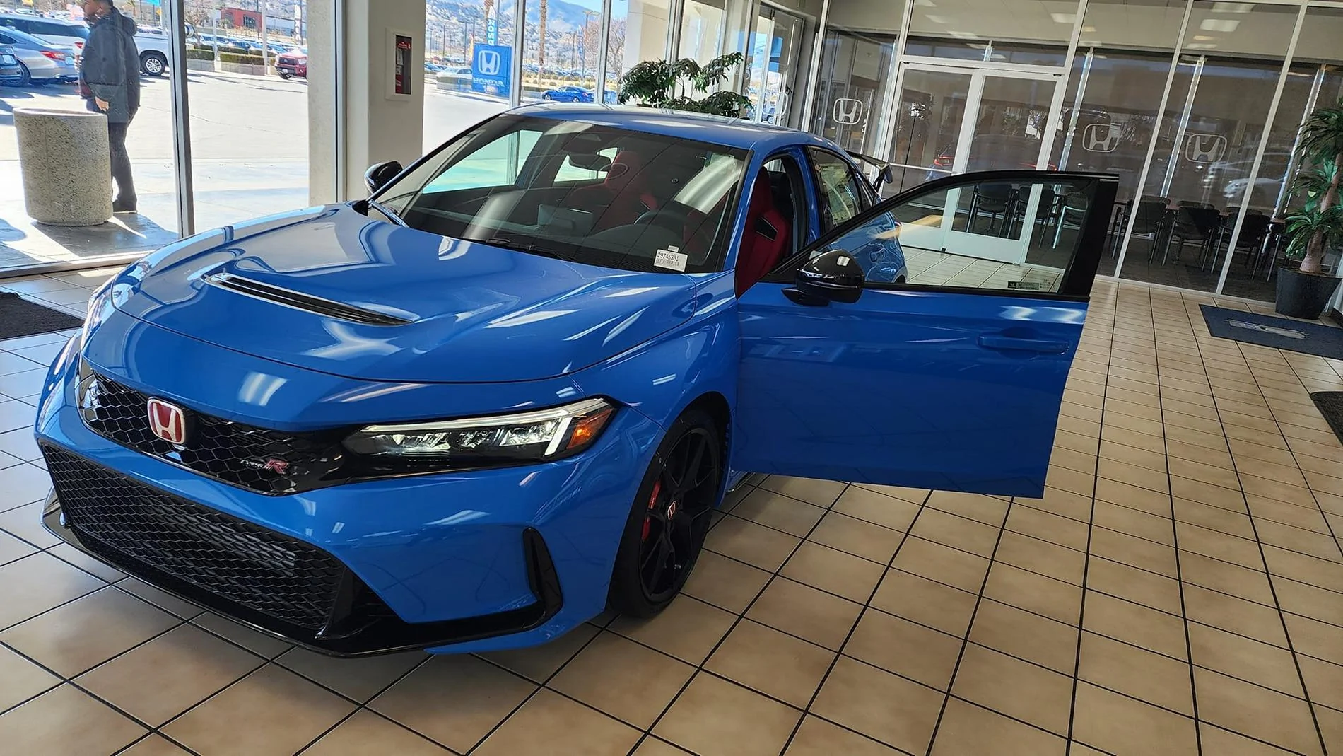

Day 1 at the dealership:

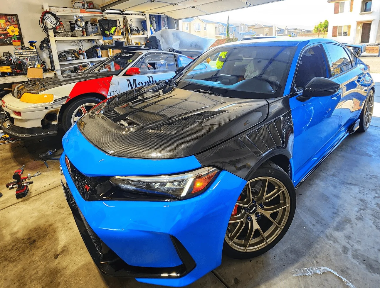

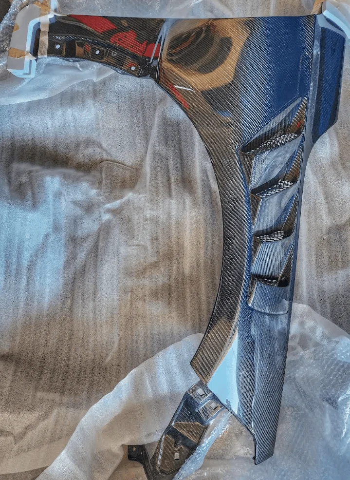

Are those the CMST fenders?
Nice CRX!
BuntaTypeR
BuntaTypeR
Jan 19, 2024
193
214
2024 Civic Type R, Tesla M3P, 08STi, S2k,Rsx-S
Nice CRX!

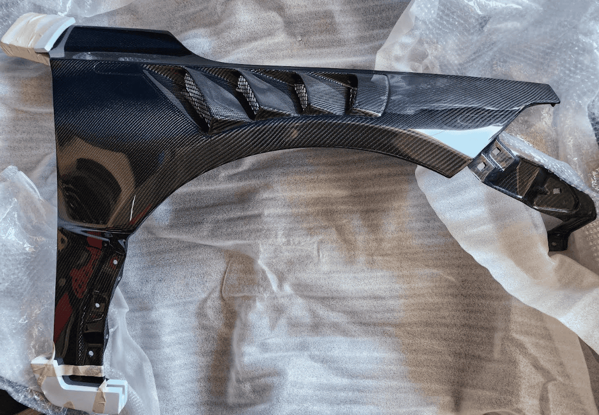

fenders are from alibaba. it is cheaper!

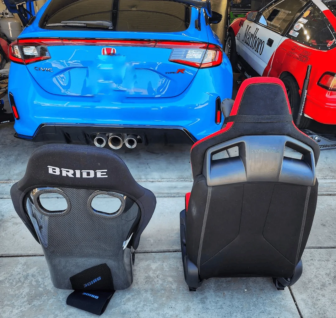

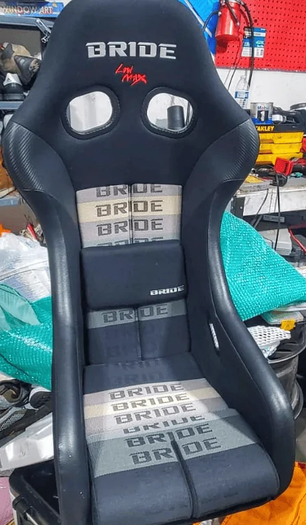

Just looking at those Bride seats makes me feel fat šŸ˜‚ Great build thread!

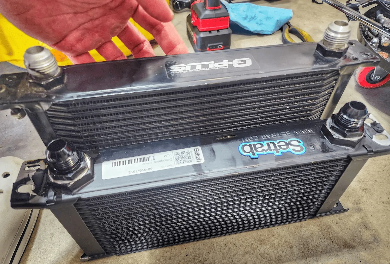

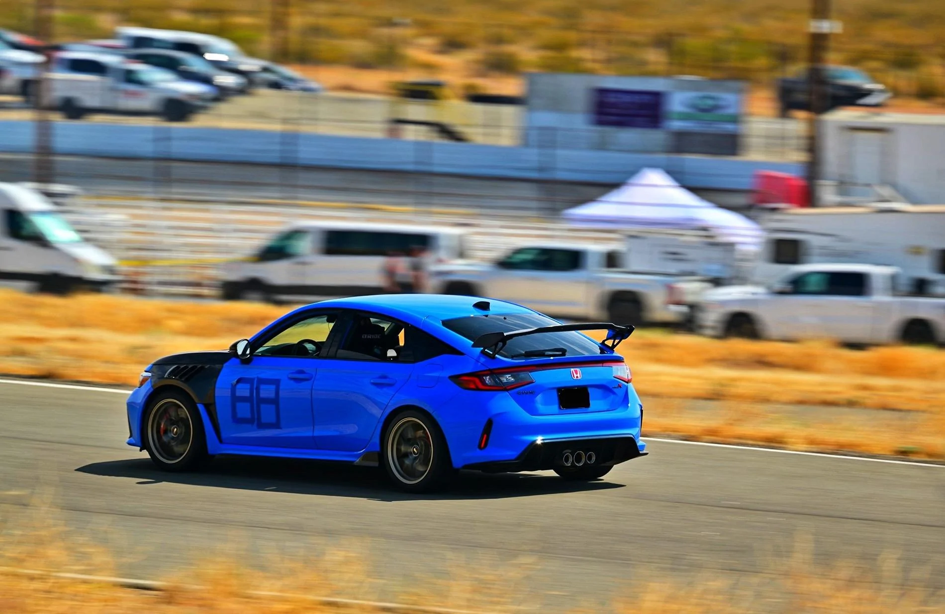

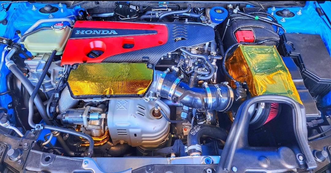

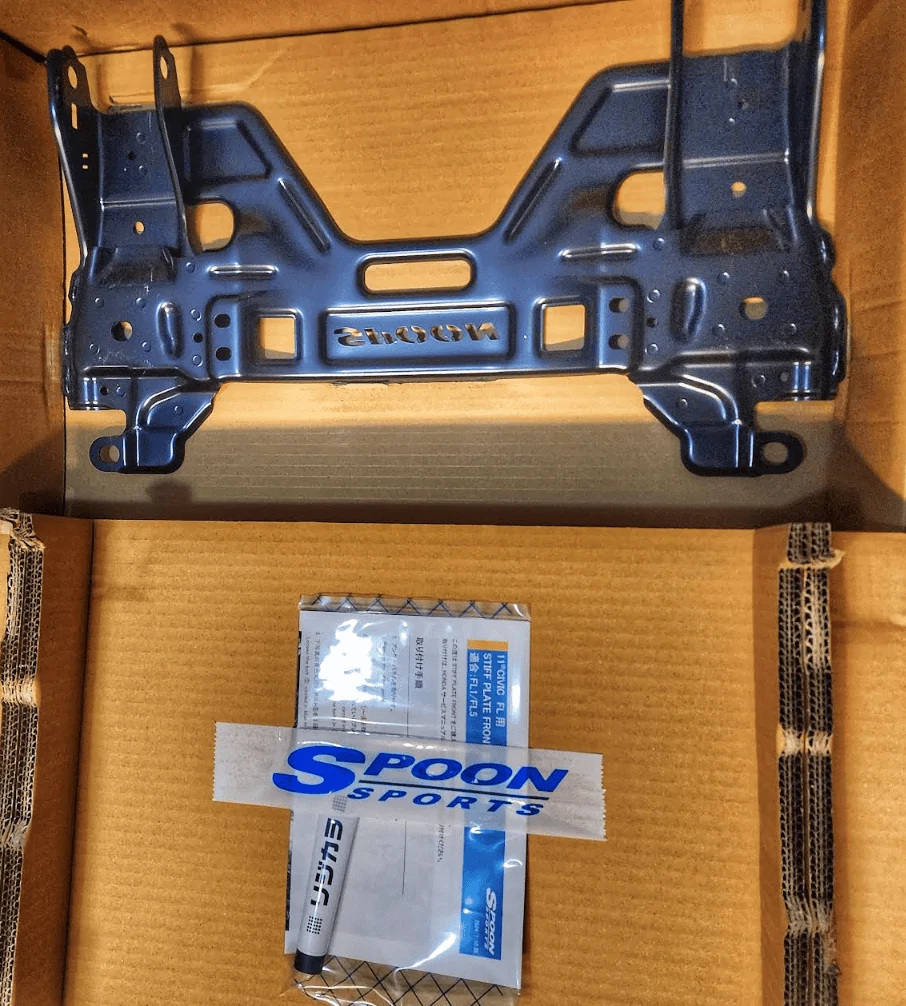

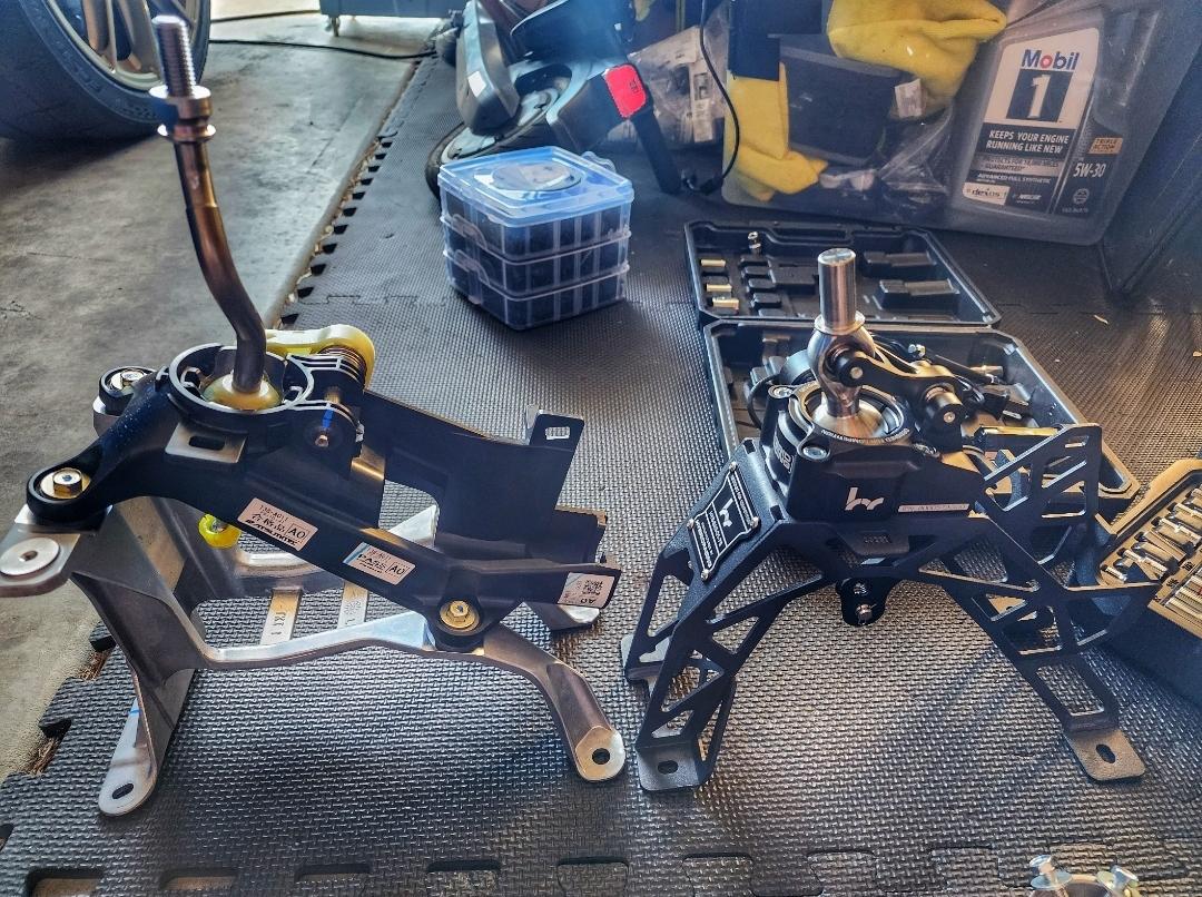

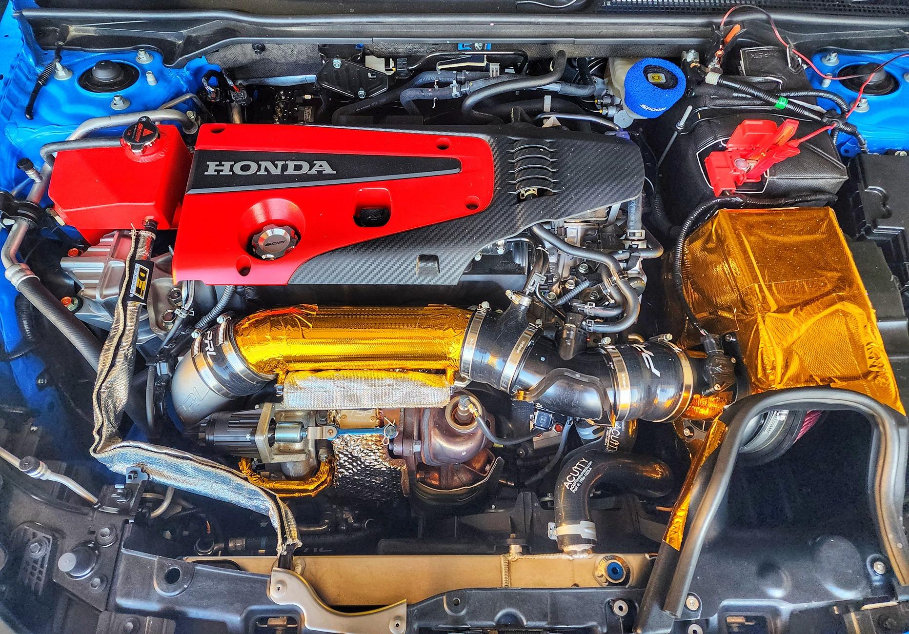

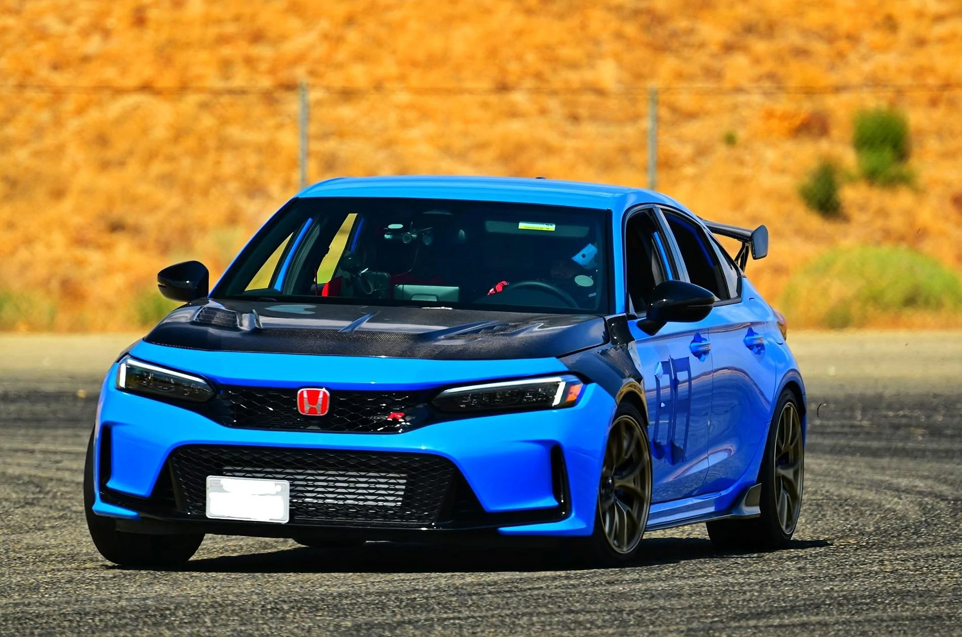

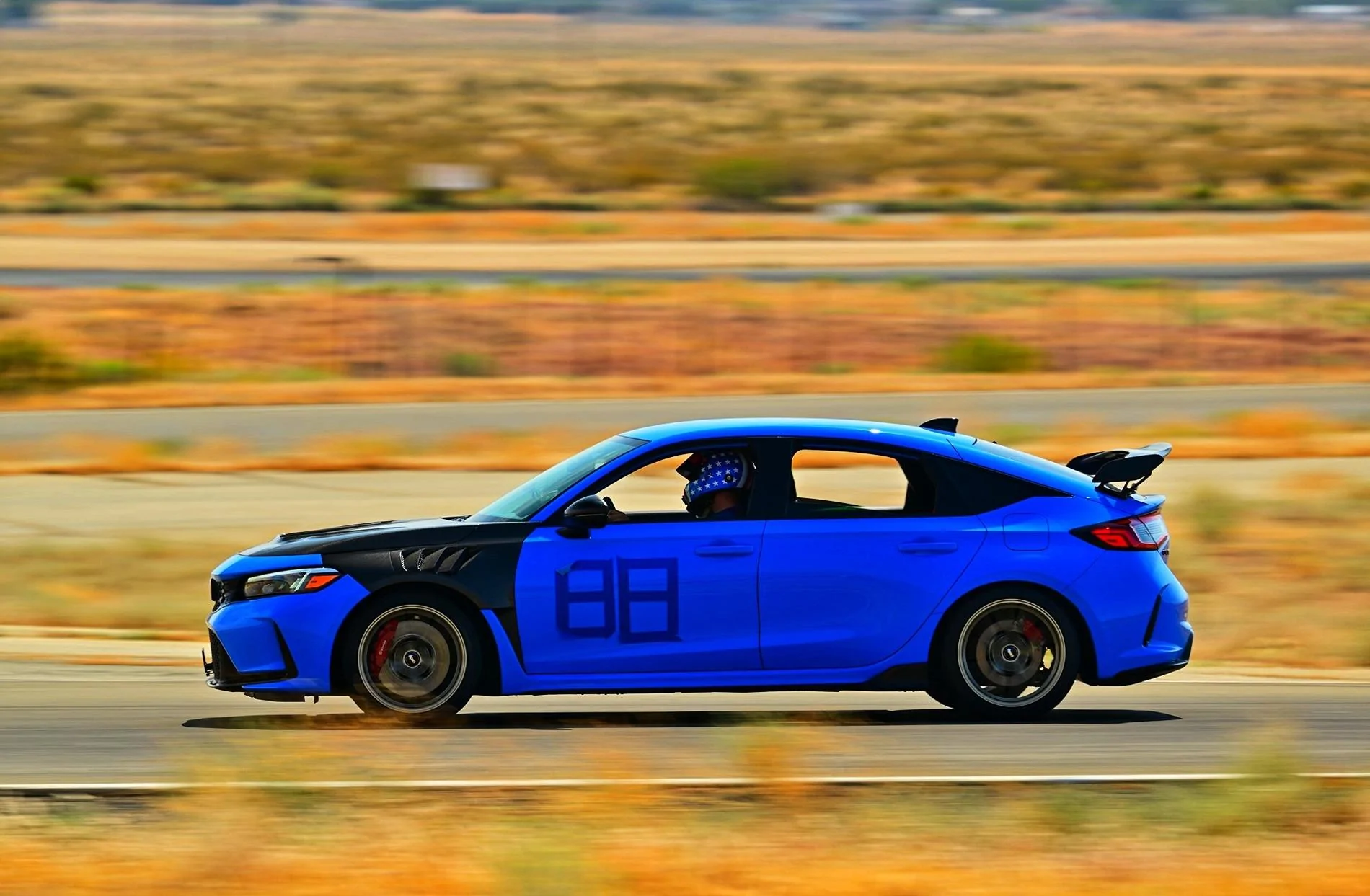

Went to Streets of Willow yesterday, where the highest temp reached 102°F. Thankfully, I didn’t notice any signs of overheating from the car. However, I keep an eye on the temps and slow down once it exceeds 250°F. I feel a noticeable loss in power between 220°F and 240°F. The vents seem to have made a big difference compared to my last visit, where I was overheating by the second or third lap. This time, I managed to run 7-8 laps. Around the 5th lap, though, my tires felt shot, and I was sliding quite a bit. The RV6 rear sway bar and Spoon front stiff plate seem to help a lot—I can brake late and swing the car confidently. Surprisingly, the rear isn’t oversteering, just enough slide to assist my novice skills. I’ll be installing a second oil cooler soon, hopefully by next weekend. Here are some pics:
