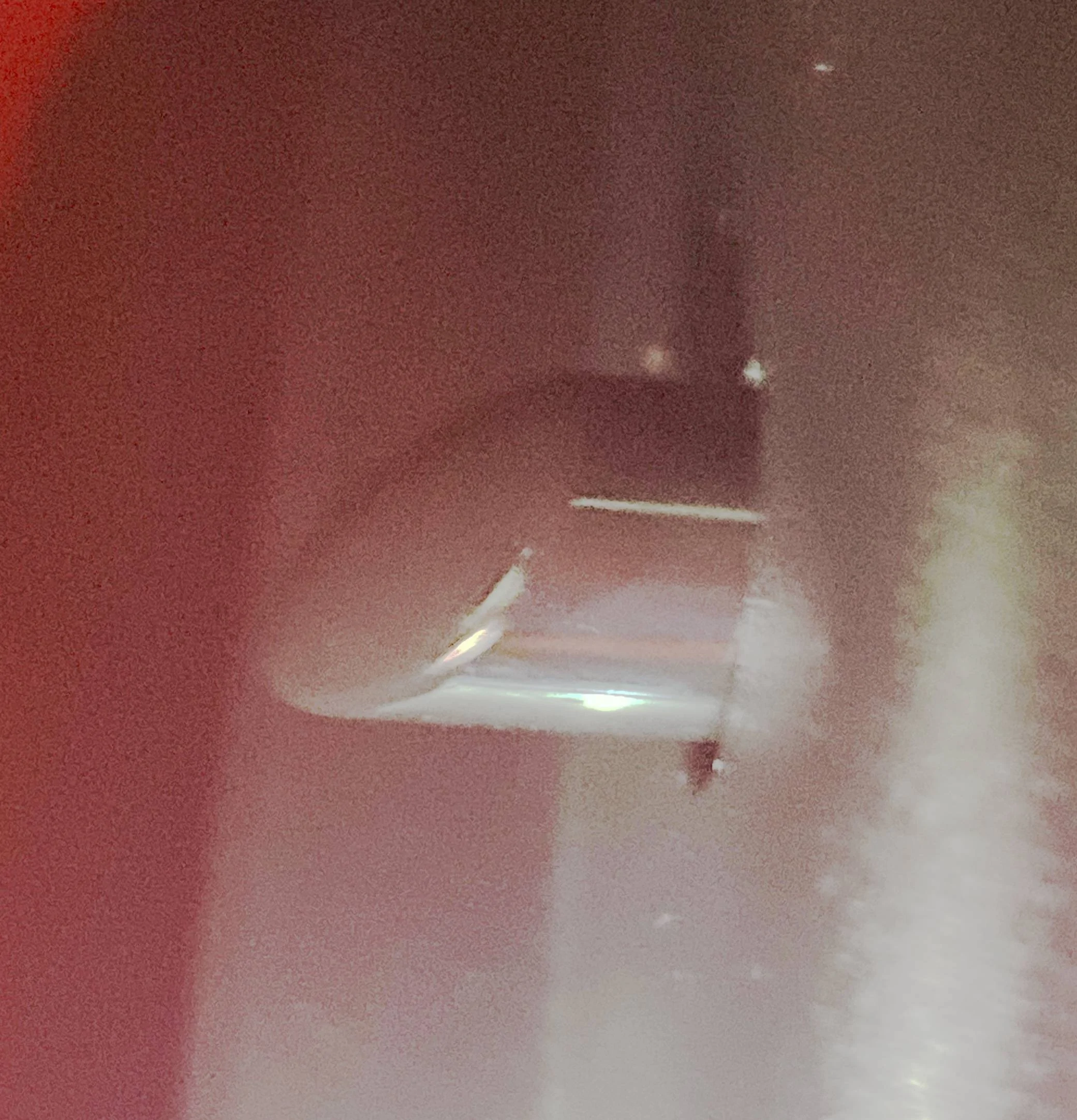

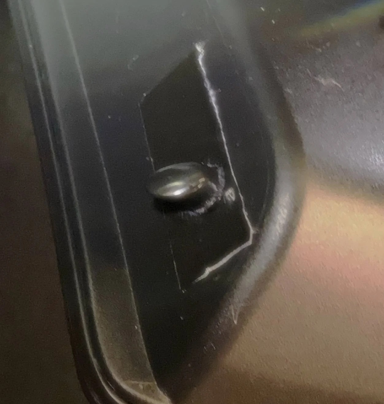

After about 20 minutes, I found it. See photo. It was the left-side glove box closing pin. There is one on each side. The one on the right was seated snuggly, but the one on the opposite side was a bit loose, although it engaged its detent properly. Every time the rpm’s reached ~2.4k the little bugger chimed in with a high-pitched buzz.
When I returned home, I took a small piece of black Gorilla HD tape, and using a paper punch placed a hole in it just smaller than the diameter of the closing pin. The tape was then placed around the closing pin such that it passed through the hole freely, but with just enough tension to stop the noise.
While it can’t be seen when the glove box is closed and isn’t unsightly when open, it totally eliminated the fucking noise! A more elegant solution may come later, but even if it’s for just a few weeks I’ll be happy. And more importantly, if this helps someone else I’ll be ecstatic!
