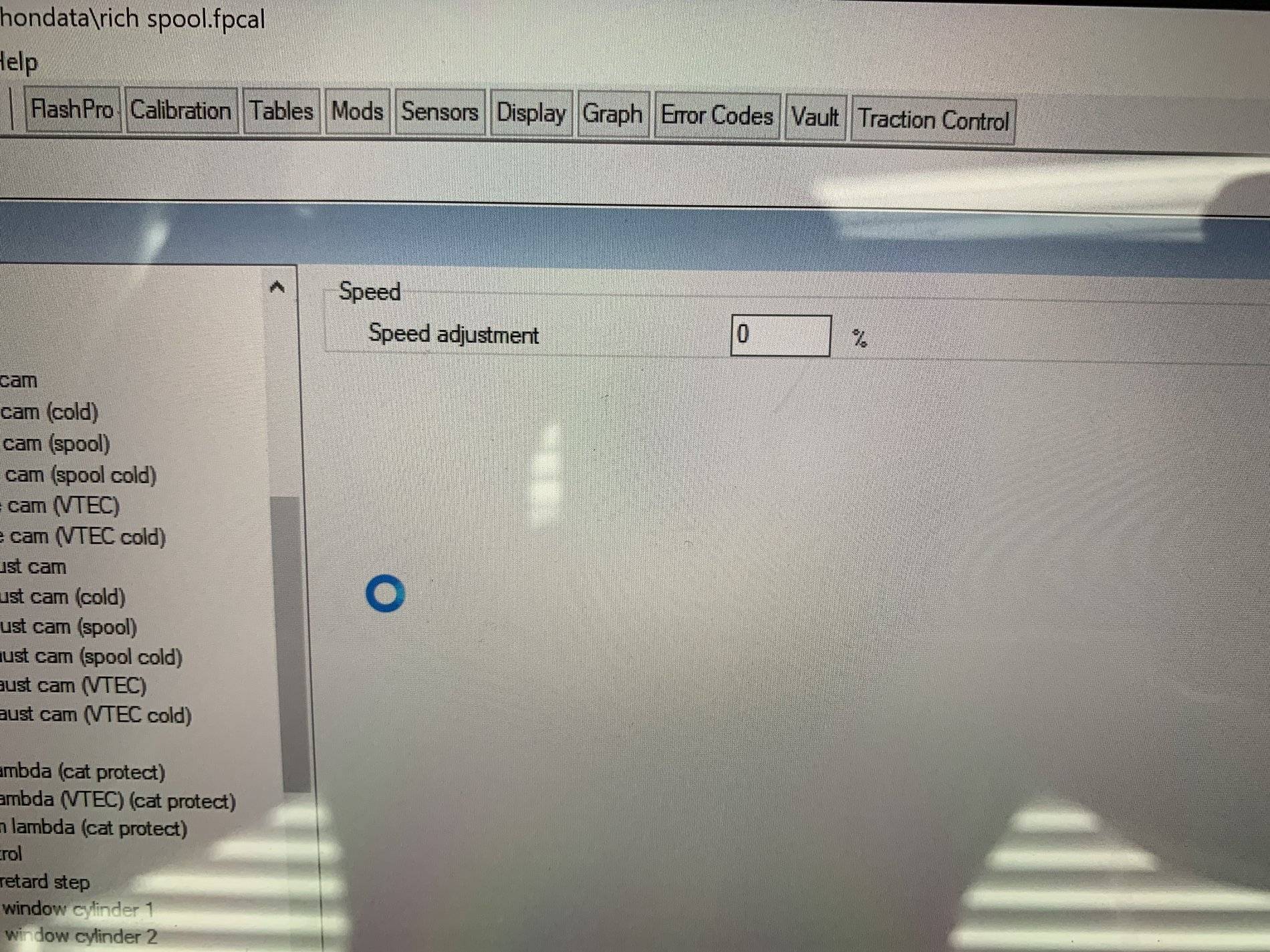

I'm a calibrator that works primarily with SCT Ford products and I have a question about my Hondata software for my FK8. Is there the ability to correct for tire diameter differences? I noticed there was an error compensation but it wasn't clearly defined. Just curious and thanks in advance.

If this is what your talking about yes.

I appreciate your reply.:thumbsup: I tried it after I didn't hear back. Still adjusting it.
