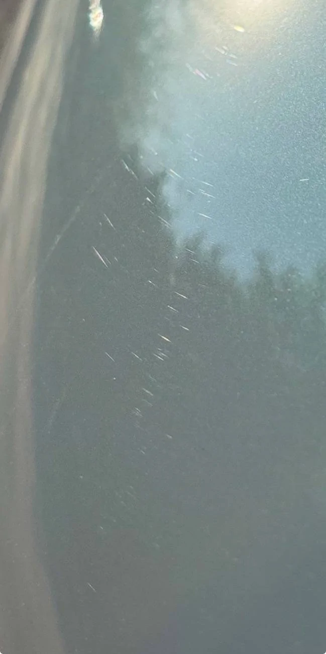

My type R is less than 3 months old. I dropped it off to get a window tint and the guy texts me when it's done, hey I also got you a complimentary car wash.
It never crossed my mind that he would do something like that. My stomach began sinking when I saw the ratched looking car wash in the same strip mall. Super cheap, 'hand wash' multi lane thing that looked like it hadnt been updated since 1979 basically they converted an automated wash into a low cost 'hand wash'. I noticed only old 4runners and 2005 ford taurus' seemed to be goin in..
You wouldnt believe it, the clear coat has more scratches now than a used audi I have with 207.000 miles.. there is tons of small scratches all over the paint basically over the whole car. The black trim inbetween the c pillars looks like a 2001 used civic now. The tail lights are scratched also.
I freaked out. The owner showed up with his detailer., the detailer marveled at how bad it was...
I dont want to polish into the clear coat just yet. These horrible mini scratches are only visible up close and under direct light.. but it bugs me. They offered a free detail, but honestly id rather do it myself than have someone polishing the hell out of my clear coat.
Is there any wax you guys recommend that fills little sratches like this pretty well?
I should have never left the car alone with this idiot. I cant believe the tint guy would think that some clapped out car wash like that would be a good idea for a brand new car. It's so bad it almost seems malicious. this is from the front fender and it looks like this all over the entire car now.

What kind of crappy tint place washes the car immediately, you're supposed to wait a few days! :mad:
I'm a big fan of Meguiar's Ultimate Compound to get out swirls and light surface scratches.

But tint is on the inside of the windows?
Anyways - perfect time for them to pay for a 1 or 2 step paint correction. Then find someone else (that doesnt suck) and have them ceramic coat it.

You can polish the glossy black trim too, but you have you'll have to be a little easier on it since theres less material than paint panels. TBH, this is on the tinter for taking your car to a sub tier car wash. Take more pictures and have them fix it. Whether they pay for a complete detail/paint correction or replace the damaged parts, its on them.

First of all, take a deep breath and relax. On the scale of actual catastrophes, this is like a 0.5. I know it's a new car and you have a lot of emotion tied to it. And I agree, it's an idiotic mistake and you have every right to be pissed- and some people would make an absolute scene over something like this, I get it. But it happened. And it's an object, not a person or a pet; it's only devastating if you allow it to be.
As someone else already said, your first option is have them pay for a correction. But honestly that may not be your best option for a couple reasons, one being negotiating stuff like this is hard, and two you might just end up with another vendor that doesn't know what they're doing and you end up disappointed again.
So another suggestion is forget these idiots and learn to correct the paint yourself. It isn't actually all that hard, and you get to learn a skill. And honestly, most new cars- especially those shipped from overseas- usually need at least a minor paint correction when they're delivered anyway. The only downside is the initial cost of a decent orbital buffer, and then the time spent watching a few youtube videos and then the actual effort of polishing the car.
The stuff on the inside, don't know what to tell you. I've got a Type S with far more piano black than the FL5, and I notice micro scratches but nowhere near enough to bother me. Some people may be more sensitive to stuff like that... it is tough to imagine significant damage done by just taking a cloth to it but I haven't seen it... not sure there's much you could do about it regardless.

I think most folks these days skip the wax entirely and go straight to coatings.
I think the proper answer is going to fall back to a polish. The only difference really between "waxing" and polishing is that you're using a machine. I know that's an incredibly oversimplified view, but when it all comes down to it that's pretty much it.
You can try putting any decent carnauba wax on by hand and see what happens, sure. It will probably look great from a distance, but I'd temper your expectations for making the scratches go away to the point where you'll have complete peace of mind. That part will require a physical buffing with a machine to "rearrange" the clearcoat and eliminate the scratches. A professional (with a good reputation) is your best bet here because it's a new car, but there isn't really much opportunity for you to screw anything up by doing it yourself assuming you use an orbital buffer (NOT rotary...).
Of course I'm no pro detailer, but I have had amazingly good results polishing a couple of my sons' cars. I'd buy them used with paint in fair condition, and then after a polish and applying a user-friendly DIY ceramic coating (there are tons on the market these days), and they'd be looking like new with almost no visible scratches, and stay that way for months to years.
I think I used this kit exactly... but maybe with Mequiar's pads and compounds, it's been a while. The stuff it comes with should be perfectly fine.
Just saying, polishing isn't as scary as some folks think it is.

I would have a professional, reputable detailer do a paint correction and ceramic coat. I would skip waxing. Really, need a reputable detailer to give you a reality check on what can be done and what you should expect of the results.

You want a glaze....
a glaze fills imperfections...issue is it doesn't provide much protection

Meguiar's PlastX works well for me when polishing plastics.
It is very gentle compared to some compounds. It takes out light paint scuffs too. I originally bought PlastX for motorcycle windscreens. It also polishes headlights.
