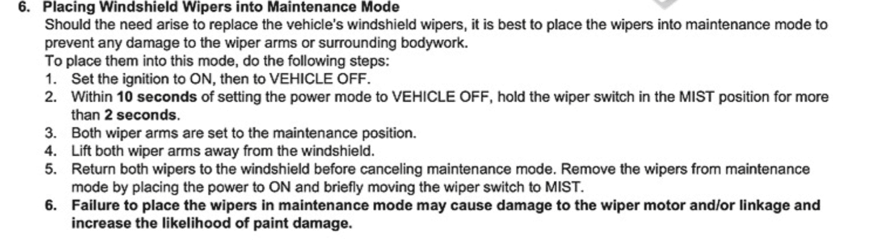

Also there is a maintenance mode for the wipers to move them up so you don't hit the hood.
11th Gen Honda Civic Changing wipers on Touring Screenshot_20220611-164836
