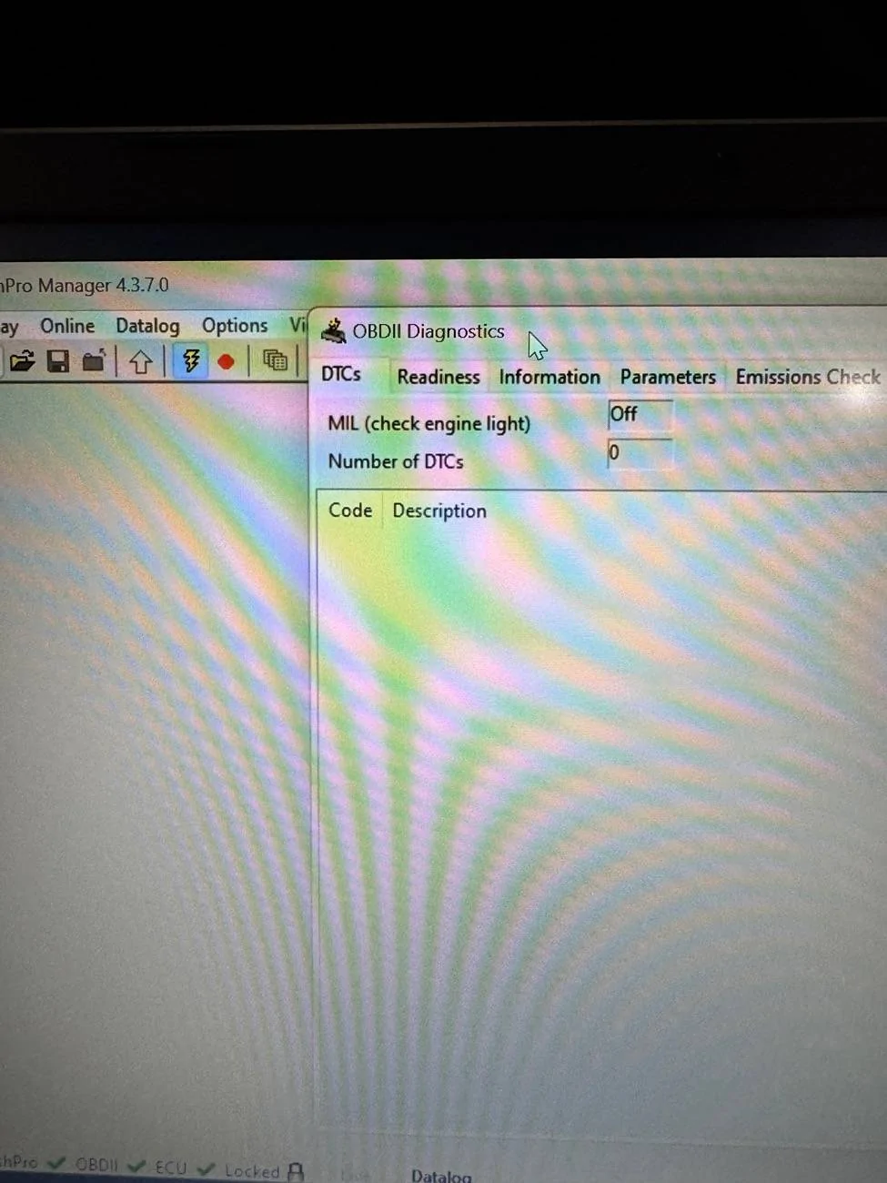

Long story short. Went from 4-3 when I wanted to go 4-5. Auto rev-match was on, so the engine revved high. I didn’t hear the shift sound you normally would when you rev to redline so I think I’m good.
Lesson learned.
Either way, I just want to be really sure that I’m good.
I hooked up the Hondata to the car, turned the car on (engine on) and clicked the data log icon (thunderbolt icon). Then I clicked on OBD|| and saw this screen. It was empty.
Also clicked on the Error Codes button and it was empty.
Am I going about this the right way? I’m looking for the P0219 code.
Also, that isn’t a code you’d be able to clear either right?

Happy to report no codes past or present. Looks like I was within safe engine parameters when I accidentally downshifted and just got caught off guard.
I do have an Evap Readiness monitor that is incomplete but that may be due to the fact that I haven't driven much since tuning the car in December (if that wasn't already apparent by the mis-shift).
