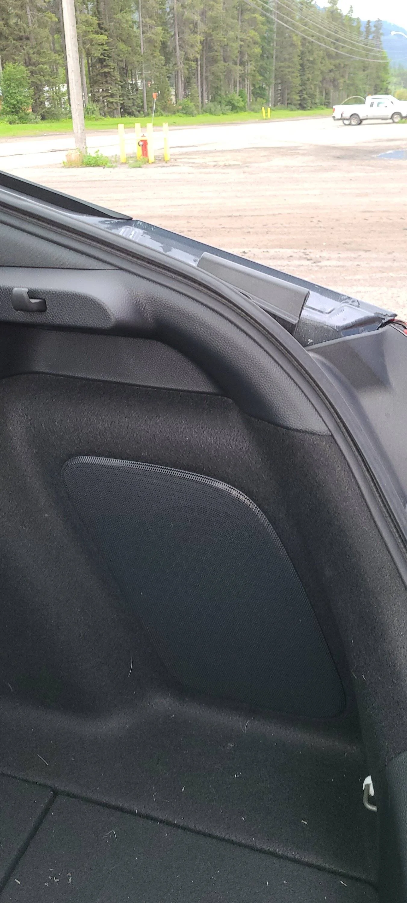

Disregard the debris, I gotta vacuum it out again. (Waiting on weather tech floor mats).
22 sport touring hatchback, bose System. The sub is located on the passenger side side panel in the trunk facing towards the driver's side. I'd imagine it's the same for all civics with the bose system.
thank you very much Curtis for going through the trouble but unfortunatley the sedan bose systems subwoofer isnt located in the same area nor does it operate in an enclosure like the hatchbacks (atleast as far as I'am told so far)
but again many thanks for the effort

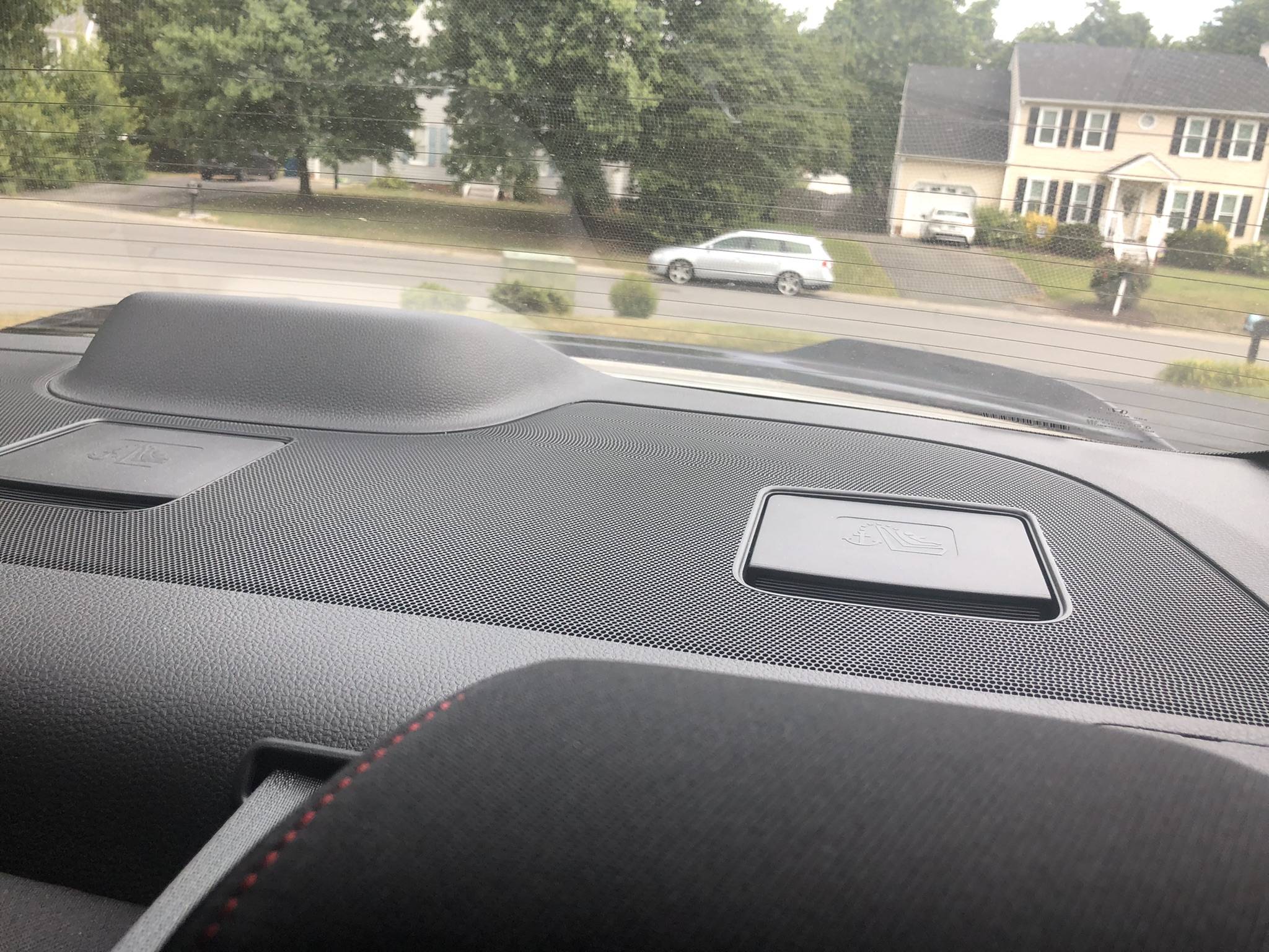

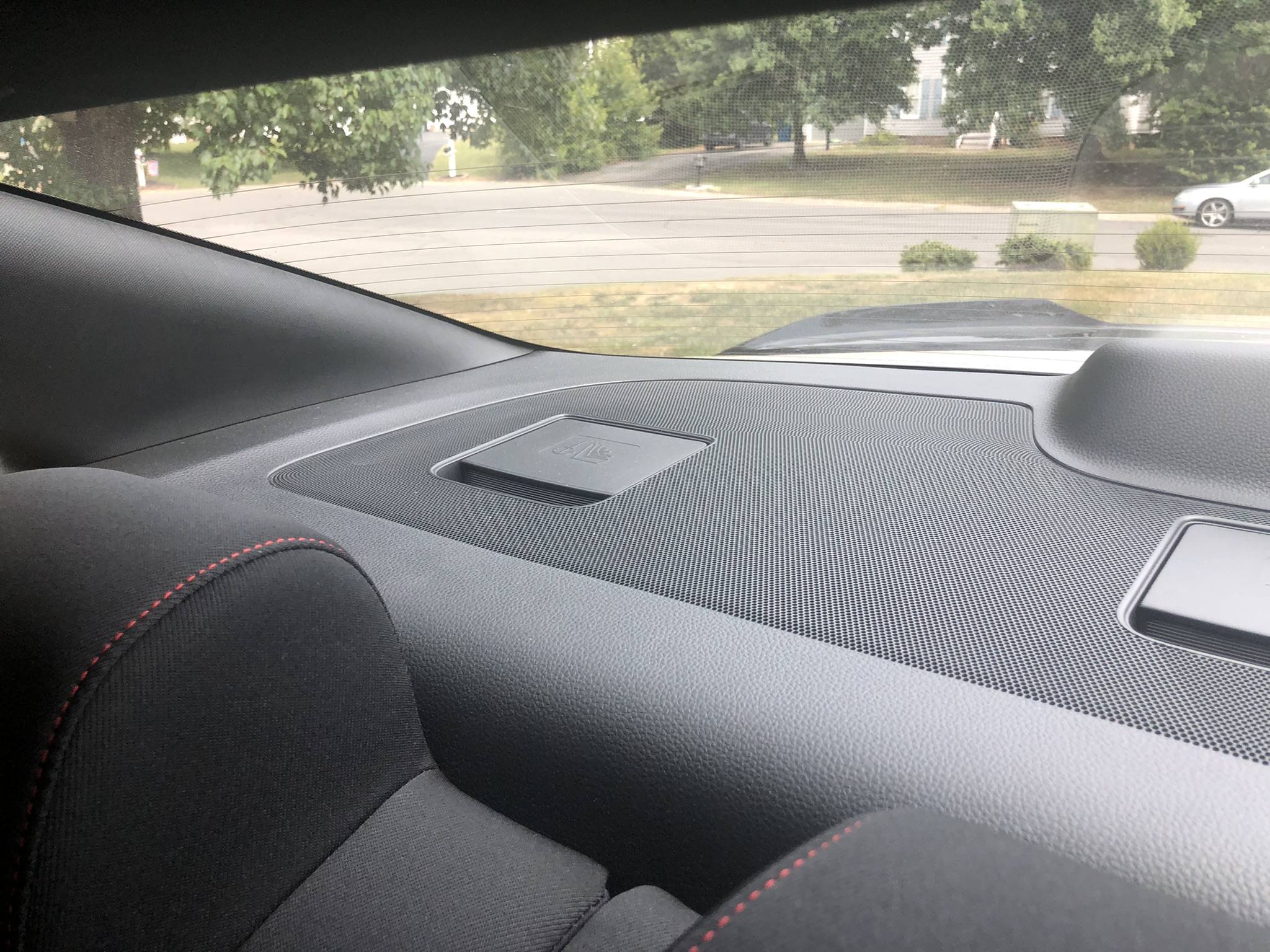

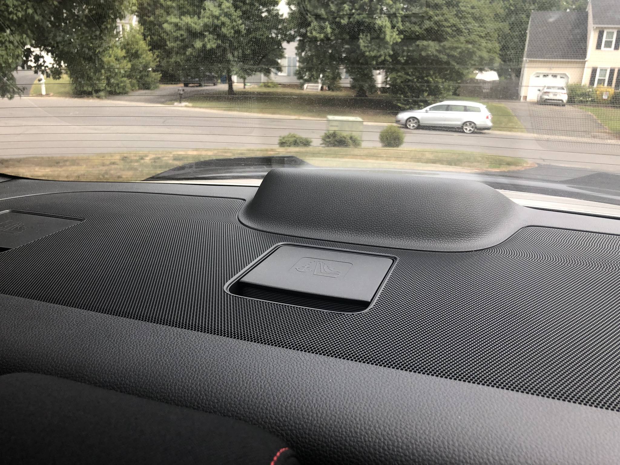

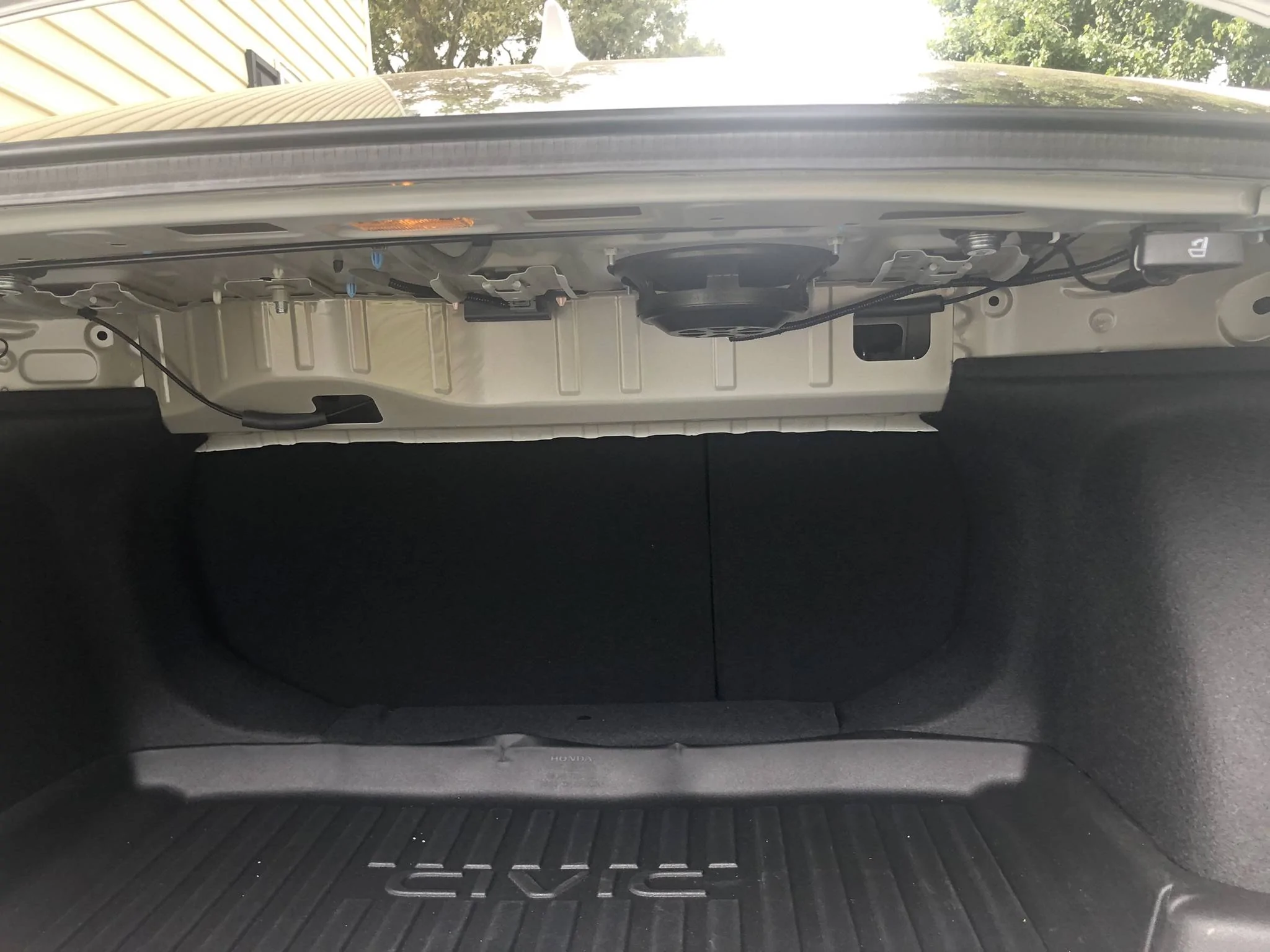

Ah! Now I understand. I took some pictures of the rear deck:
Hi Jamie,
thank you soo much for the effort in guiding me greatly appreciate it, what I was initially refering to is actually a picture of that plastic cover that is in the cabin that sits on top of the rear deck.
my car (being without a bose system) doesnt have any grill for the subwoofer to fire through into the cabin and was wondering what the bose equipped sedan rear deck platic cover looks like to see if I can make a similiar grill.
anychance you can take a photo and upload? or does it have a grill in the first place?
Ah I understand now!
I took a few pictures of the rear deck. As you can see, there is no obvious access panel for the speaker. The speaker is offset slightly to the right (from the trunk perspective) and fires through the panel itself. I hope these images help.
Bang on!!! thank you soo soo much!
this confirms what I thought ,I need to somehow get a U.S spec Bose rear deck cover :)

Glad I could help you! You may want to make sure you can mount a speaker to where the deck panel mounts to the metal frame of the trunk. I'm not sure if it's a separate piece from Bose/Non-Bose systems. Best of luck!
