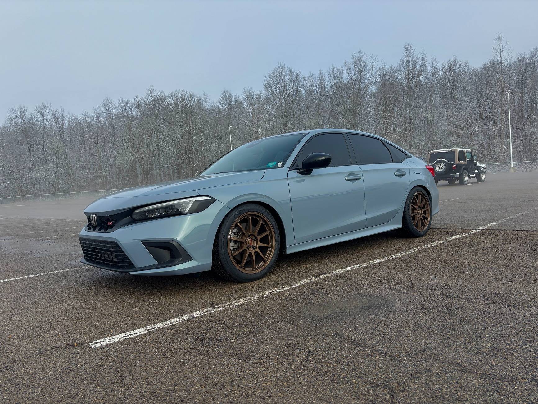

I'm running 18x9.5 +38 on Swift Springs, I've quite enjoyed these springs, its the right amount of stiffness I'm looking for. I think it needs a sway bar as well for when its turning.
How hard have you pushed the car in curves?
THAT IS A VERY SHARP SEWUP REALLY LOVE HOW THE TIRES ARE FLUSH AND SEEMINGLY EQUALLY LOWERE F TO R
Unfortunately, its not flushed theres definitely some poke, but its not much and you can't tell unless you really come up close and look from the side. But theres no rubbing, I'm running 255/40R18 tires.
