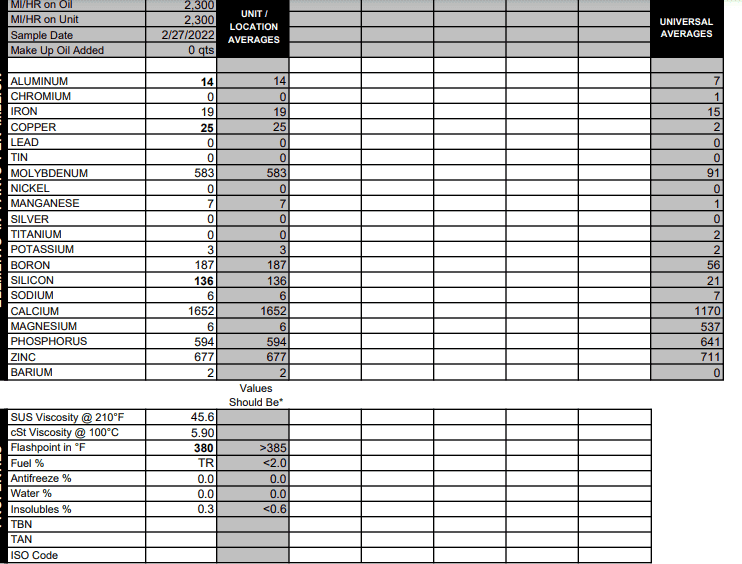

Recent Blackstone Oil Analysis for my '22 Si. Changed the oil at 2500 miles.

Honda does use a break-in oil as you can't find any Honda oil with the same formula that you see in the factory oil (as shown above ^) The high moly is a dead give away.

i've heard they don't use any special oil and the high moly is from the assembly lube which gets mixed into the oil. so, it basically does the same thing as break-in oil.
