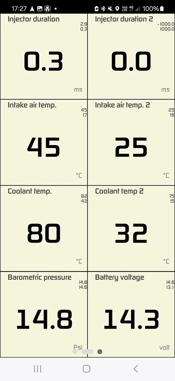

It really depends on the driving condition. ECT2 will climb very quickly and come very close to ECT1 in stop start traffic/low air flow situations at which point the fan will kick in to control ECT2.
ECT2 should drop quite quickly once travelling above 80kph/50mph and sufficient air flow is achieved.
Below is a capture of the delta during a 80kph cruise, do be advised that these are metric system numbers.
11th Gen Honda Civic ECT2 reading only 5-10 degrees below ECT1 Screenshot_20240812_172716_Hondata

Great stuff @terrance đź‘Ť
