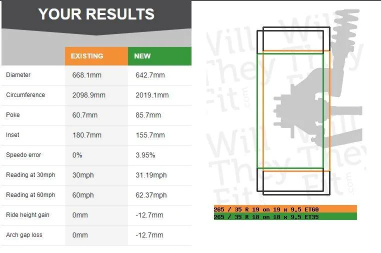

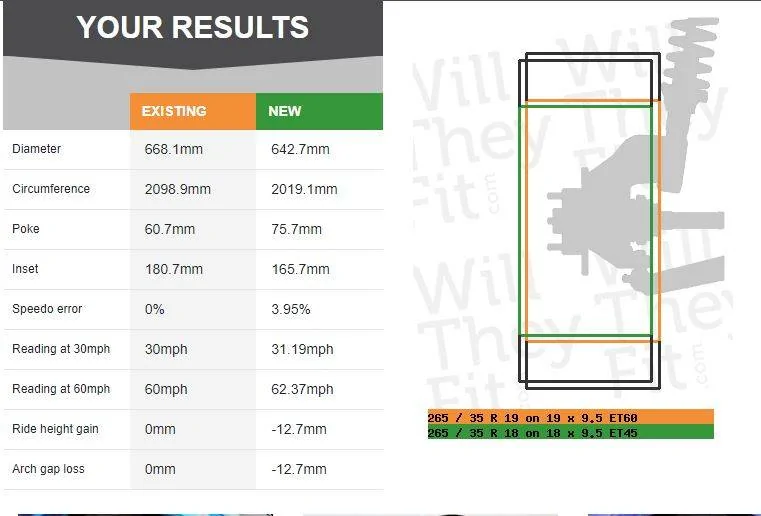

Option B with the Michelin Pilot Sport All seasons, +35 might out stick a little too far especially if you decide to lower the car later. General rule of thumb for the FL5/FK8 is 9.5 wide wheel with a +40-+45 offset, anything smaller will have rubbing and fitment issues.
First image is with +45 offset, the second is with +35.
