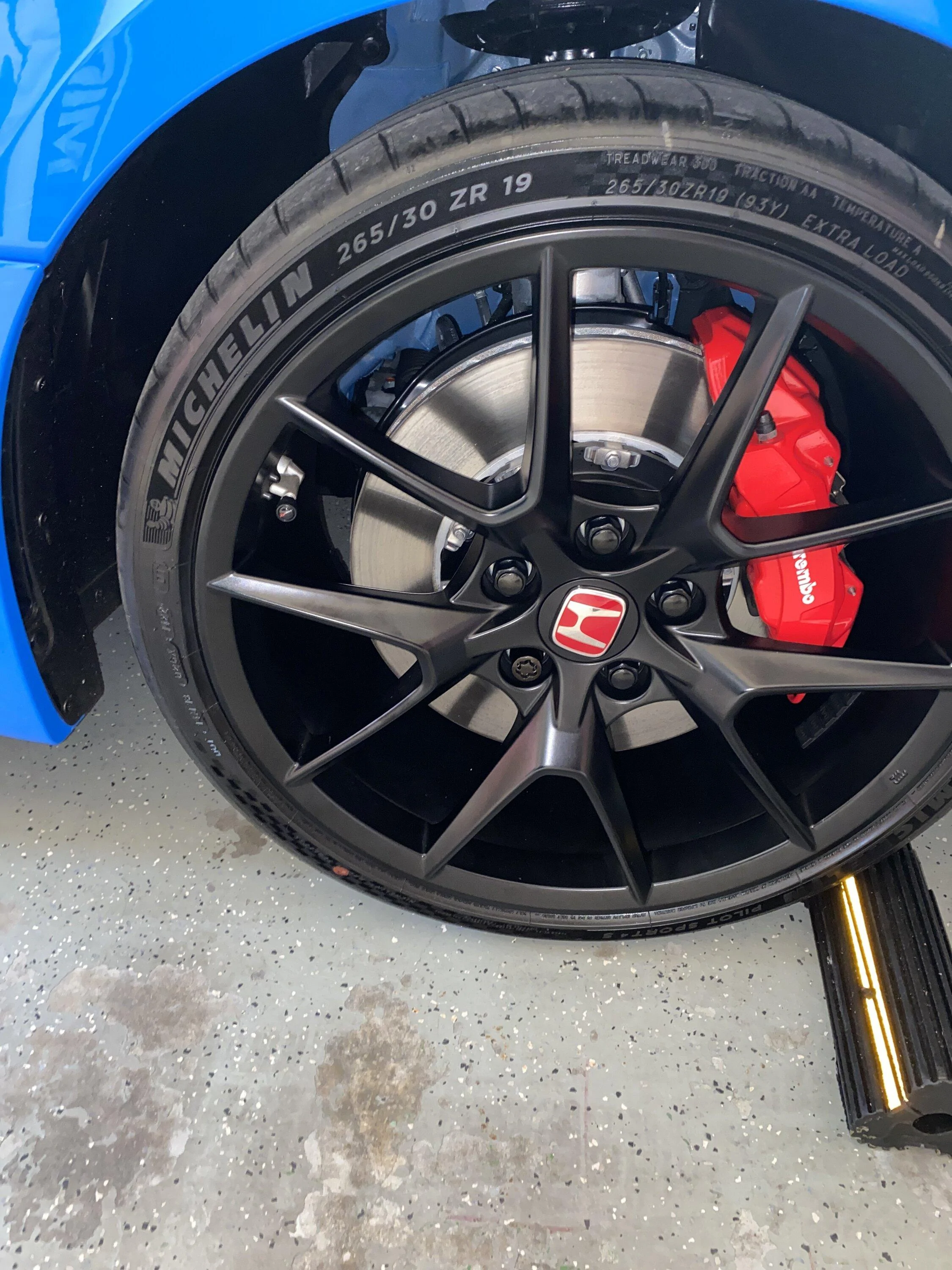

Yes, I applied the first one (Zink) listed as a base (two very thin coats after light, careful sanding with a Dremel) and then the matte finish afterwards, and with two thicker coats. If you do it, take the wheel off and do it in a dust free area. I didn’t take a beforehand picture of the curb rash after trying to extricate my car from being pinned between a curb and truck that parked so close I had to enter from the passenger side, but here’s a picture I took afterwards only because it turned out ok. The abrasion was at about 9:00 in the photo (near valve) and about 8cm x 1cm. I watched a bunch of Youtube vids and took my time (>2hrs. including curing between coats). The gouges weren’t very deep (fortunately), but ugly as hell especially after sanding. Now, it’s near impossible to see, but I still know it’s there!

Yes, I applied the Zinc as base coats (Tesla Wheel Touch Up Paint for 20" Model Y Black Induction Rims - DIY Curb Rash Repair with Color-matched Touch Up Paint - Made in USA https://a.co/d/br5Lzm9). The Zink paint is really expensive, but considered to be a long-lasting product. However, it alone was to glossy, so I applied the satin paint (Wheel Scratch Fix Quick And Easy Wheel Touch Up Kit Universal Colors (Black (Satin)) https://a.co/d/etf394w) over it. It is a very close match as you can see from my posted photo. My best tips are to prep the surface by lightly and very carefully sanding and then to rub with alcohol. Apply thin coats until the final top coat. Use an artist’s fine-tip brush. The ones that come with the touch paints were too big and held too much paint for my application. Do all the work with the wheel off and in a dry, dust-free area. With patience and care, you can get a nice coverage. It’s not what a pro shop could do, but much less expensive. And if you don’t like the results, you can always take it to a pro later. Hope this helps and feel free to reach out with questions.
