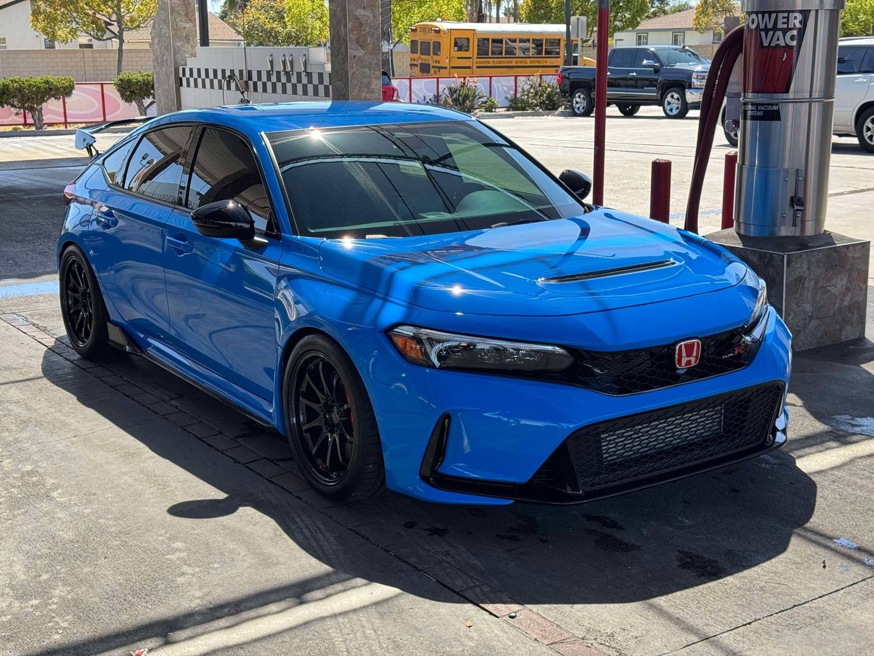

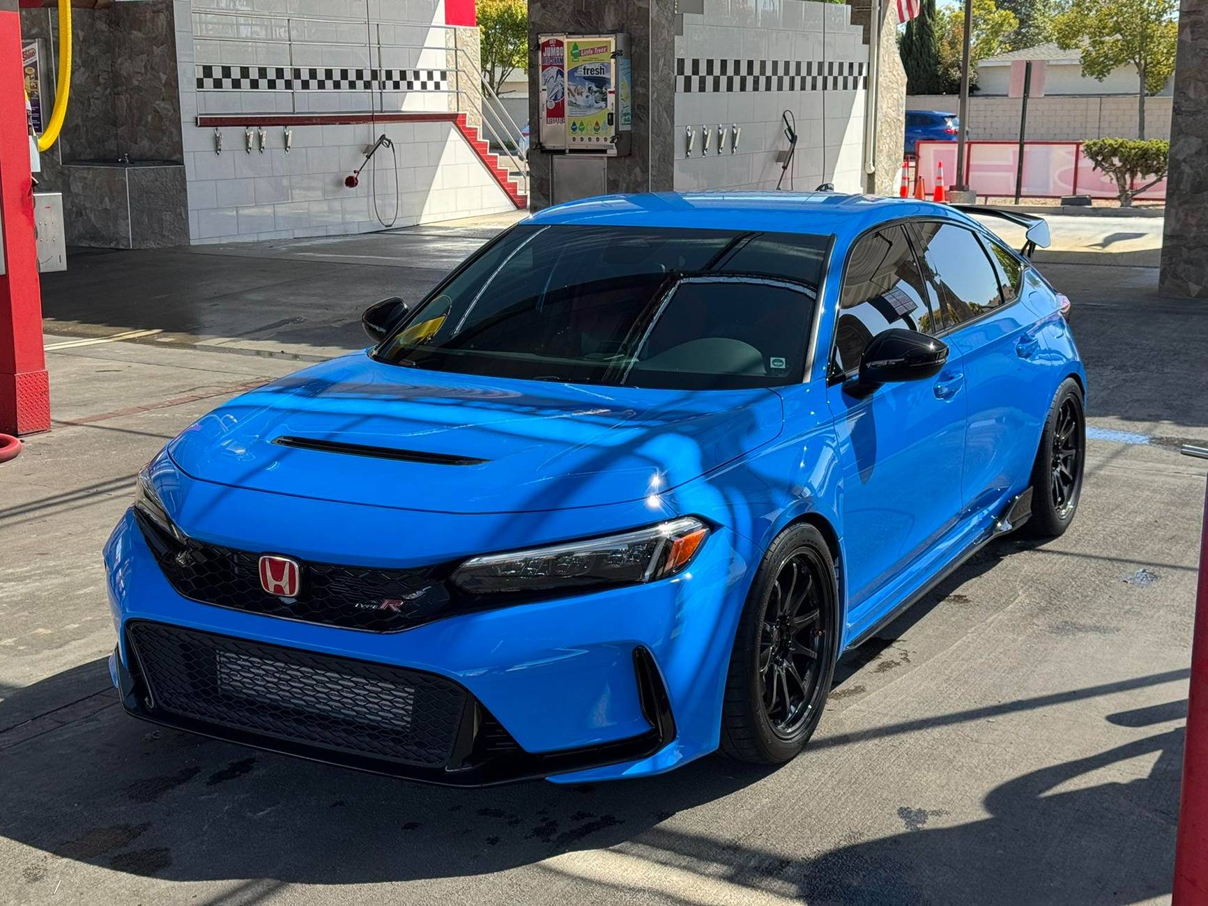

This is how she sits currently. -2.1 camber all the way around using rear camber arms on 18x9.5+38 275/35 tires. I will dial in fitment more tomorrow since the suspension has finally settled to get the perfect fit.
