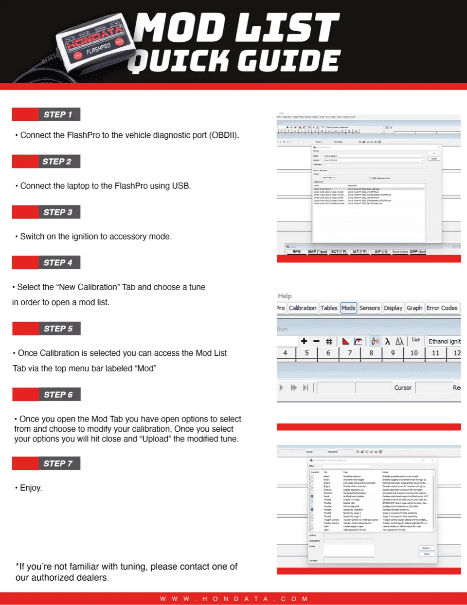

FlashPro Manager MOD List Quick Start Guide
Here’s one feature you probably didn’t know that can save you time and money!
Our Flashpro Manager software for the 2022+ Honda Civics have a Quick Mod list
section that allows you to make quick tuning changes. We’ve taken the time to
thoroughly test and tune certain parts that are simple and straight forward bolt
ons. This section helps you easily tailor “Mods” to one of our many preset
calibrations.
You can also download and get familiar with Hondata FlashPro Manager Software
for free. With the 11th Gen Civics being fairly new, be sure to always stay up to
date with our software versions. We are constantly adding additional features &
updates at no additional cost.
STEP 1:
• Connect the FlashPro to the vehicle diagnostic port (OBDII).
STEP 2:
• Connect the laptop to the FlashPro using USB.
STEP 3
• Switch on the ignition to accessory mode.
STEP 4
• Select the "New Calibration" Tab and choose a tune
in order to open a mod list.
STEP 5
• Once Calibration is selected you can access the Mod List
Tab via the top menu bar labeled "Mod”.
STEP 6
• Once you open the Mod Tab you have open options to select
from and choose to modify your calibration, Once you select
your options vou will hit close and "Upload" the modified tune.
STEP 7
• Enjoy.
Feel free to save the image for future reference or share with a friend.
