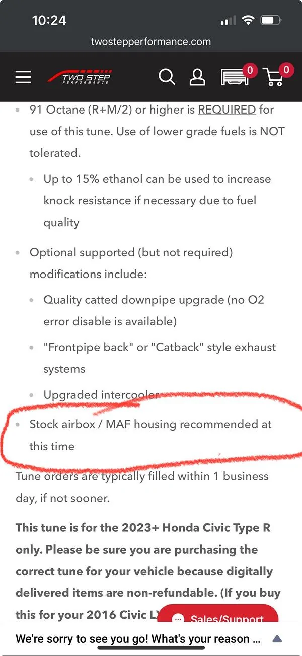

I don’t know much about the Phearable tune, but the TSP tune states stock airbox. If you have an intake, you’d likely need to get a custom tune. Here’s a screenshot:

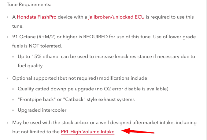

Interesting! I did not catch that. The Phearable tune has a section for listed modifications for which I'd imagine they adjust the tune per those mods. Not 100% certain on that though

Thanks for your interest in our tune. I'd caution anyone against comparing dyno results achieved by different cars on different dynos, apples to oranges.
I have nothing bad at all to say about our competitor's tune, independent testing has shown they are very comparable when tested using the same car / dyno / etc.
The PRL HVI and Intercooler are both safe (and encouraged!) to use with our tune, we have tested this combination and it works very well with no further adjustments recommended or required. The same can be said about a downpipe upgrade.
