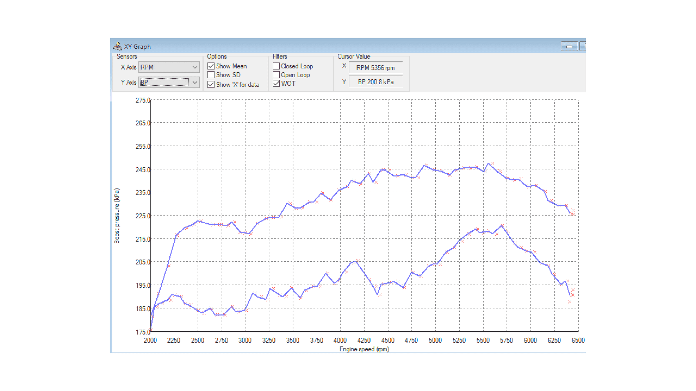

Boost
We display boost in kPa. This is the native pressure unit of the ECU.
  1. 0 kPa is the vacuum of outer space
  2. 100 kpa is atmospheric pressure
  3. 200 kPa is twice atmospheric pressure (14.5 psi)
Peak boost is not as important as area under the curve for the broadest possible power delivery.
11th Gen Honda Civic Hondata CARB tune - technical 22_civic_boost_stock_vs_carb

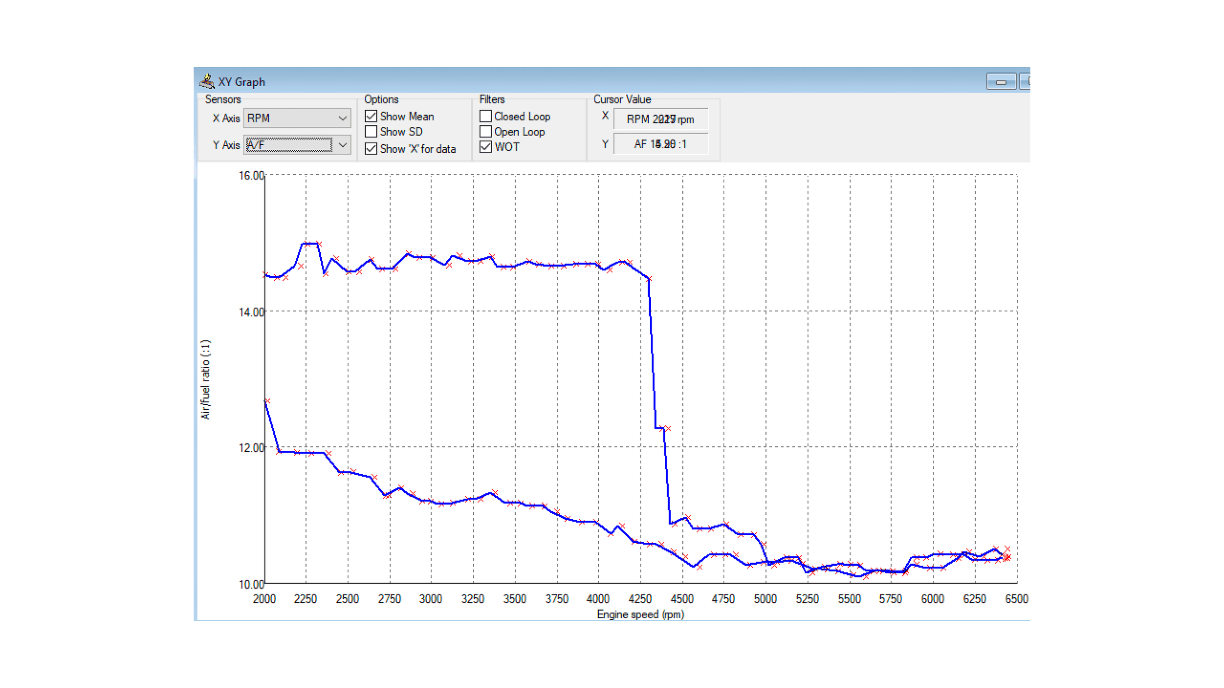

Airfuel
The 22 Civics run 14.7 air fuel until 4250 rpm wide open throttle for economy. We richen this for more power. Your MPG will drop at wide open throttle. Part throttle is unchanged. Just to be clear, normal driving, your economy is stock. Spirited driving will use more fuel.
11th Gen Honda Civic Hondata CARB tune - technical 22_civic_airfuel_stock_vs_carb

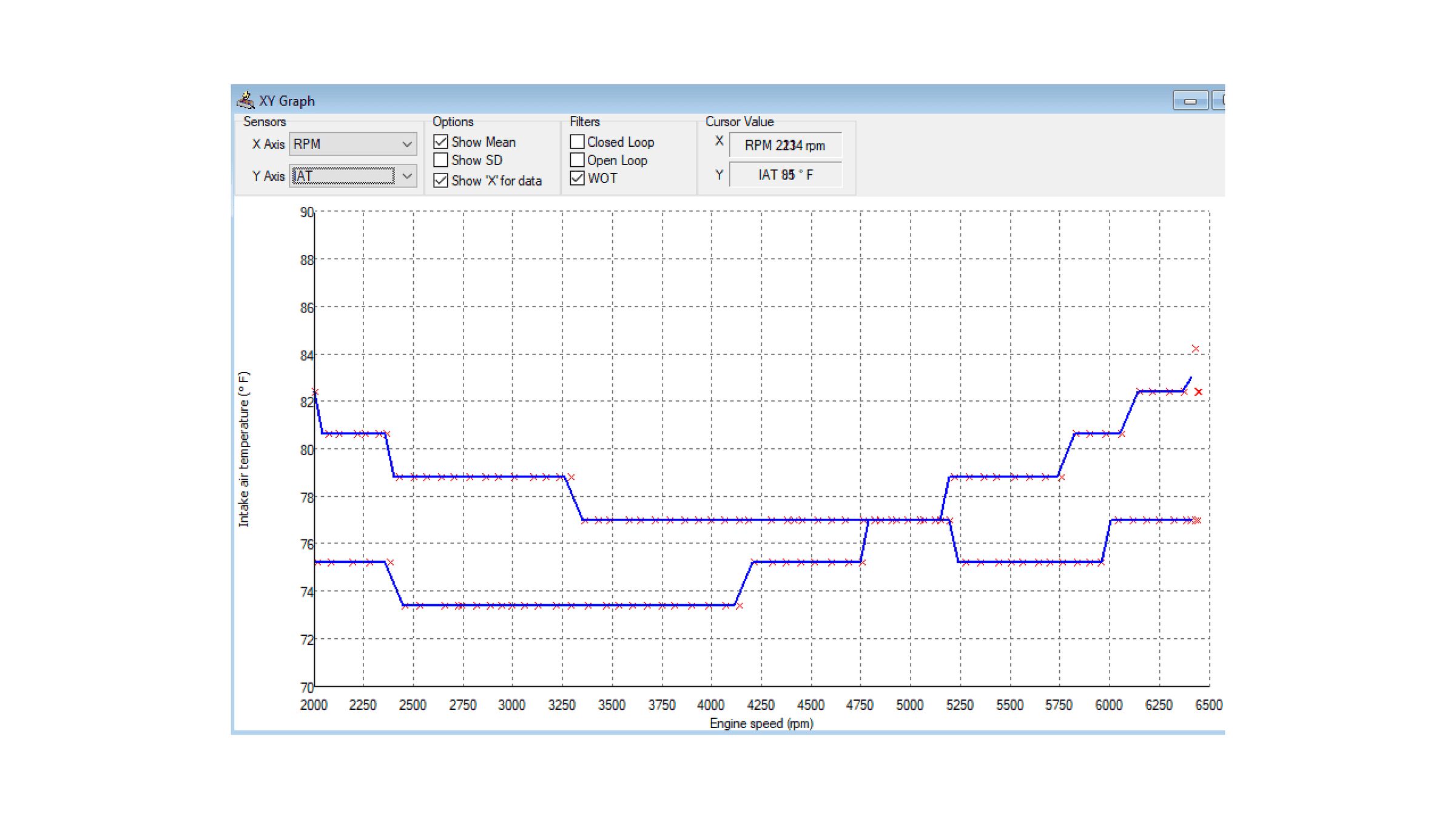

Air temperatures
Stock, the 22 Si runs 73-77F in warm southern California. Our CARB tune heats the intake air to 82F. 5 degrees F is 1% air density and power. A larger intercooler will help reduce the air temps, but depending on how you use your car, it can end up slower with a larger intercooler. A larger intercooler takes longer to fill with air, reducing throttle response. Honda in a 25 hour race reverted back to stock intercoolers because the car was faster out of corners.
11th Gen Honda Civic Hondata CARB tune - technical 22_civic_iat_stock_vs_carb_boost

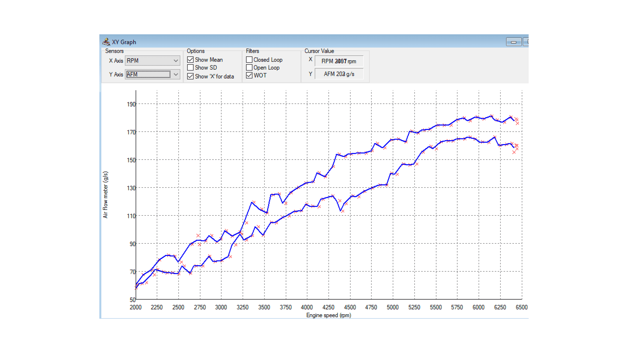

The road to more power is to get more air into the engine. This is measured in grams/second
11th Gen Honda Civic Hondata CARB tune - technical 22_civic_afm-maf_stock_vs_carb

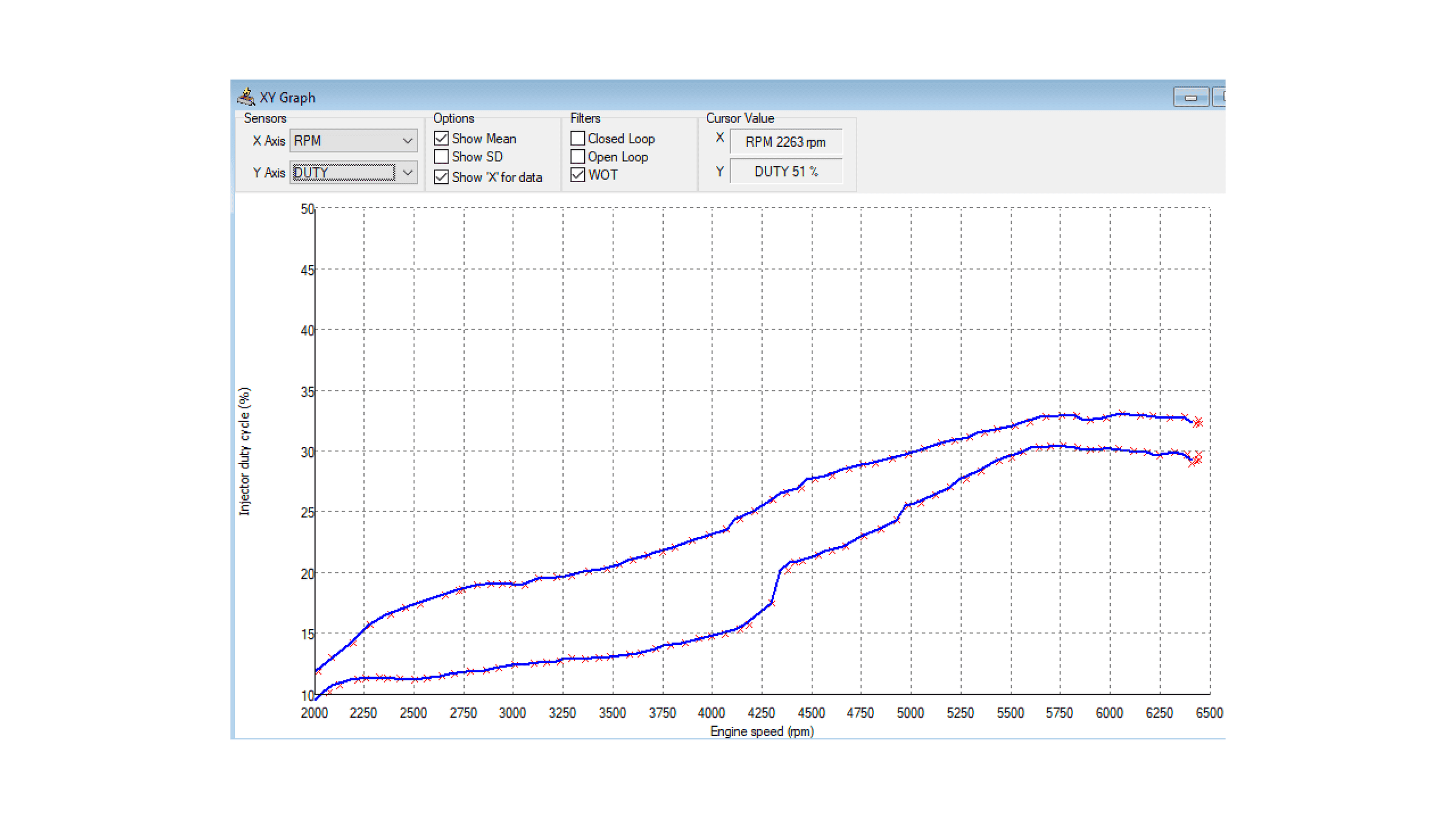

Duty tells us the percentage of injector usage. 30% stock, 33.5% boosted. You cannot exceed 50% or you will spray fuel out the exhaust or at the time the spark is firing. Either way, not good. E85 requires 40% more fuel really loading up the injectors. As this is a CARB thread, this is a discussion for another thread.
11th Gen Honda Civic Hondata CARB tune - technical 22_civic_duty_stock_vs_carb

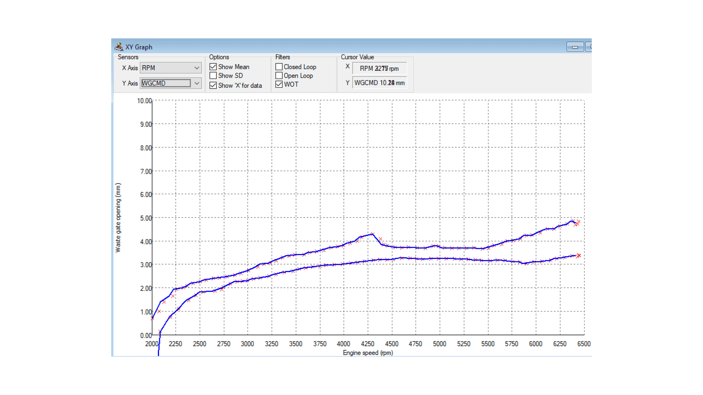

WG command;
Wastegate command, is the boost control. 0mm is fully closed where the turbo is likely overspeeding. This indicates the Civic in a race configuration has a capacity for more boost.
11th Gen Honda Civic Hondata CARB tune - technical 22_civic_wastegate_stock_vs_carb

Looking at each of the parameters above, it looks like the two lines represent stock and "tuned" data? If so, very interesting. Looks like there is a fair amount of headroom with tuning.

Yes, stock and highish boost, but not the maximum possible boost. So, yes, there is headroom. I'll go into detail on release.

Edit: Looking at the boost pressure graph, it looks like the turbo produced ~35psi of boost?! If I'm doing the conversion right from google: psi value = kPa value x .145

That’s not right. Looks to be around 248 kPa, which is ~ 18 psi.
2 kPa is around .145 psi.

Oggsr and Kullervo, here's the way you convert kPa to psi in terms of a turbo:
Start with 248 kPa. Subtract atmospheric pressure (100 kPa). So you're looking at 148 kPa which is 21.46 psi. Looks like stock peak boost was around 17.4 psi based on the graph.
Also if you look at Hondata's graph showing boost, it's odd how the Honda stock tune drops off noticeably from about 4200-5000 rpm until it builds up again. The Hondata tune seems to do a great job of fixing/improving that.

Ahh. Makes sense to start at atmospheric pressure and then go from there. Just curious, as altitude increases, does the ECU compensate overall lower atmospheric pressure?
