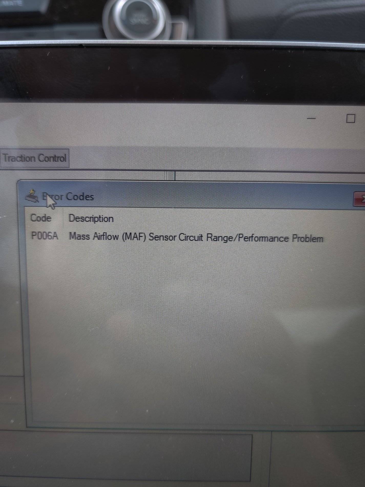

I figured someone here would know. It runs fine then this happens.

Do I need a new maf sensor?

Check that the intake is properly attached. When mounting the parts of the piping facing away from you (underside) it's possible to misjudge the alignment and cause a leak somewhere. Check that the MAF isn't fouled. Give the MAF a good soak of carb cleaner. Make sure the air filter isn't over oiled.

Clean your maf sensor if it happens again you need a new one. It would be a good time to check your intake see if anything is loose or looks bad!
