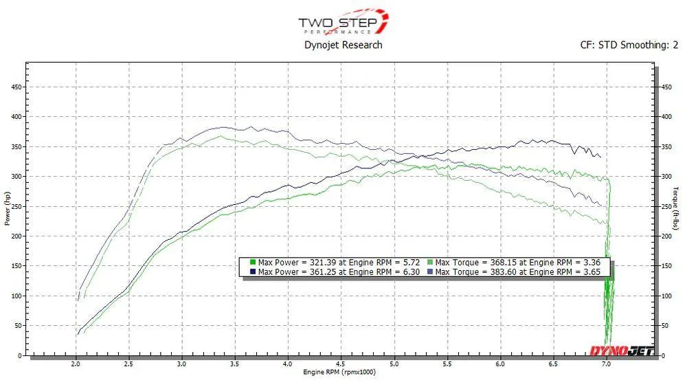

Here is the Hondata 93 base map compared to our tune:
Factory Tune - 306whp / 333 ft lbs torque
Hondata 93 Basemap - 321whp / 368 ft lbs torque
TSP Stage 1 for the FL5 - 361whp / 383 ft lbs torque
At the time of testing we noted that the Hondata basemap was using more boost to produce less power than our tune. 🤔

Same findings I ran into. About 1-2 psi less and still make more power. While also giving the fuel pump some breathing room.
