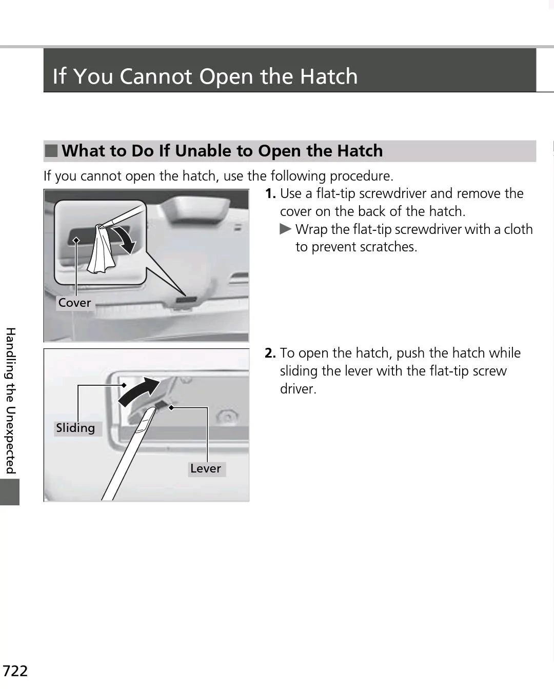

All you need is a screwdriver:
11th Gen Honda Civic How to open the hatch/trunk from inside car? Screenshot_20211219-103129_Adobe Acrobat
