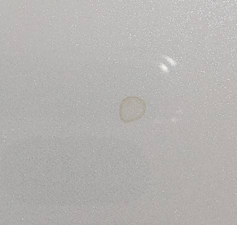

Hi folks. I recently noticed a small stain (about 3mm in diameter) on my new Honda Civic 11th Gen. I have uploaded a picture of it. I don't even know what has caused this stain to appear!
I have tried to wash it out with car detergent with no success.
Any help would be greatly appreciated.. Thanks!!

It looks like some sort of a chemical stain. A good Detailer (a person who maintains auto body paint/clean cars professionally for a living) should be able to take care of it.

I don't know if it's available in your market, but I've had good results removing chemical stains with Grojet 2000.

Your solution works! I used the Meguiar's Ultimate Compound to buff out the stain.. Had to use a bit of pressure but it works a treat! Thanks..
That's great and a pleasure to help!
