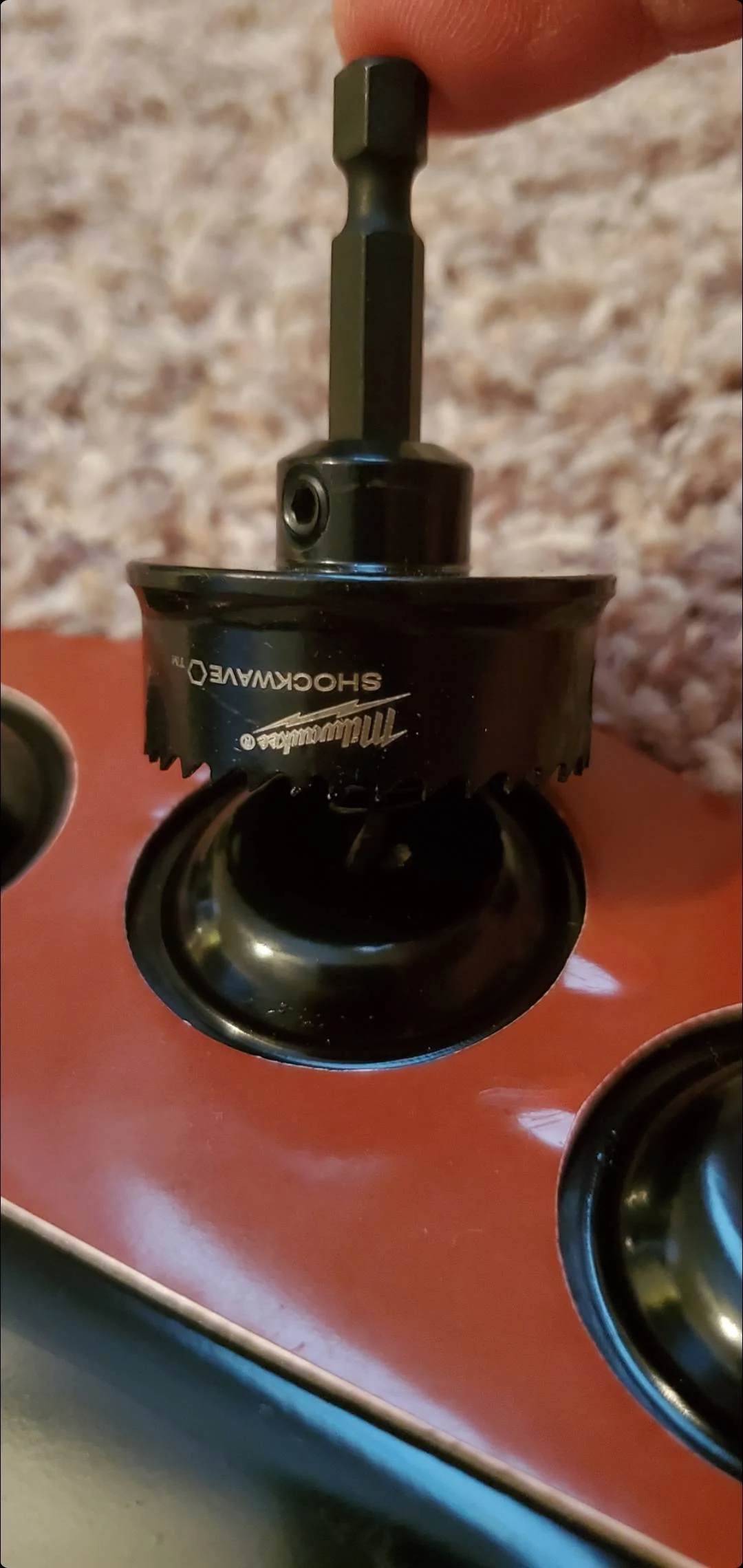

My investment in just the spoiler kit with tax and shipping was $356. So at $399 installed by Honda. I recommend everyone to have it installed at your Honda Dealer. But for your curiosity I'm going to share a few steps. Do keep in mind your Dealers will have also very little experience in this type of installation. ?? So inspect the area of the install for possible installation mistakes. ?‍♂

You only need touch up paint because of the hole saw. You’re only suppose to go in 4mm deep otherwise it will touch the vehicle body under the plastic piece you’re drilling. You cannot see this from the outside.
I didn’t need touch up paint on a couple holes because I was going slow, and if I did, it was only a small dab so that it won’t rust.

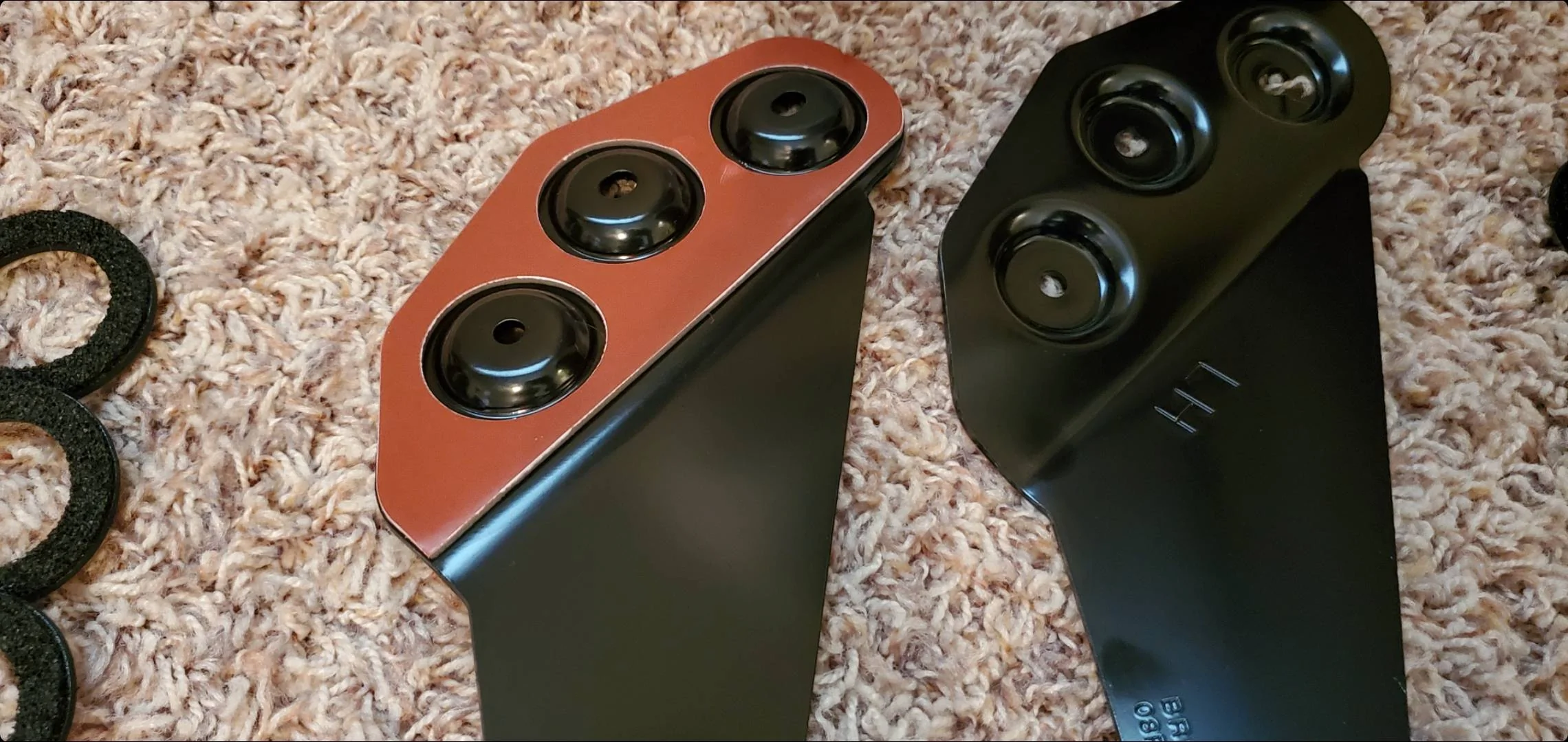

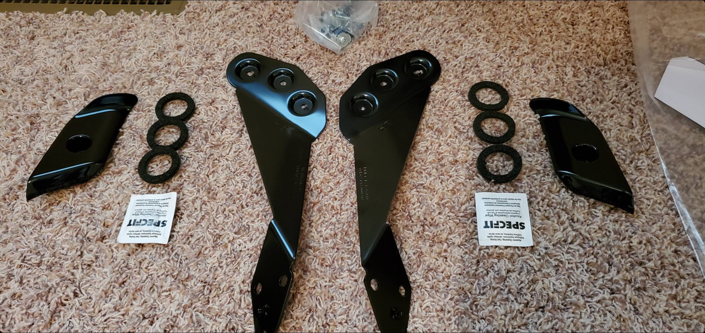

You got it. I am planning to "Not" use the Jacknuts as I don't have the tool. Looking into stainless washers and locknuts with removing the interior trim. Those jacknuts look really cheap and could have future issues. Plus if you strip one out? You're Ffffffff udged??

Looks like I'm ordering the darn tool. ?? To be continued... ?‍♂
