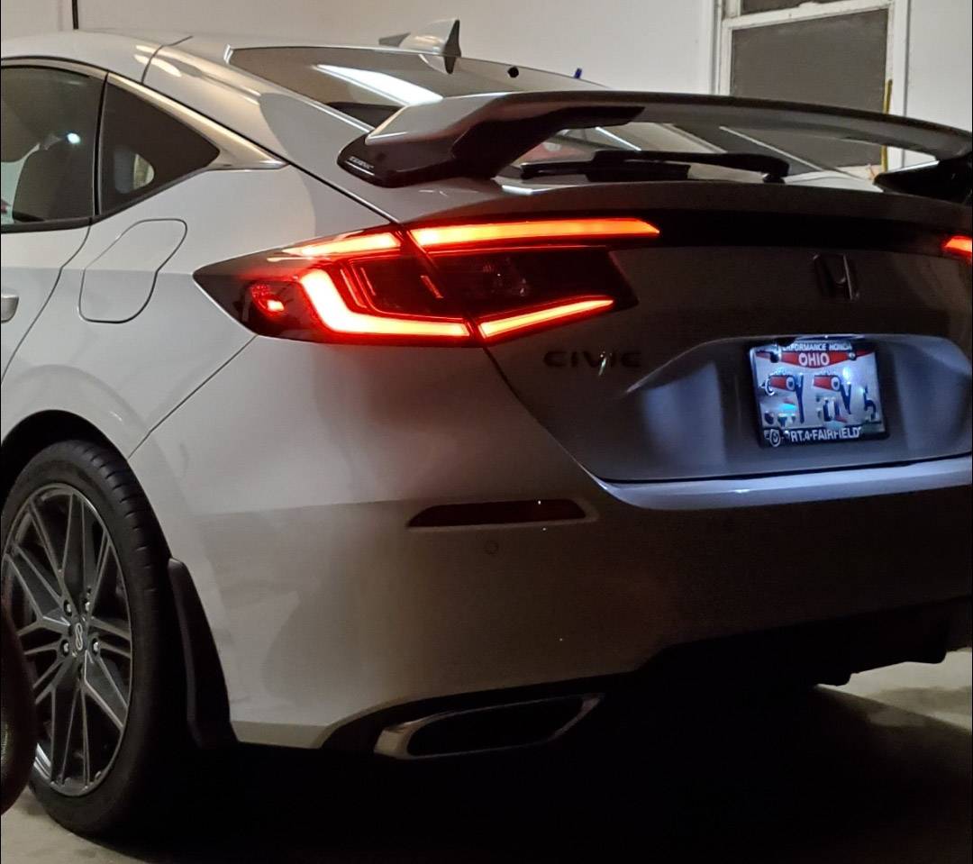

Well I did leave out a few things. Like the hatch shocks install upgrade that was included with the spoiler. Removing and reinstalling the hatch interior trim piece held with 2 screws in the handles. Kinds hidden. And I scrapped the rubber seals and put silicone adhesive because the space was very tight to work them in between the metals.
11th Gen Honda Civic HPD spoiler INSTALL on 2022 CIVIC HATCHBACK - DIY writeup & pics psx_20220102_003646-
Looks fantastic. BTW, what are your wheels????

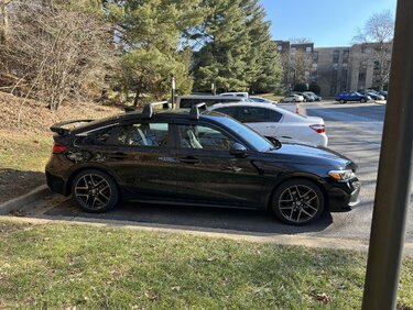

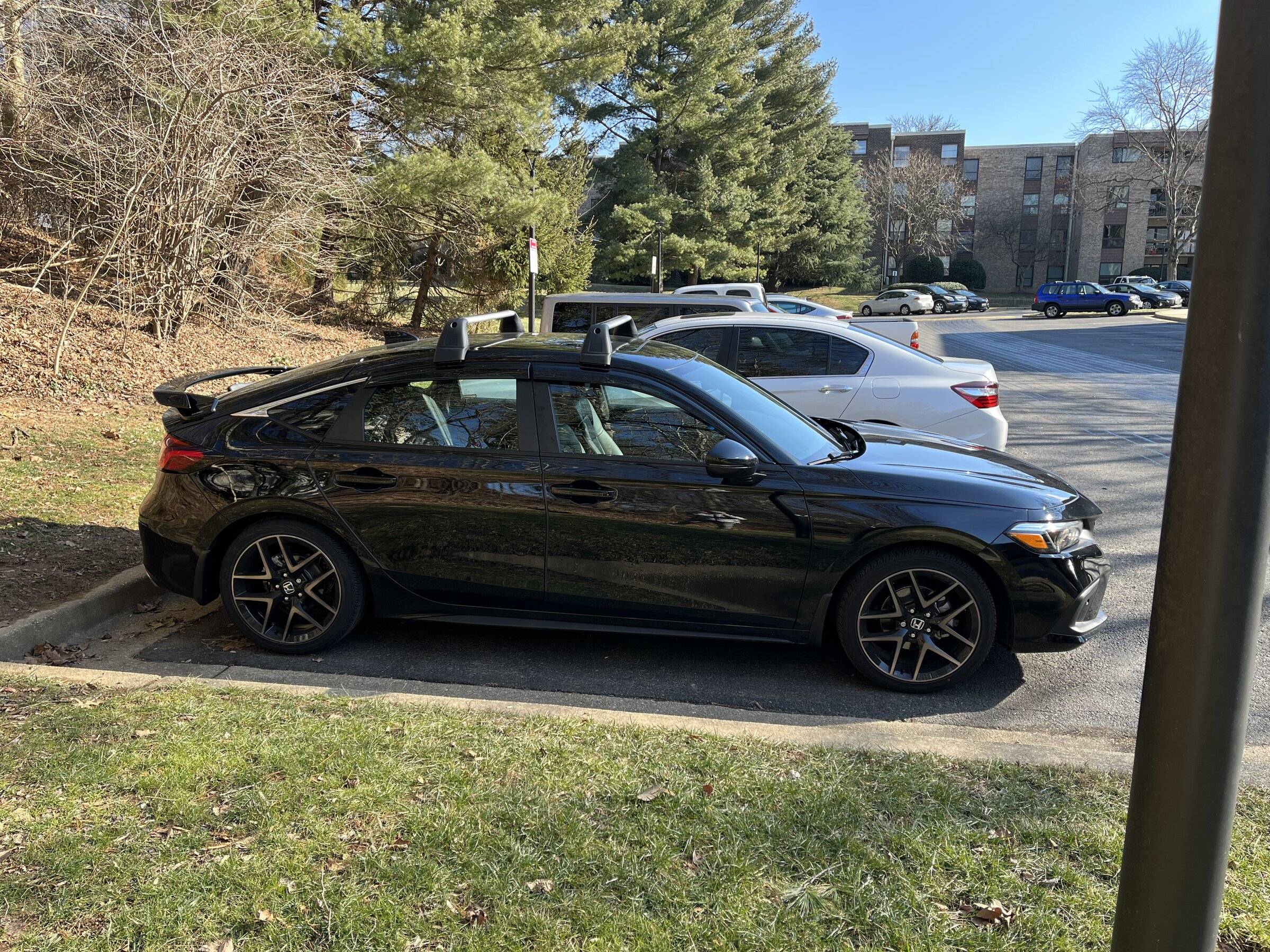

This is mine so far. Needs some tint/ and a little chrome deleted on the window trim and I’ll be satisfied…
Maybe ?
