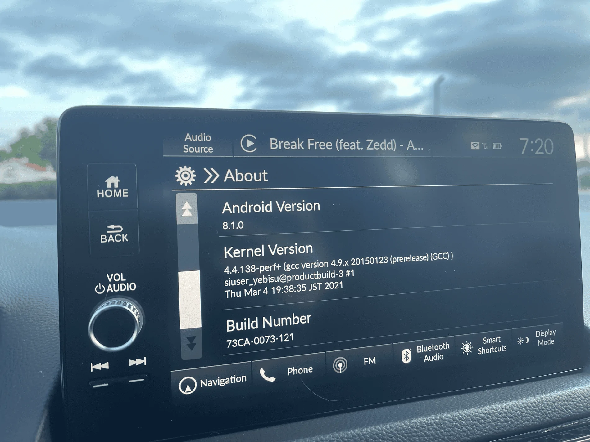

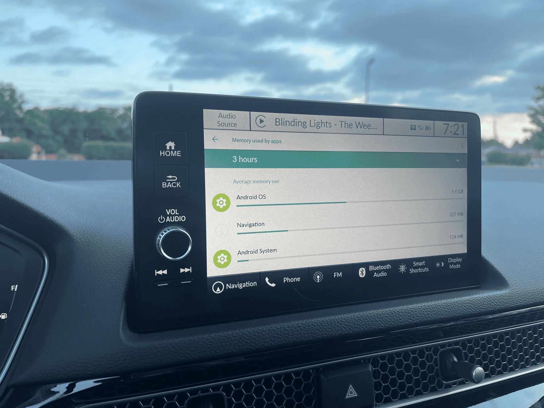

While I was trying to troubleshoot an intense lag issue when the car starts up, I found the infotainment system is running Android v8.1.0 (a 4 year old OS)
Tapping Build Number 10 times unlocks Developer Mode just like on Android phones and gives you other information like RAM usage. This particular unit has 4GB of RAM.
Here's some screenshots:
I may venture down the path of rooting just to see what all can be done on it!
