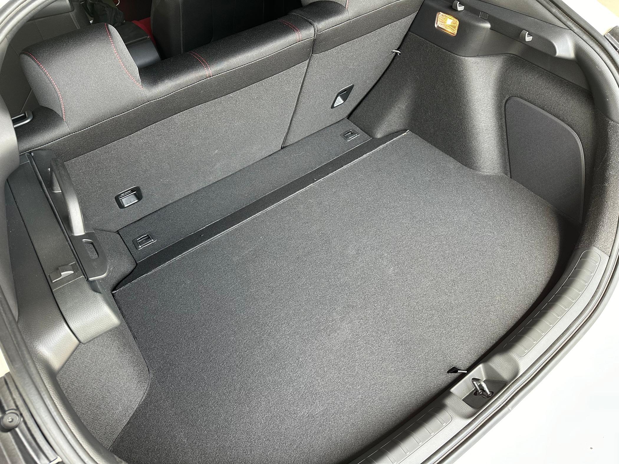

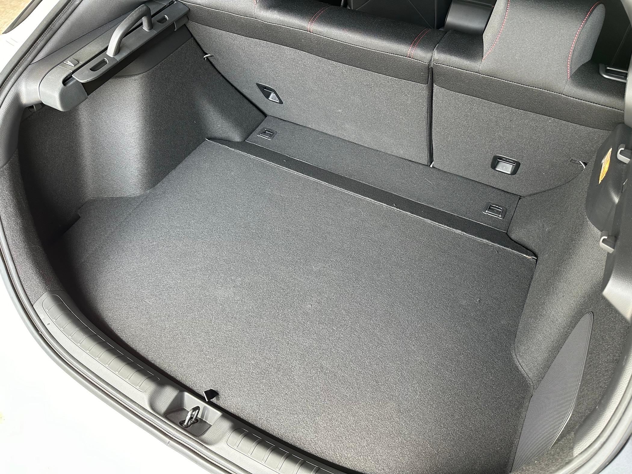

The finished product:
You might notice some cut seams -- those exist because I initially didn't think things would fit so I cut some pieces but they're now duct-taped back together :rolleyes:
11th Gen Honda Civic [Install Guide] Installing aFK8 spare tire and full kit in the FL5 IMG_3841

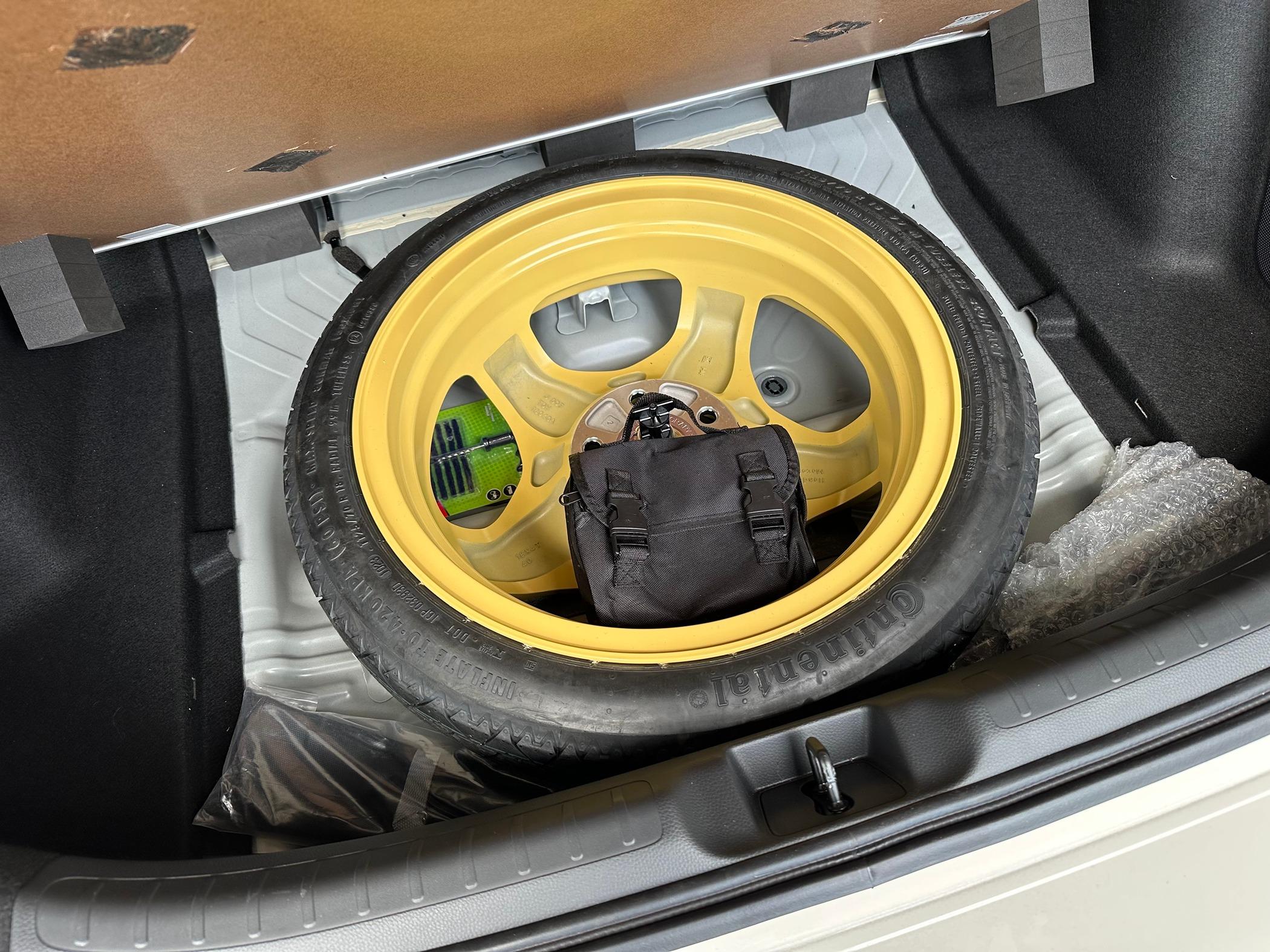

Fitment is perfect:
11th Gen Honda Civic [Install Guide] Installing aFK8 spare tire and full kit in the FL5 IMG_3842
Note: The spare tire kit comes with a jack, wheel removal tools, and a styrofoam tool holder but that last piece prevents the floor from sitting flush so I am not using that piece and just sticking the individual parts on the floor as you can see in the following photo. The little bag sitting in the wheel well is a compact air compressor from Harbor Freight.
11th Gen Honda Civic [Install Guide] Installing aFK8 spare tire and full kit in the FL5 IMG_3843

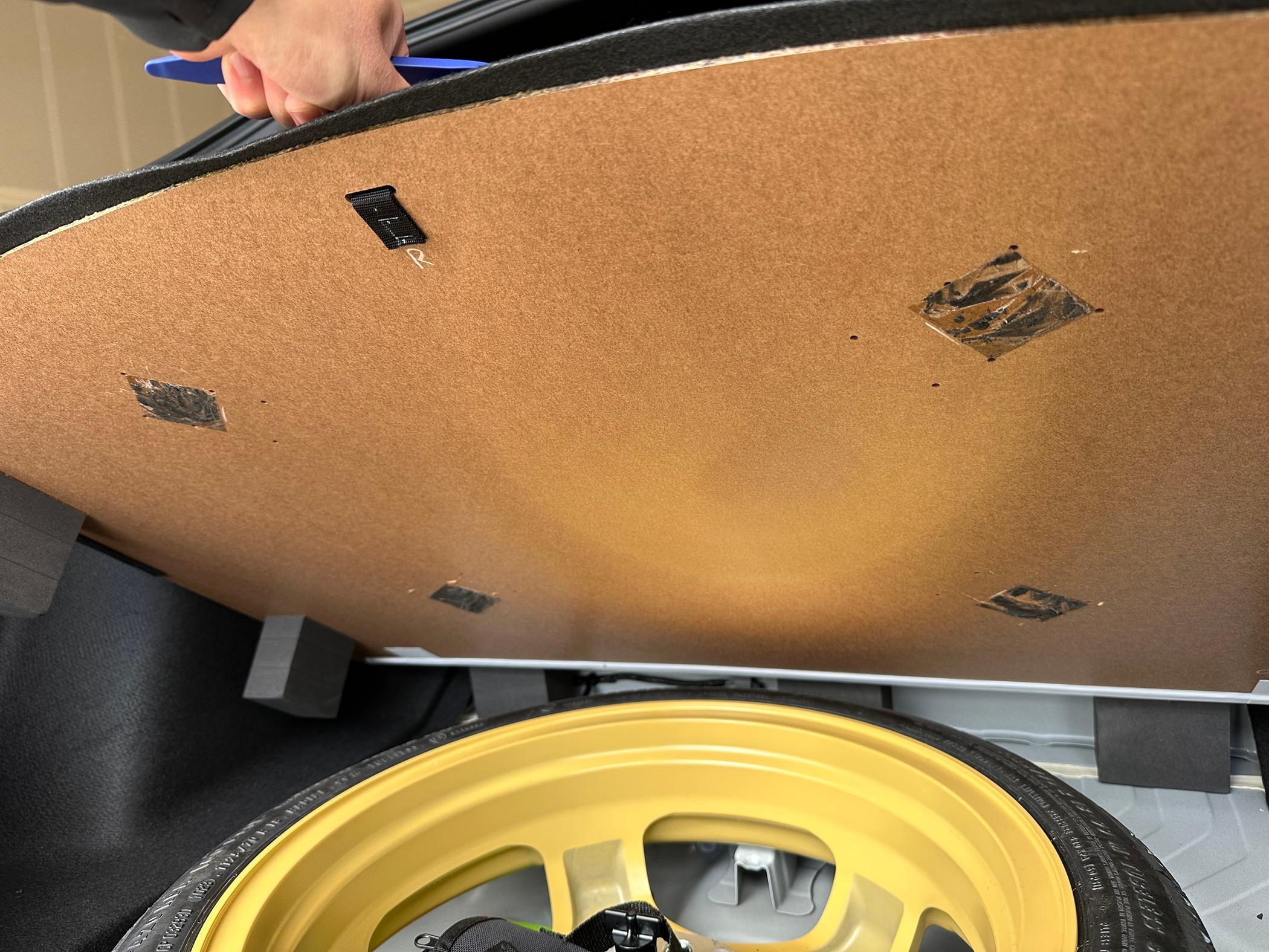

First we have to prepare the new floor to fit. There are four rubber posts that need to be removed from the underside of the FK8 floor. These are incredibly difficult to remove as they are held on by some strong epoxy -- I used an Exacto knife.
11th Gen Honda Civic [Install Guide] Installing aFK8 spare tire and full kit in the FL5 IMG_3845

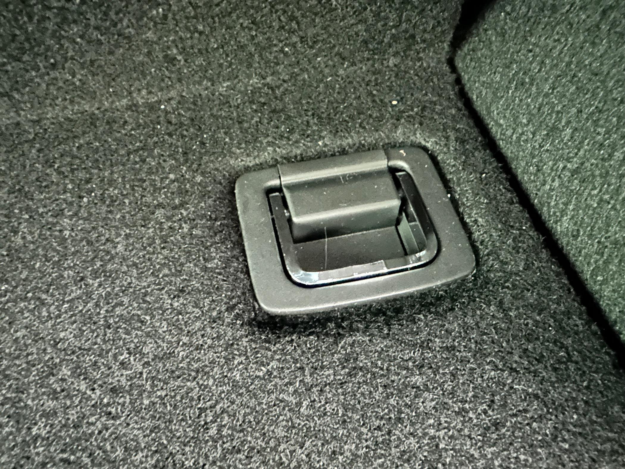

Open your rear passenger doors and fold the seat backs down. Locate the two metal tie down points:
11th Gen Honda Civic [Install Guide] Installing aFK8 spare tire and full kit in the FL5 IMG_3840

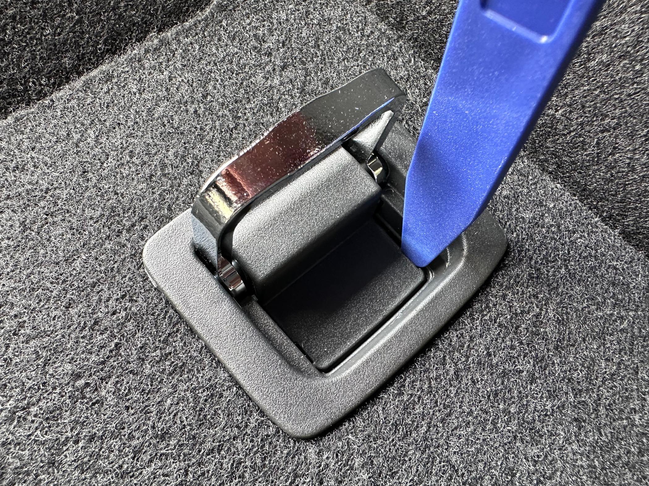

Flip up the metal portion, then use your pry tool to pry up the inside plastic piece. There are tiny indentations you can insert the pry tool into as shown in the photo below:
11th Gen Honda Civic [Install Guide] Installing aFK8 spare tire and full kit in the FL5 IMG_3844
After prying that up, use a Philips screwdriver and remove the screw within.
You can then remove the tie down piece by gently pulling up. Repeat on the other side, then set these pieces aside as they will be reused later.
The entire carpeted trunk floor assembly can simply be removed. Set aside -- this floor will not be reused.
Place the FK8 floor and perform the steps above in reverse. It's really that simple!

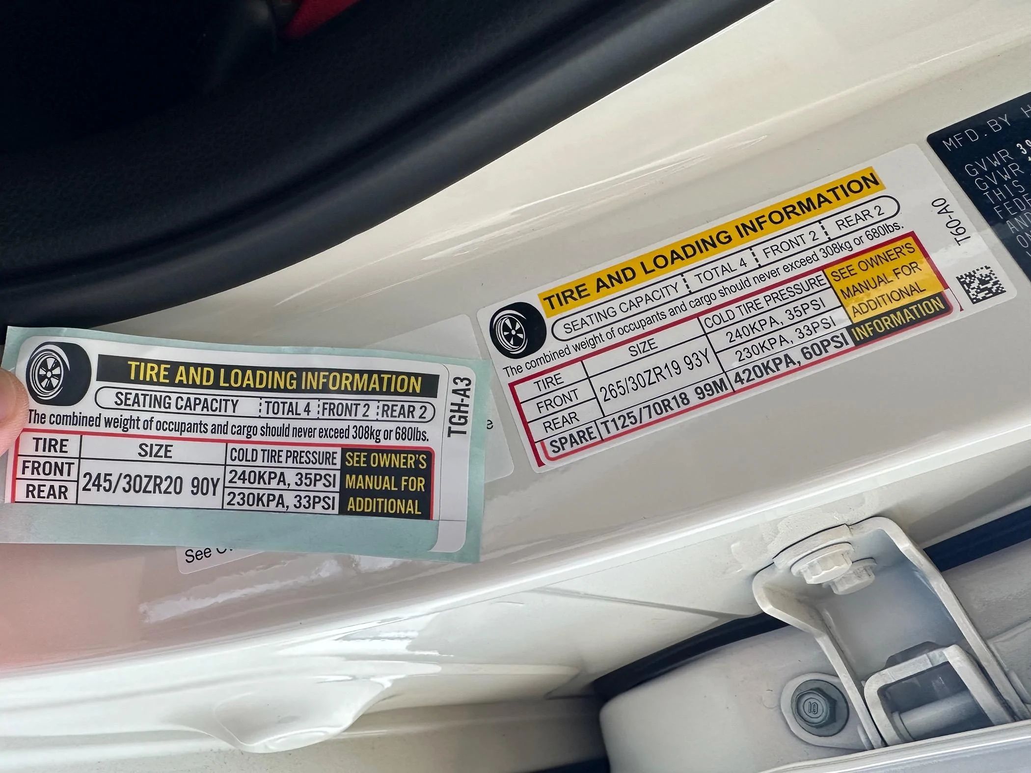

Bonus points:
The spare tire kit comes with some stickers. The FL5 door jam sticker actually shows “None” for the spare tire row so I just cut the portion from the FK8 sticker and applied it over.

@hhkb Just wondering could you not trim down the styrofoam tool holder down to make it sit flush in the spare wheel?
hhkb
hhkb
Sep 26, 2022
487
605
civic
Didn’t think of that but yes possible. Would have to trim off a lot though.

How much height do you lose?
Man, I traded my FK8 in with the kit thinking I won’t have a use for it anymore.
hhkb
hhkb
Sep 26, 2022
487
605
civic
It raises everything 5”. So whatever the surface area of the floor is multiplied by 5”.
