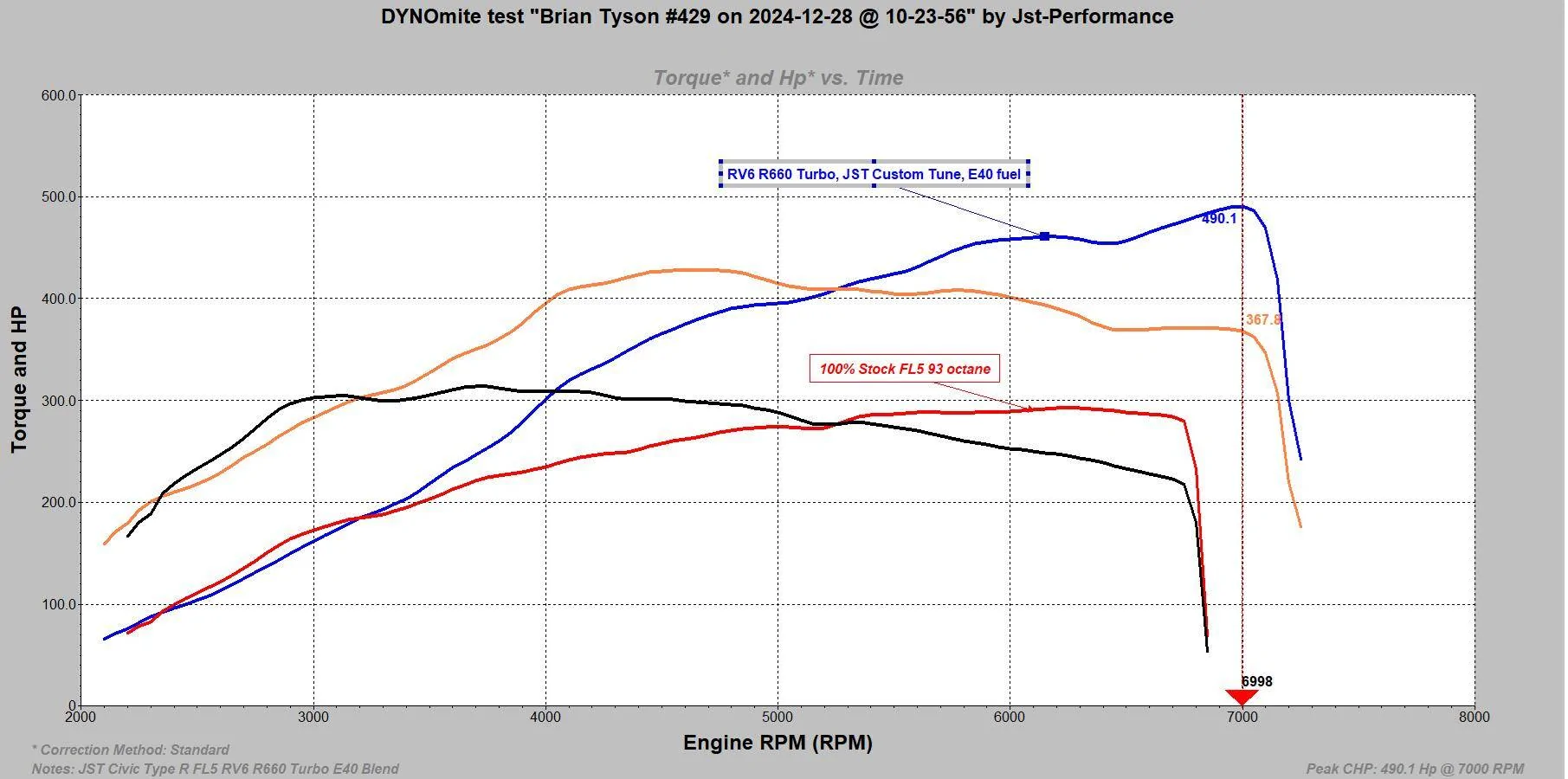

The software has only been out a few months, but its already twice as capable as it was on release. We went from having power limiting problems even while on the stock turbo and ethanol, up to now making near 500whp with an upgraded turbo and fuel system. To begin with, one couldn't run an upgraded fuel system. Now we have worked with XDI and have figured out what is needed to run XDI injectors and an XDI pump using Cobb software.

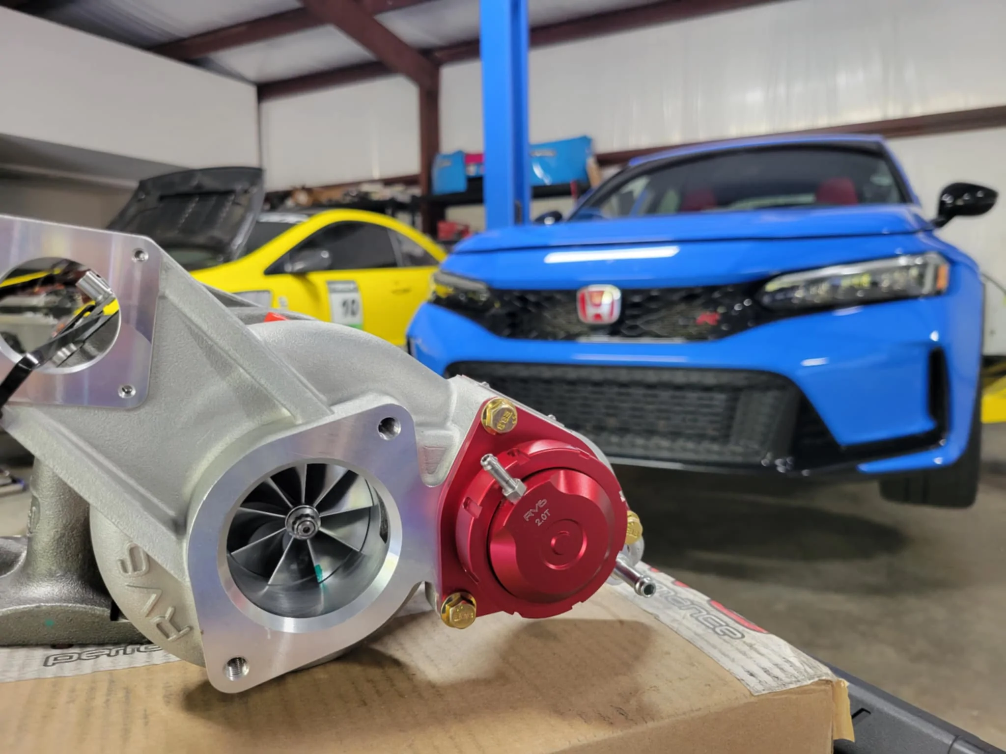

I installed this turbo on my car about 2 months ago and initially I wasn't very impressed overall with it compared to stock turbo/ ethanol blend. However after working with Cobb to unlock many new tables and higher rev limits, I am 100% happy with it, and I think its a great turbo option for pretty much any need.

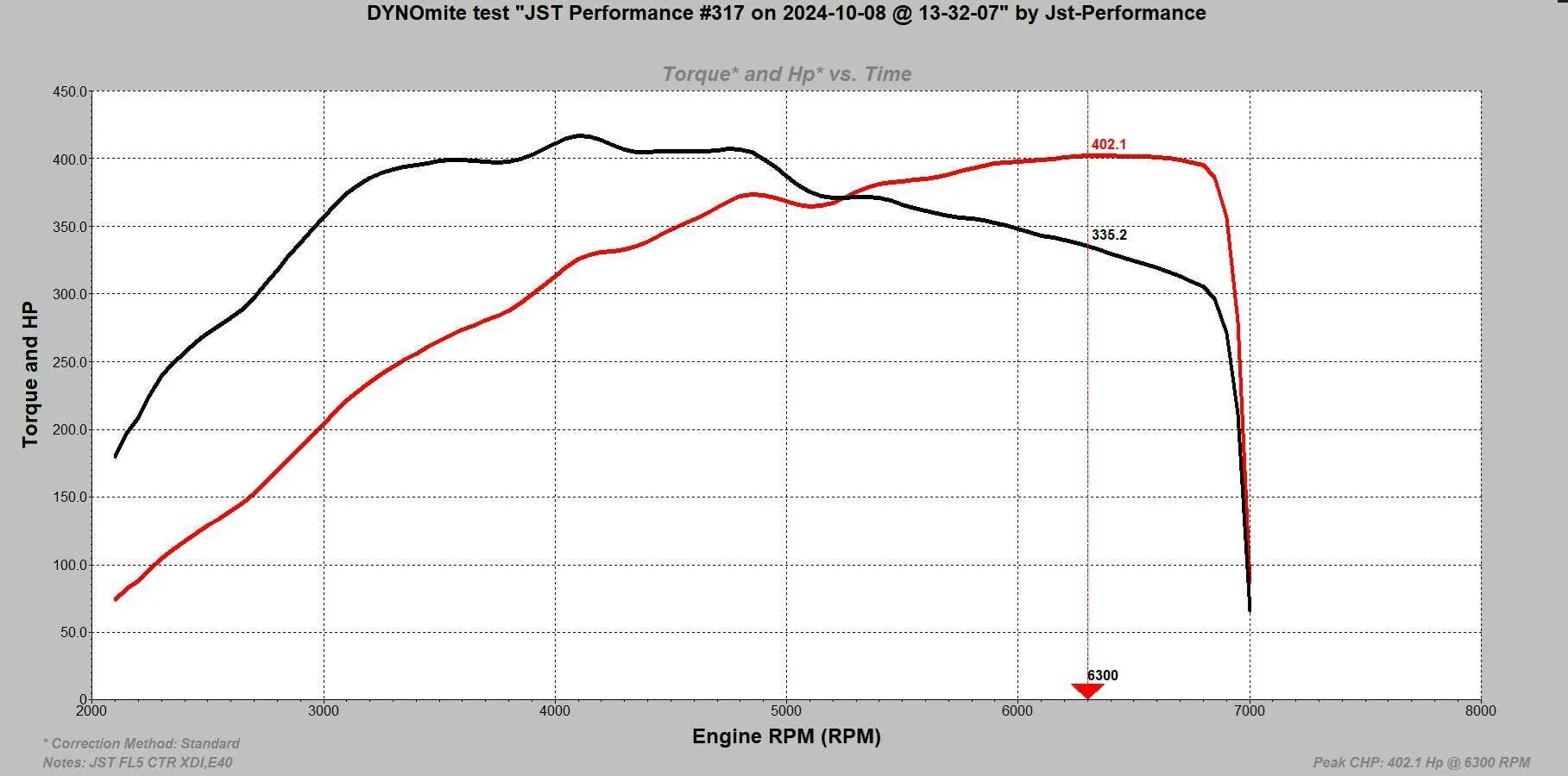

Initially the car only made about 420 whp, but was very laggy. I think at this point the car was faster on ethanol and the stock turbo. We weren't seeing peak boost until 5000rpms or so, and had to use the stock redline, so we had a very narrow powerband. Now the car hits peak boost well under 4000 rpms and we are running a 7400 rpm rev limiter. It seems we have no limits keeping this turbo from spooling at its best anymore!
My goal was to break 500whp on this setup, but we couldn't quite get there as we are currently limited on fuel. My car has an upgraded XDI fuel system, however I did not do the "line mod" so my total fuel flow is being limited by roughly 10% or so. I plan to pull the line back off and drill it, and install an RV6 front pipe that I already have as soon as I get a chance. This 490 WHP was made at only 25lbs of boost. With more fuel flow, we should be able to add a couple more PSI and hopefully see 500-520whp on this setup.
If you have considered using Cobb for your FL5 or DE5, there now is more reason to do so. As of September or October Cobb was really only good for nearly stock or mild bolt on cars. My car is proving that you can make plenty of power reliably using the Accessport and a custom tune from us at JST Performance.
