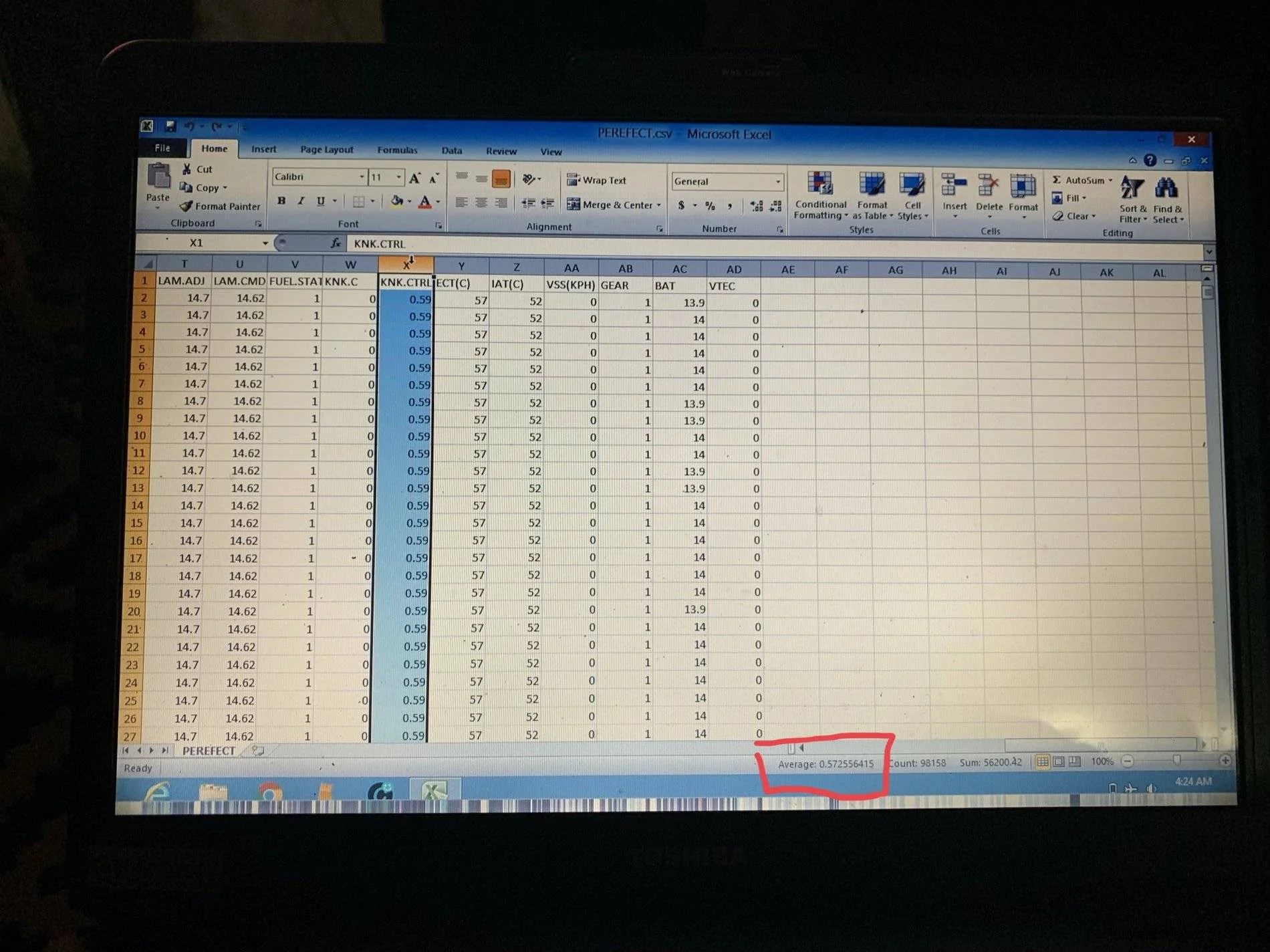

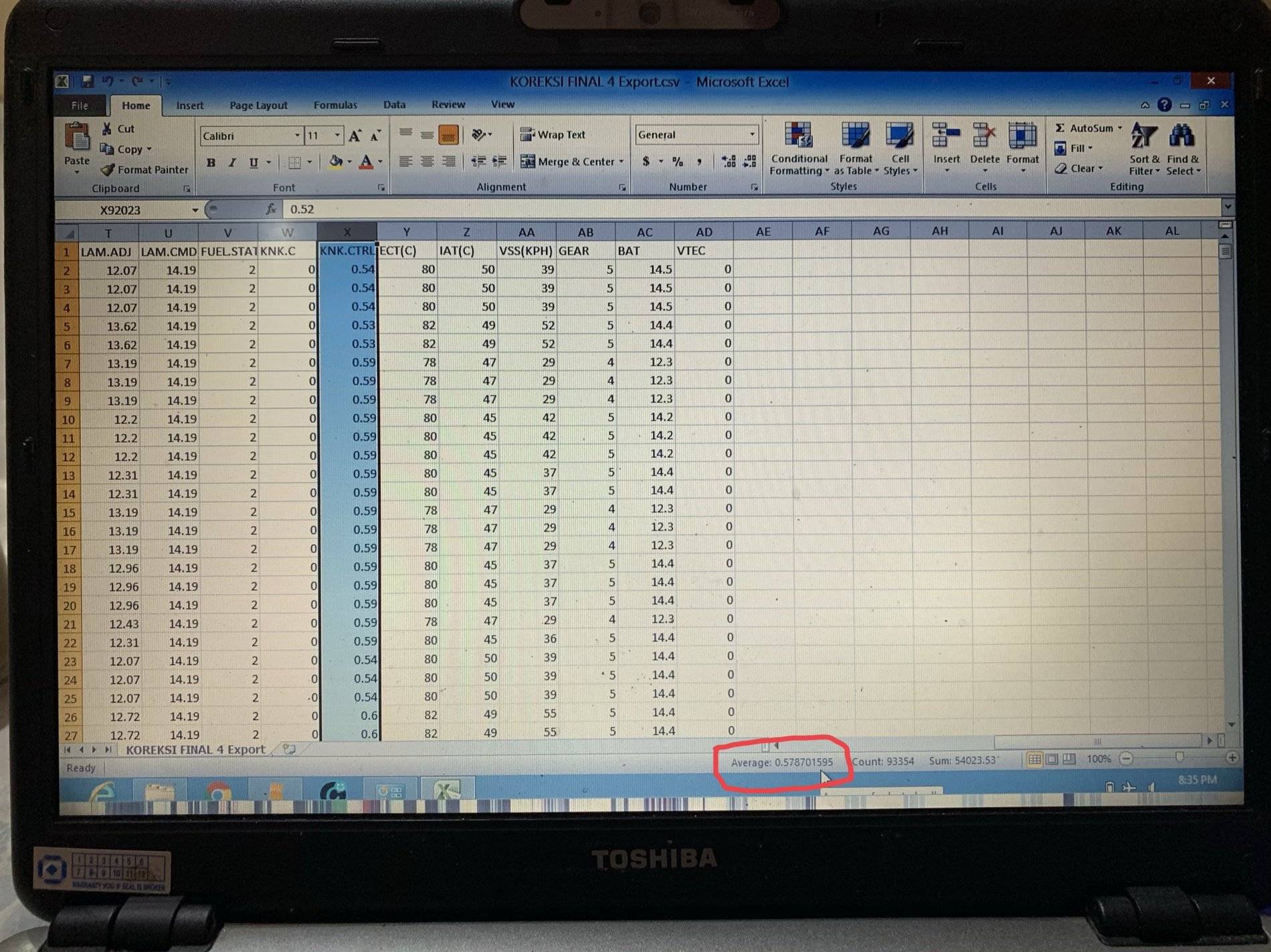

Thanks anyway, just finish record my datalog with my new Map (a bit change of my last map) :
1. Retarding ignition -0.2 just right inside RPM 1250-1500 and load 0.6-2.2
2. Fuel cut delay up to 42-44-45 for gear 3-4-5
3. Detail calibration MAF
Got so much improvement.
Knock Control average 0.57
STFT average 0.7%
Less Knock retard (never reach 10)
From almost 100,000 data and 58 minutes trip (35 km)
