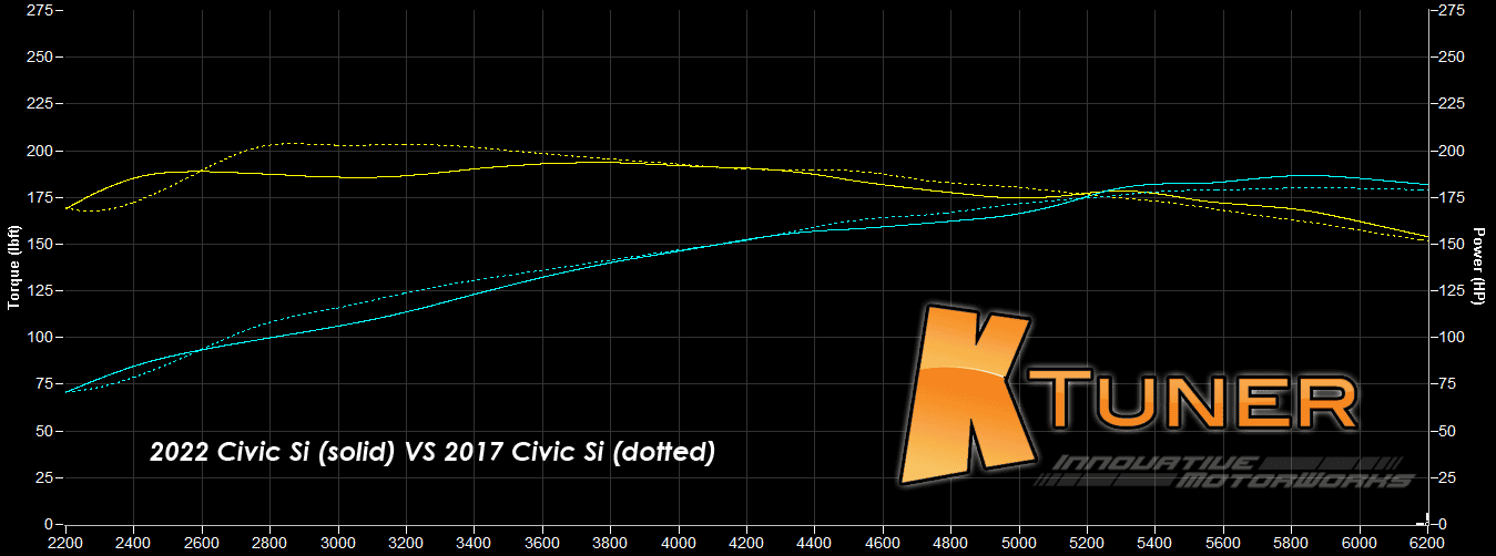

Huge thanks to @D-RobIMW for arranging the test car and dyno time! We started off with a brand new Civic Si that had 1000 miles on the clock, clutch fully broken in. Our factory run produced 186.4whp and 193.6lbft. The curve was very similar to the 10th gen, but down a little in the midrange and a little extra power up top.
Here's our real world comparison of the new 11th Gen Si vs the Previous 10th Gen Si.

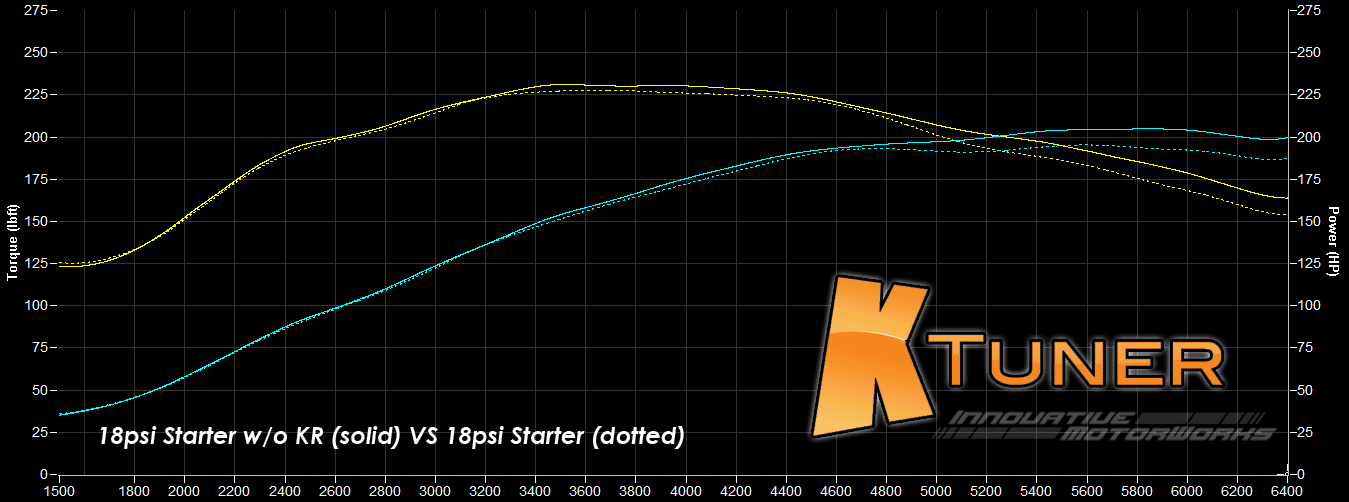

We immediately started in with a Stage 1 tune at 18PSI. We noticed right away that Honda was up to some new tricks with the Si. They actually implemented some of the same Artificial Knock Control Rise that we saw in the 10th Gen Non-Si models. We immediately had to remove that to get clean results and we've made this option available in the software as a checkbox. Here's a look at the 18PSI Stage 1 Basemap with the Artificial Knock Rise vs without for comparison.
11th Gen Honda Civic KTuner 2022+ Civic Si Tune Results - Fantastic Gains! 18psi_vs_18psi
With the Artificial Knock Rise disabled we had our final Stage 1 results. 195whp 227lbft. Gains of 7whp peak to peak with 30whp midrange, and midrange torque of up to 32lbft. A great starting point for those wanting a little more than factory without feeling like the vehicle is being restricted by limitations.

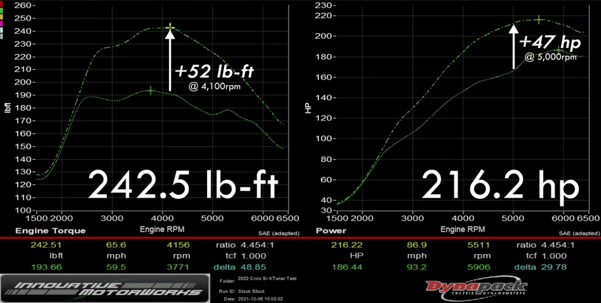

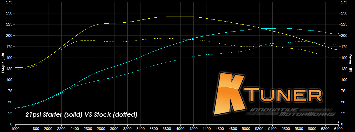

We moved on to Stage 2 development, which is our Starter 21PSI tune. This really changed the entire midrange and brought the top end to life quite a bit. Our results were 216whp and 242lbft. Gains of 30whp peak to peak with up to 47whp at 5000RPM, 49lbft peak to peak with up to 52lbft at 4100RPM.

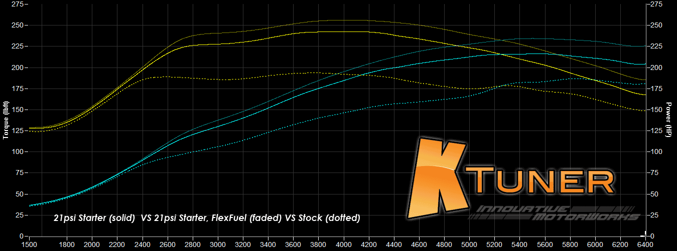

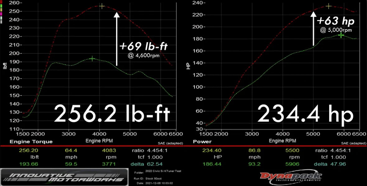

Having full support for flex fuel we dove right into ethanol testing on E30 for our included Flex Fuel Tune. If you have a Flex Fuel Kit installed you'll just need to enable the feature to activate this tune. It's already built in. With E30 our results were 234whp and 256lbft. Gains of 48whp peak to peak with up to 63whp at 5000RPM, 63lbft peak to peak with up to 69lbft at 4600RPM.
11th Gen Honda Civic KTuner 2022+ Civic Si Tune Results - Fantastic Gains! Starter21E30Gains
11th Gen Honda Civic KTuner 2022+ Civic Si Tune Results - Fantastic Gains! 21psis_vs_Stock
With the Stage 2 Starter 21PSI tune the car is just incredible over factory. Adding ethanol in it's a beast and we are still staying conservative for the longevity of the clutch. Both TSP and Phearable have already begun their tune development. Other tuners can also step in for custom tuning to get you the maximum potential of your specific setup. We're excited to see what results you'll all be sharing with the 11th Gen community!

interesting so overall the 11th gen makes less power tuned than the 10th gen?10th gen TSP Stage 1 makes 237 WHP and 280 WTQ vs 11th gen Flex fuel tune making 234 WHP and 256 WTQ
You're comparing the included KTuner calibration results to third party calibration results. :) The 11thGen "Flex" calibration makes similar power to what the 10thGen "Flex" calibration did on the 10thGen. These files are meant to be safe for mass consumption over a wide range of operating conditions, not meant to be be-all, end-all powerhouse files. They are starting points.
I made more power than what's shown on those plots with further tuning, but have to continue testing before I release the TSP1 for the 11thGen Si.
