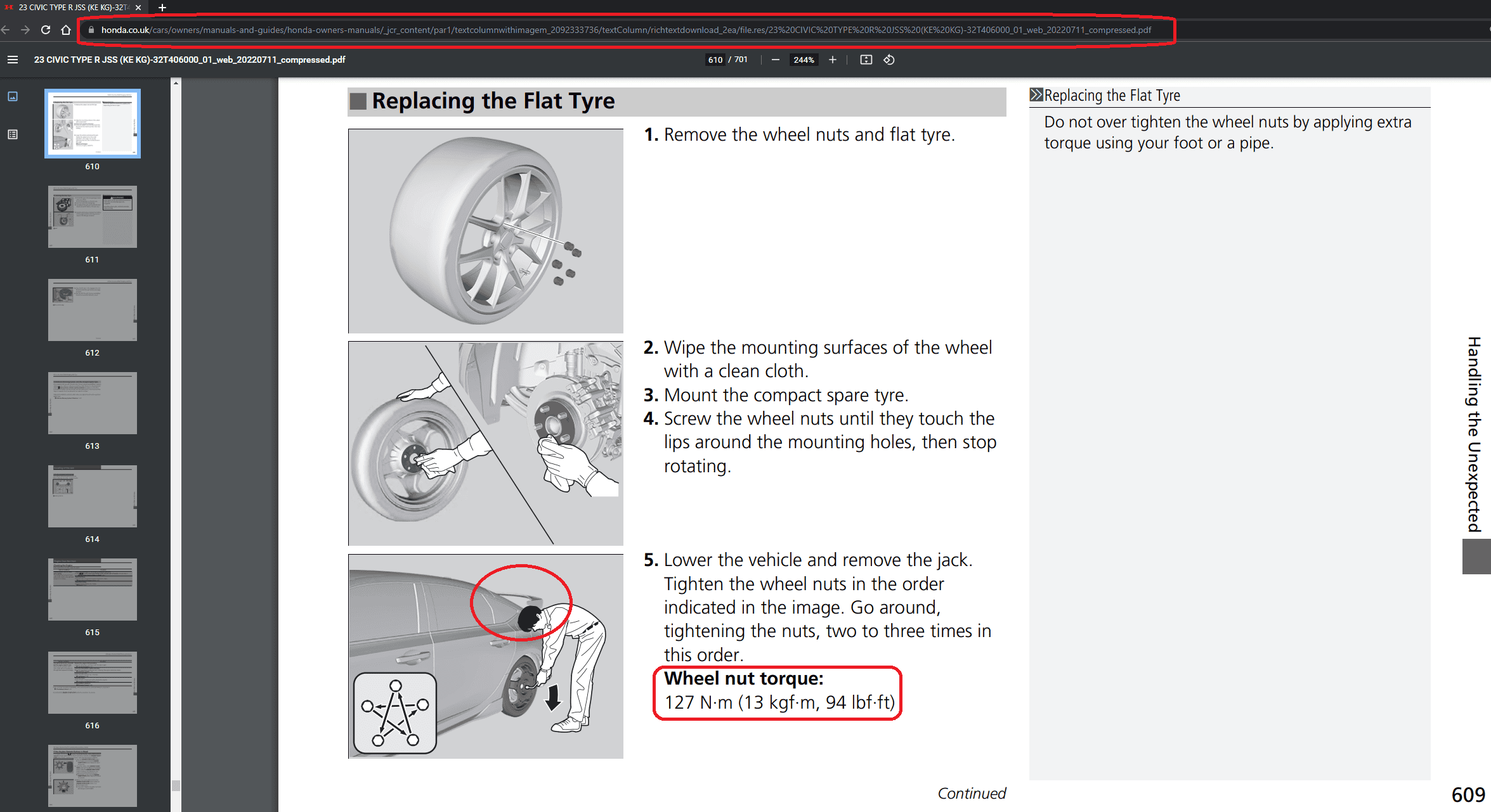

Are you willing to re-torque all of your FL5's lug nuts to 80 lbf-ft and go track it? US/Canada manuals says 80. But UK manuals says 94...see that wing behind the dude??? Are you telling me the geographical difference warrants from 94 (in UK) to 80 (in NA)? It's the same damn car. Check out the link/PDF yourself....
Comparing an older FK8 spec is NOT meaningless, it's called sensible thinking and ask questions - Stay open minded.
2023 FL5 UK Owner's Manual

I'm assuming 94 is the correct figure, but I would confirm from the horse's mouth on this one.
Different wheel usage shouldn't be a factor, since you would follow the recommended torque specs for a given car, regardless of which wheel you would use (OEM or aftermarket). But someone can correct me. So the wheel isn't a variable.
UK FL5 manual states 94. US generic hatch manual says 80, with no differentiation between the CTR and lesser models (unless it applies to all models which isn't likely), so probably an oversight they missed before it went to print. And FK5/FK8 hub and suspension designs aren't all that different. So logically, probably 94.
