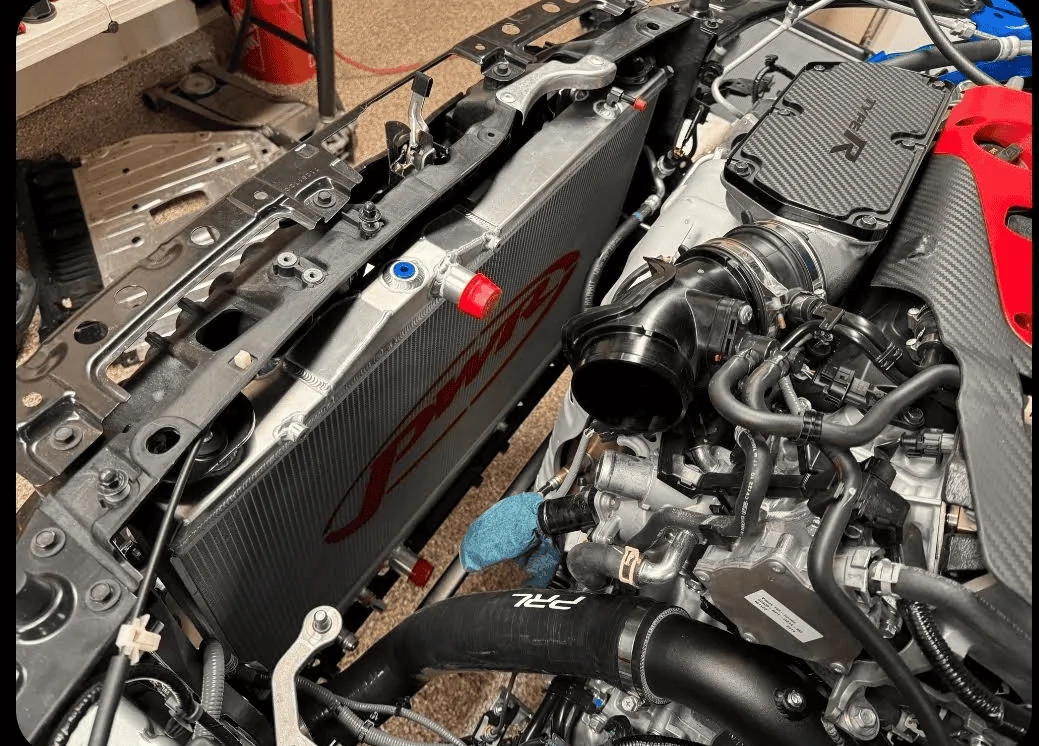

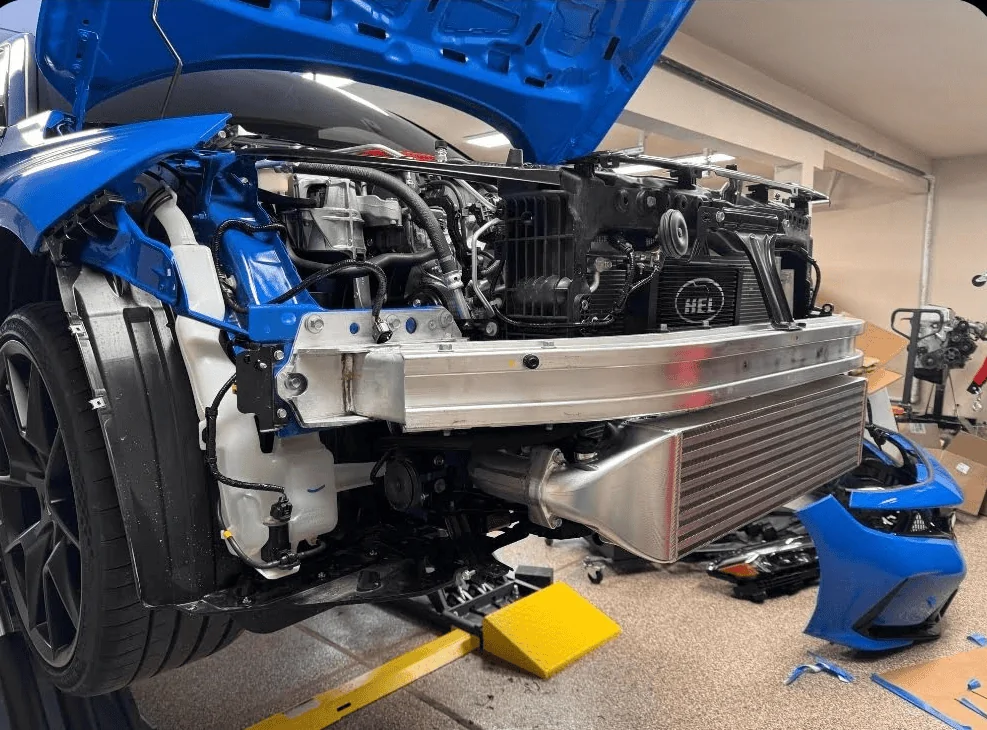

I've made several modifications to my Civic Type R (2,847 miles) , installing the following components:
  • HEL Performance Oil Cooler
  • PRL Intercooler
  • PRL Charge Pipe
  • PWR Track Radiator
  • Acuity Super Cooler Reverse Flow Silicone Radiator Hose

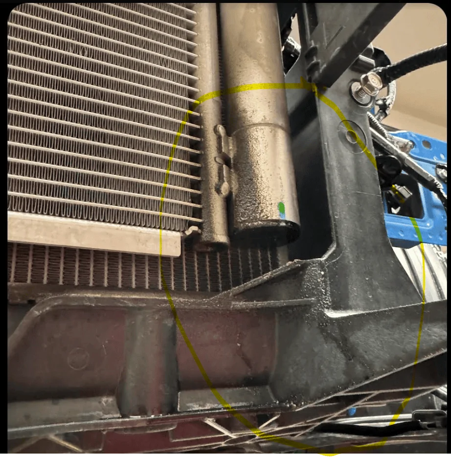

Initially, I discovered a leak in the AC condenser and promptly scheduled a service appointment with my Honda dealership. At the time of scheduling, everything appeared normal with no warning indicators.

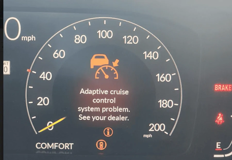

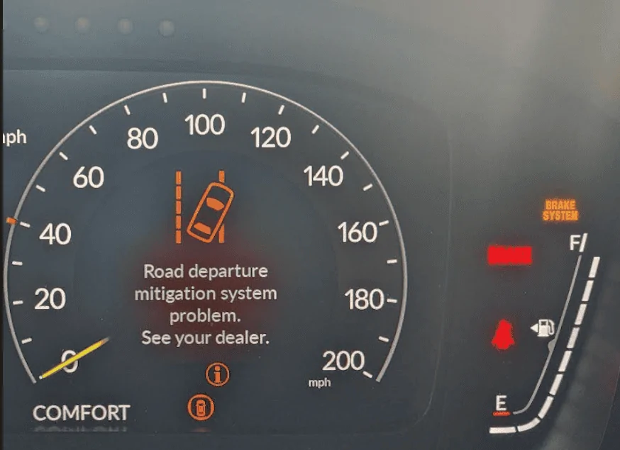

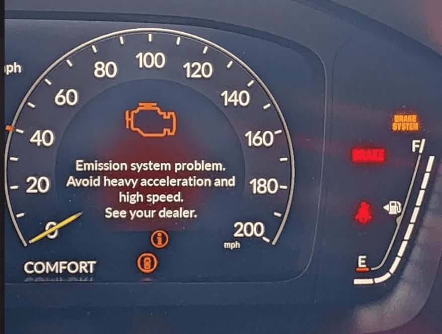

However, a week later, on the day of my dealership appointment, upon starting the car, I was greeted with a series of warnings: issues with the Adaptive Cruise Control system, Emission system, Road Departure Mitigation system, and Brake system.
After the dealership checked my car, the service representative assured me that they had resolved the problems. Upon my arrival at the dealership, however, the representative I had spoken to initially was no longer available. Instead, two other service staff members inquired if I had been briefed on the problem. I informed them that I was told the issue had been fixed and that I should collect my car.
One of the service staff members then explained to me that the problems likely stemmed from the modifications I had made to the car. They even mentioned that I had removed one of the radiator fans due to my modifications, which they claimed was the reason for the missing fan. Ironically, the Type R model comes with only one radiator fan. I chose not to argue, realizing that they were simply conveying information from documentation.
After clearing the error codes, they returned my car to me. Does anyone know the significance of the "2847 code - for ECM/PCM malfunction"?
Has anyone else encountered similar multiple issues?
Regardless, I am quite disappointed with Honda.
Below are some accompanying pictures:
11th Gen Honda Civic Multiple issues after installing oil cooler, intercooler, and radiator 1713676923865-j1
11th Gen Honda Civic Multiple issues after installing oil cooler, intercooler, and radiator 1713676910871-ov
  • PRL Intercooler
  • PRL Charge Pipe
AC condenser leakage:
This car is very sensitive and will throw check engine lights for little things. Do you have any codes right now? And if so what are they? Do you have a scanner or hondata?

Nevermind, you did the PRL charge pipes, so you would have needed to remove the battery for the installation. I'd recommend buying a cheap code scanner if you don't have one already. I also suspect, as I've seen this before, that you may have a boost leak, and this will certainly cause a check engine light. The clamps for the PRL kit have to be really tight against the silicone hoses in order to keep them from leaking. Soapy water and a boost leak tester would do the trick for locating a possible leak should the code return, and I suspect it will return.

Starting the vehicle after power loss will also begin an initialization process, and you will see those lights. If you drive it for a little and, at times, turn the car off and back on afterward, it will clear.
