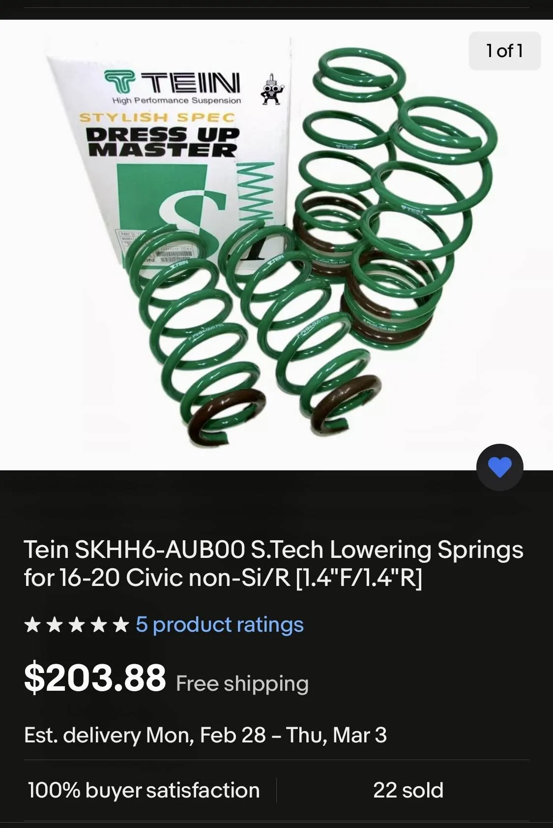

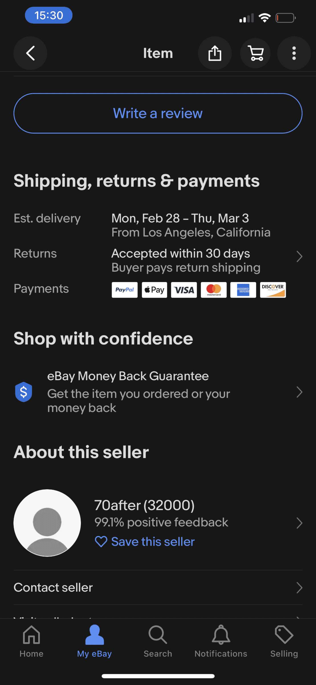

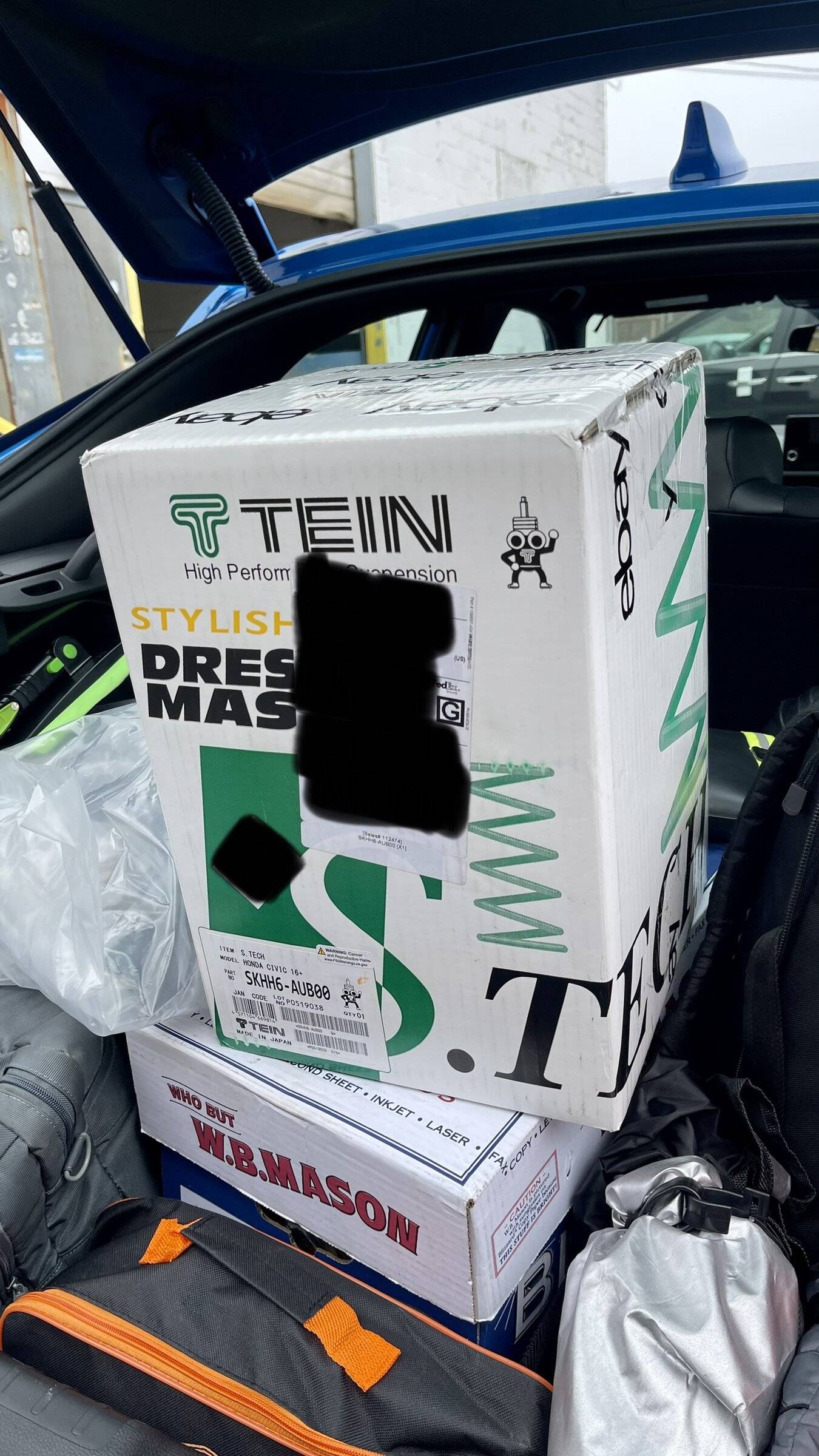

I just pulled the trigger on the Tein S-Tech springs from eBay which happened to be the cheapest price I was able to find. Came to $221.46 after tax, and free shipping. I try to avoid eBay as much anymore bc it’s flooded with nonsense, but I felt confident here. Can’t argue with THAT much positive feedback DAFUQ??!!????
Pics below:
but anyway, so I’m gonna install these probably end of March, early April, once the 60° weather is more steady by me. Hoping the oem shocks hold up nice for awhile until I can order the Enduro Pro Plus OE shocks from Tein also. Hopefully by summer I’ll get those and the BBK from 27WON, then summer wheels & tires, etc etc. who knows…
Either way… guess it all starts here.??‍♂

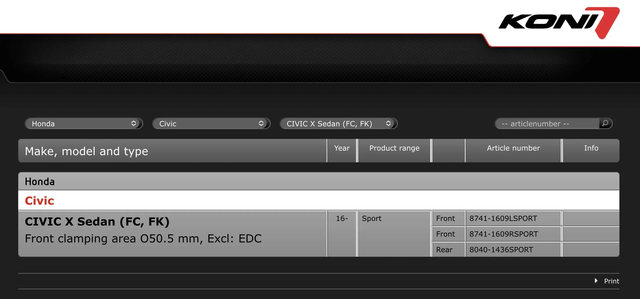

Bumping this bc of excitement 🤣🤣
Just saw the post on civicX that Koni shocks are almost ready! AND I decided to randomly check their website and sure enough. It’s been updated with part numbers! And confirms 50.5mm 😎
Cant wait 🤟🏻
