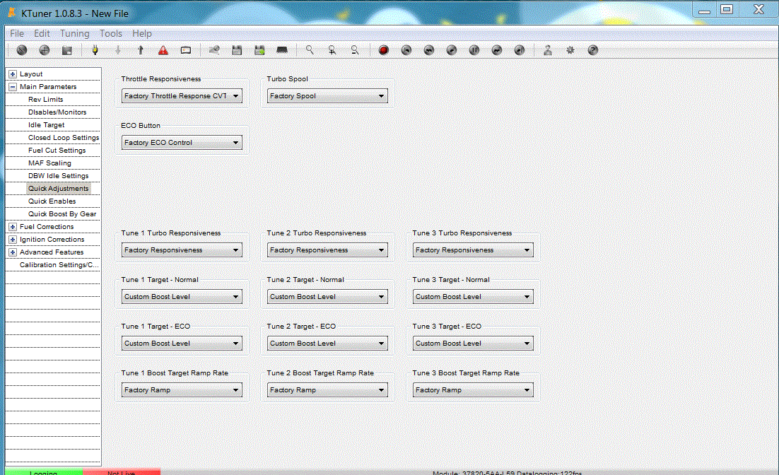

I read up on everything Ktuner but when I went to the quick adjustments it was different than anything I've seen online. I only seem to have a choice of doing the 3 on the fly tunes. All I want to do is the dual tune with ECO as factory. Did something change with the software?

Not different than what you've seen online, we made an announcement about the map switching being available. If you don't want to use it, start with the dual tune and adjust any quick adjustment settings at the top and for tune 1. Tune 1 is default.
Don't switch maps if you don't want to use map switching. You're good to go.

Ok so tune 1 is the base 21 dual.
Should I just leave the boost at "custom" and that will give me the base 21psi and eco boost numbers or do I need to manually type in 21 and say, 16?

Ok. Got it. One last boost by gear question. If I only want to set a limit in first, say 16-17 psi, do I leave the other gears at custom boost level or disabled?

Custom will leave it at what it's set to currently, which by default is disabled. Disabled will set it to 29, which is essentially also disabled! Either one will work, then. You can also see specifically what they're set to in the table list by choosing Boost By Gear Limits from the table selection and going through 1-6 for each gear table.
