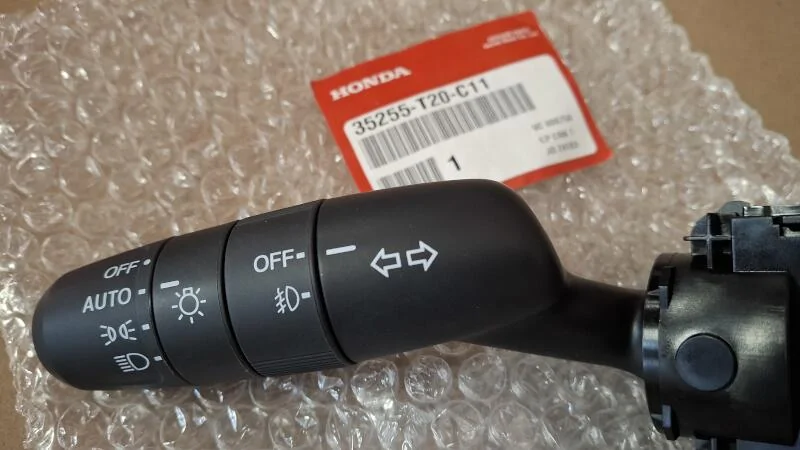

With that out of the way, here are the OEM part numbers:
- Turn signal stalk with fog light switch: 35255-T20-C11
- OEM LED driver side fog light: 33950-T20-A01
- OEM LED passenger side fog light: 33900-T20-A01

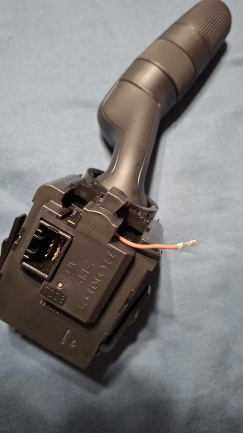

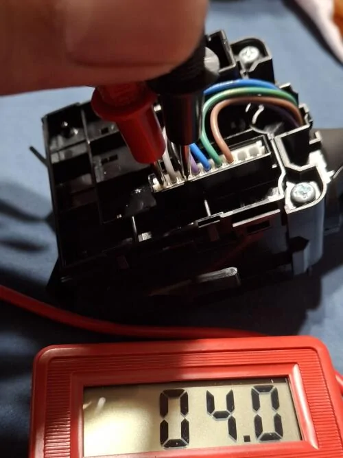

Beginning with the switch, you'll want to release the softer plastic cover on the back of the housing that exposes the wiring. You'll be looking for the tan/brown wire which you can either de-pin, cut, or tap into:
Brown wire on the very right
I decided to de-pin it in order to route it outside of the housing like so:
This will control your relay's signal ground.

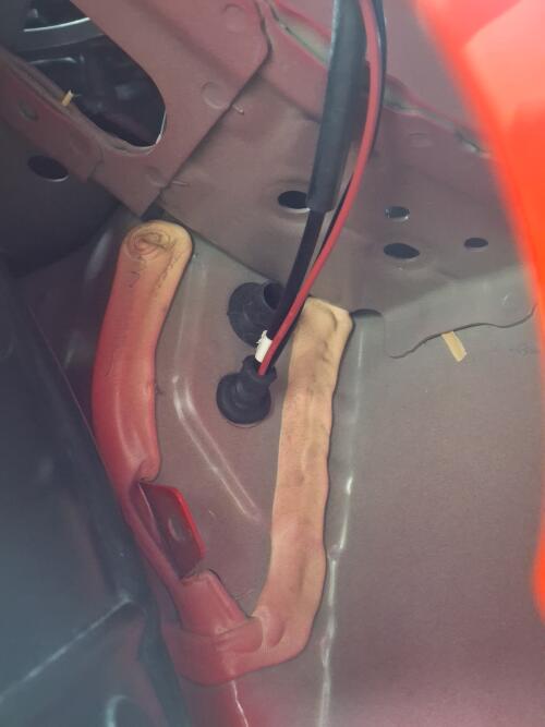

I crimped a black wire to the switch's brown wire, and used a bullet connector to run red wire from the fuse tap. I ran these long enough to exit the cabin, through a grommet and parallel with the hood release cable, the into the engine bay wherever you decide to place your relay.

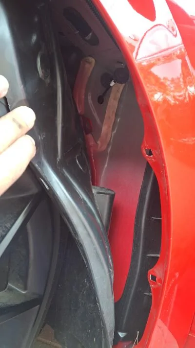

The fender doesn't have to come off, but if you release the fender liner behind the wheel, you'll have access to the grommet:
These two wires will connect to the coil circuit of the relay.

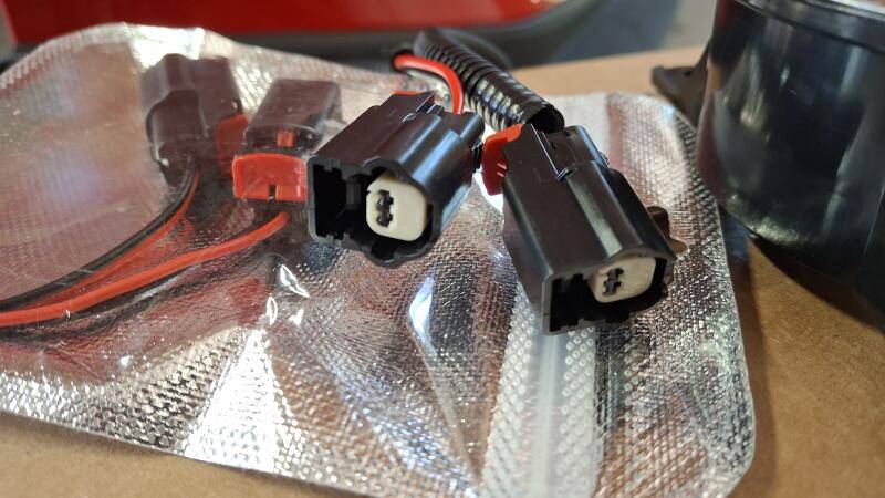

If you decide to make your own harness or try to find one on eBay/Amazon to use, look for a harness with these connectors:
Again, they are L1B.

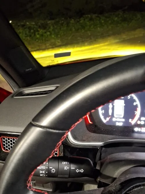

Now for the after pictures:

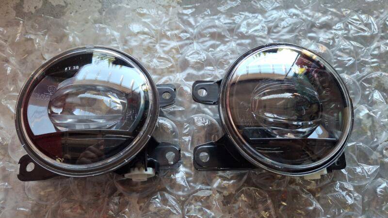

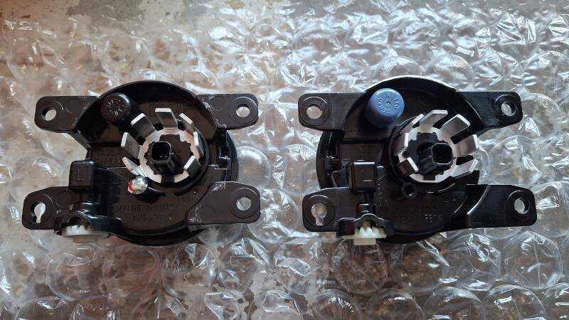

And some comparison pictures of the eBay kit I bought (left) vs OEM (right):
Visually, very accurate, but side-by-side the differences stand out. As well as the "Made in ____" vs "Made in USA" of course.

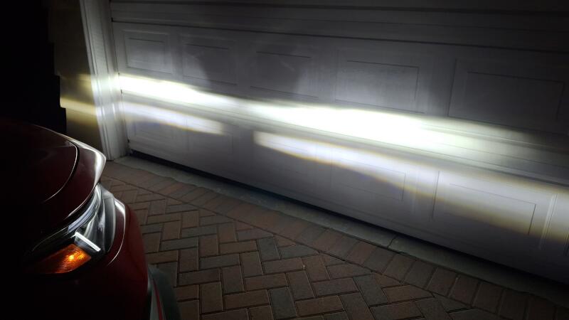

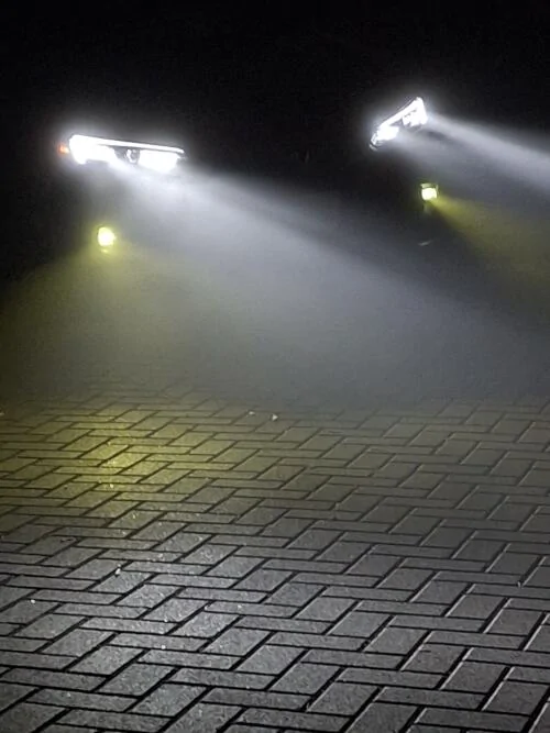

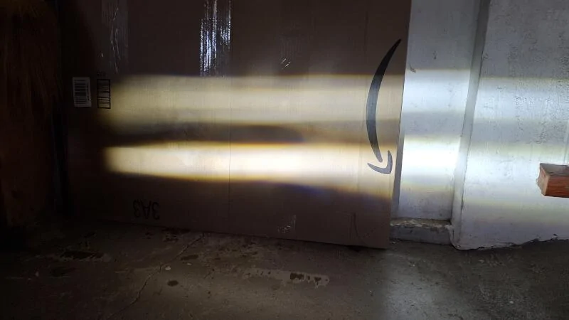

But the OEM beam is MILES better:
eBay on top, OEM below
