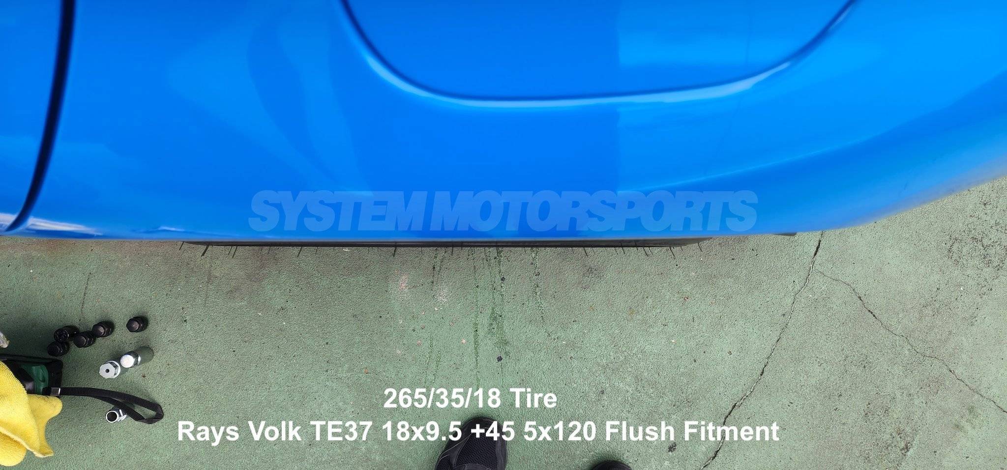

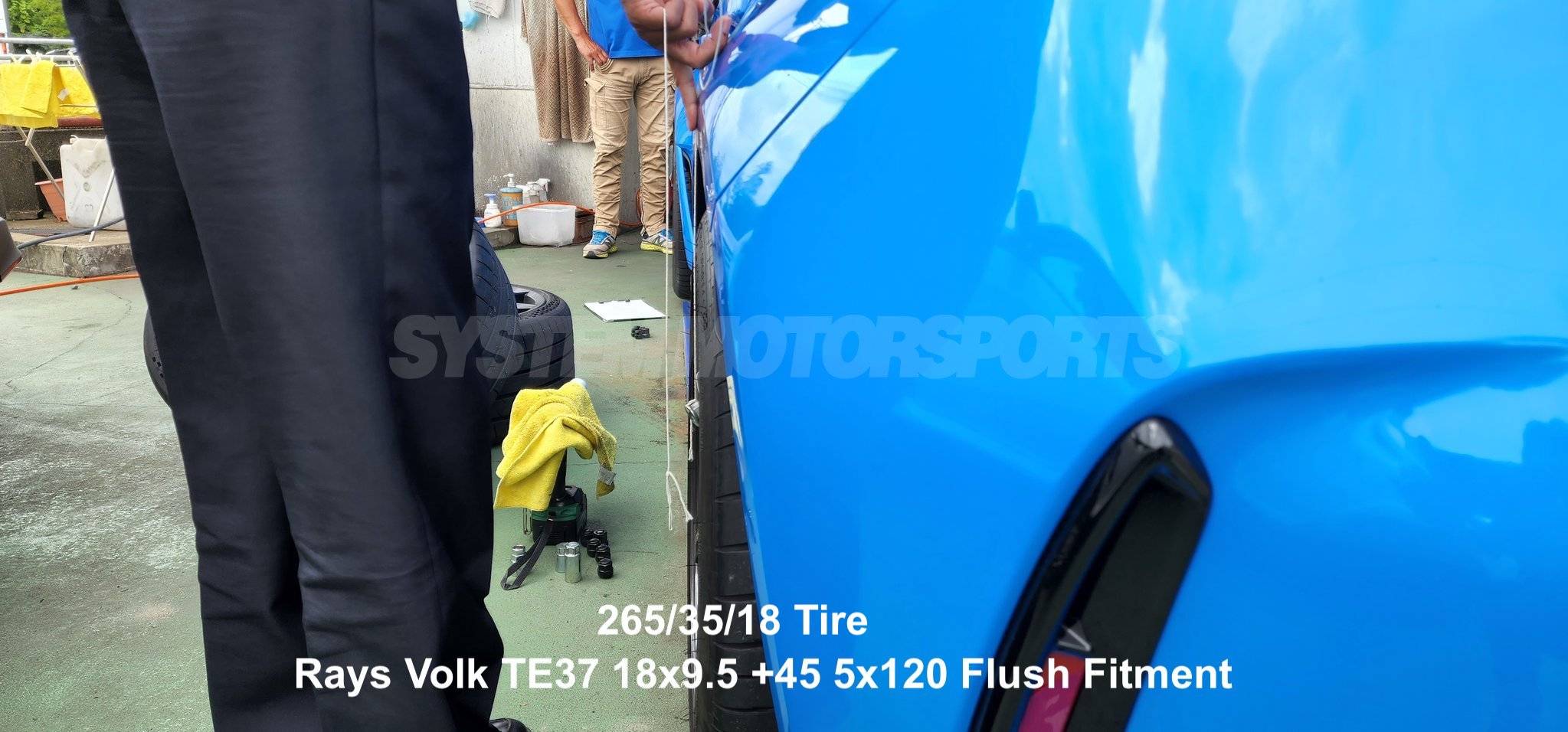

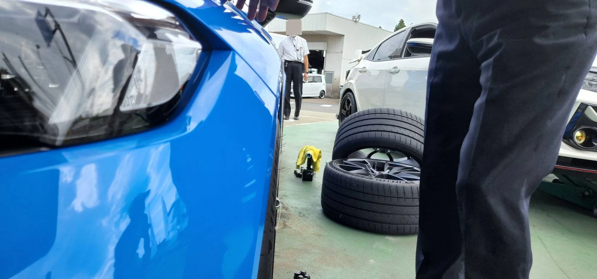

Update guys - 8/31/2022.
TE37 18x9.5 +45 5x120 has been test-fitted, and confirmed to fit the new FL5 11th Gen Civic Type R. Shown is with 265/35/18 at OEM height. Our TE37SL in 18x9.5 +45 5x120 (product listing here) will boast a concave face and will serve as a bolt-on affair for this platform - with plenty of factory Brembo brake clearance (factory brakes are 4-piston 350mm fronts). Next up - time to test fit some 18x10's and 18x10.5's and potentially 18x11's!
Downsizing from the conventional factory 19's to 18x9.5 wheels with a +~45 offset will prove advantageous for those who are looking to increase ride quality, reduce unsprung mass, and increase overall driving dynamic. Going to 18's will allow one to also run better compounds on the street / track. The OE tires are 265/30 on a 19x9.5, and very much like the previous generation, the sidewall is a bit thin on the factory tires. Going down to an 18x9.5 +~45 will enable one to run a 265/35, 275/35, or even a 265/40 tire for improved ride quality. IF one is looking to fill the wheel gap more, we recommend going with a 265/40 on an 18x9.5.

Rays Volk TE37 18x9.5 +45 5x120 Pressed Graphite equipped on the new FL5 11th Gen Civic Type R
More photos + official fitment thread found here. Looks like this will be one popular size, those who had the TE37SL 18x9.5 +45 5x120 from the previous FK8 CTR generation should see their sets hold the best value if they anticipate getting an FL5 11th Gen Civic Type R. Fitment is flush.
