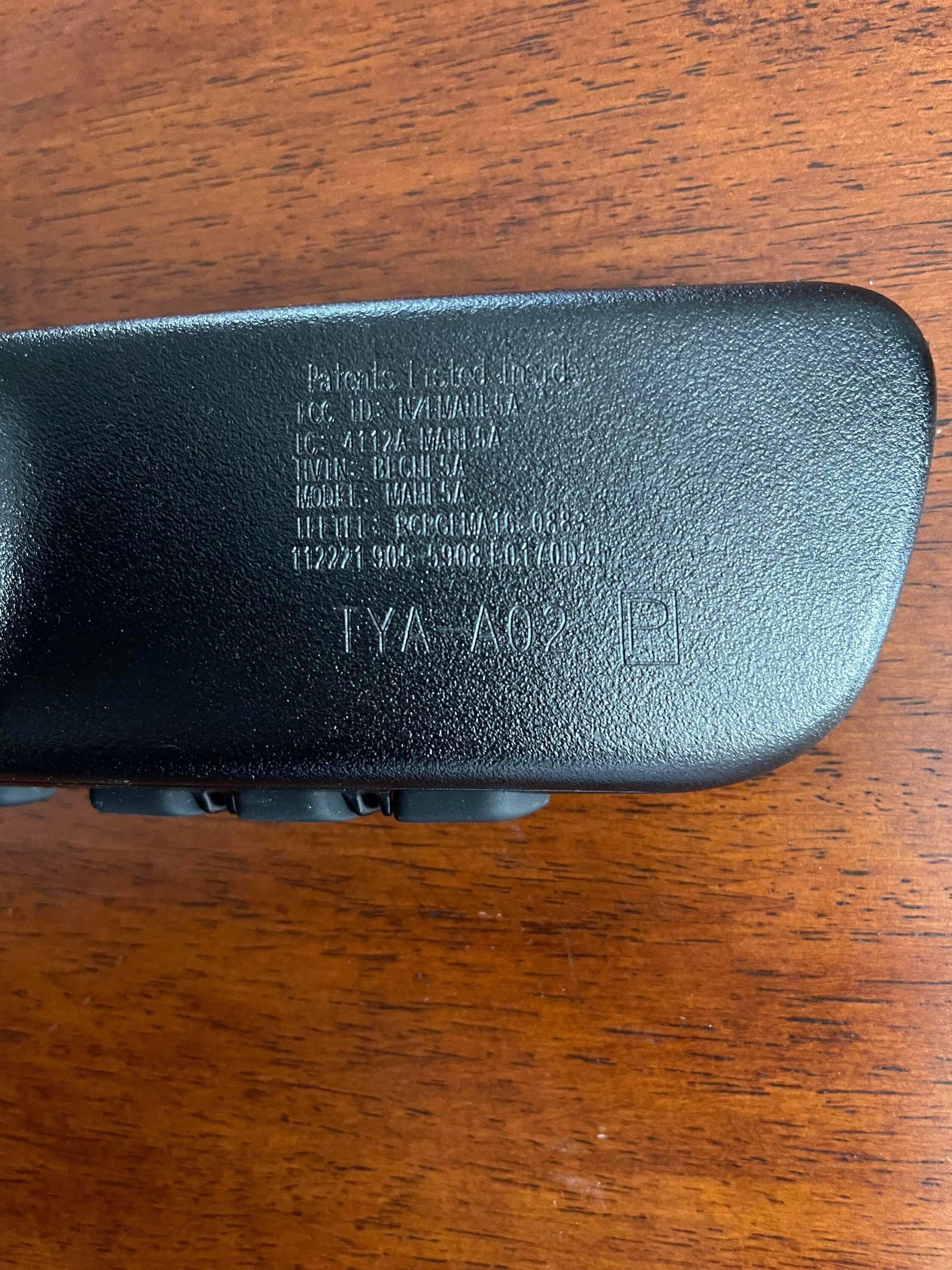

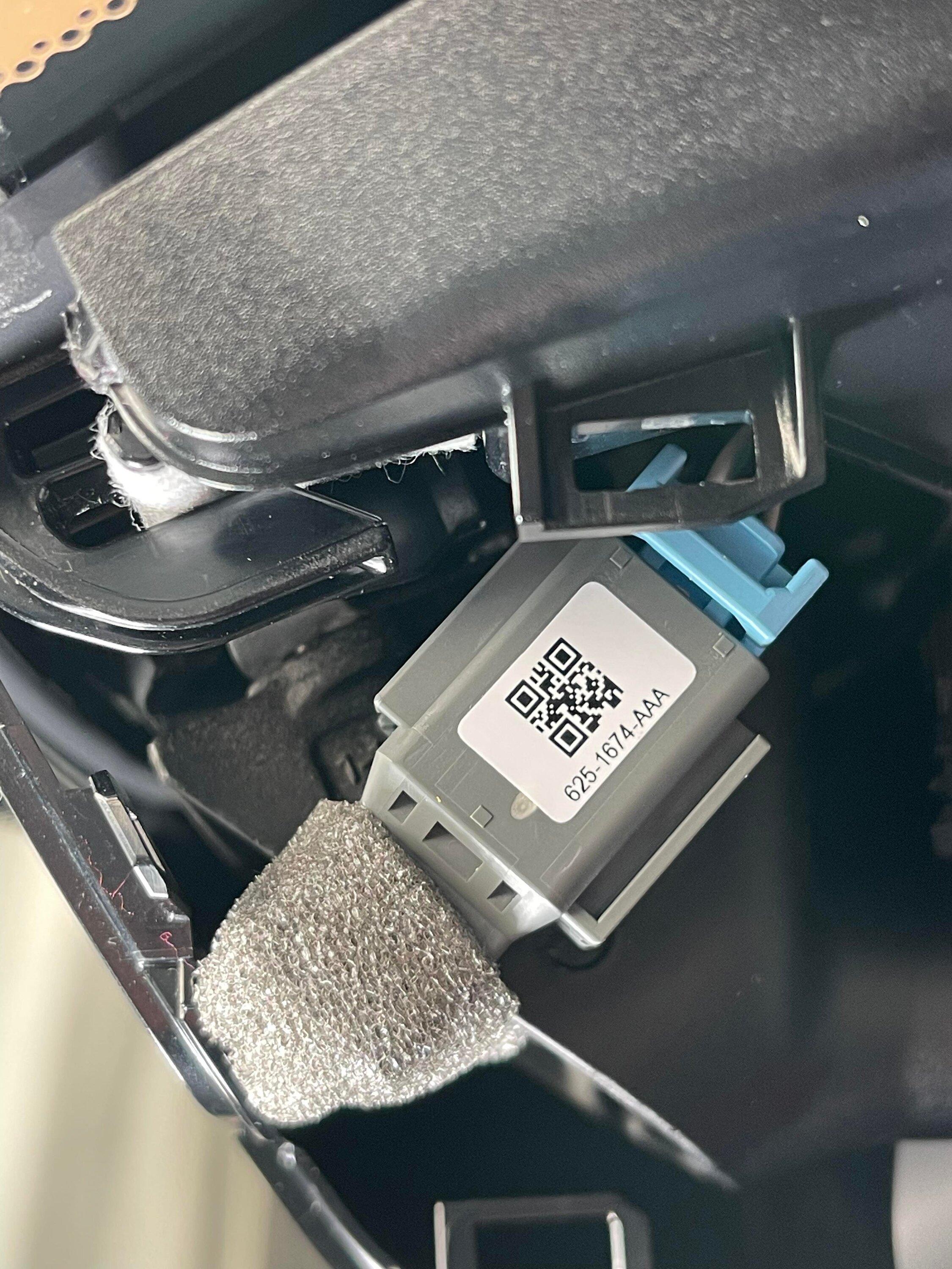

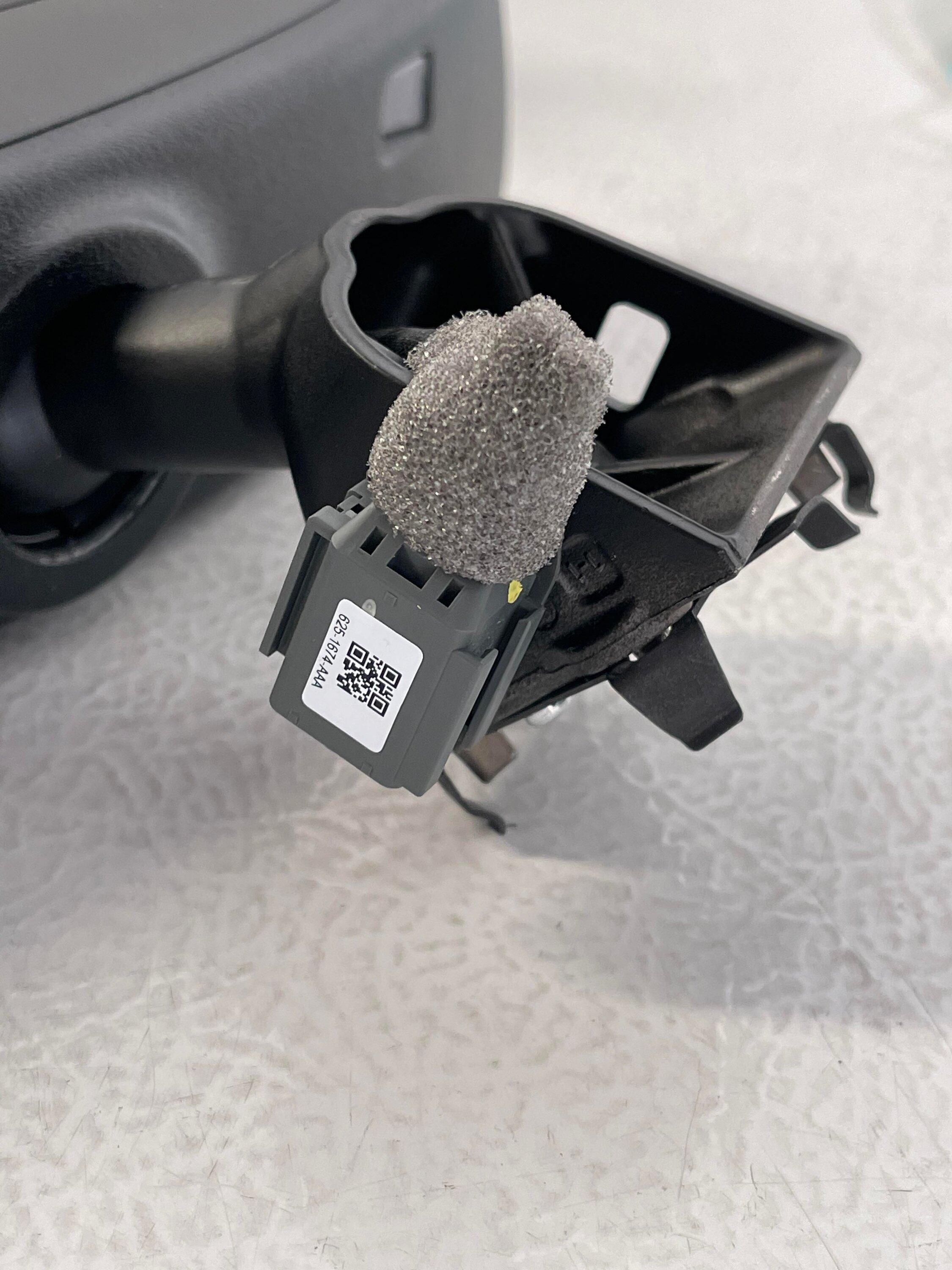

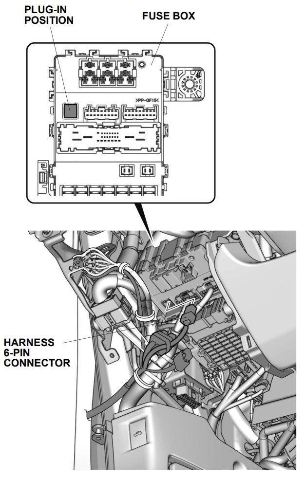

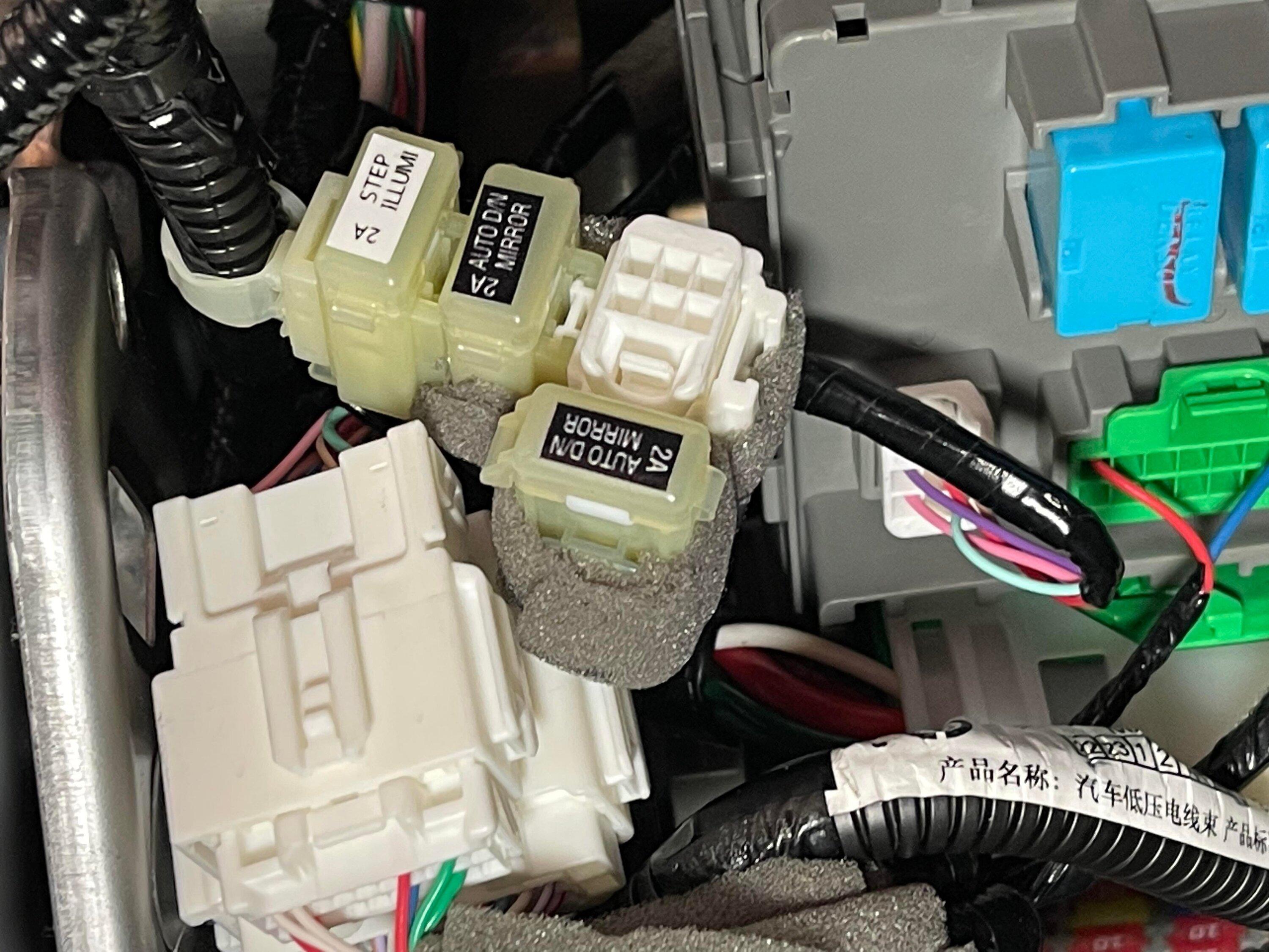

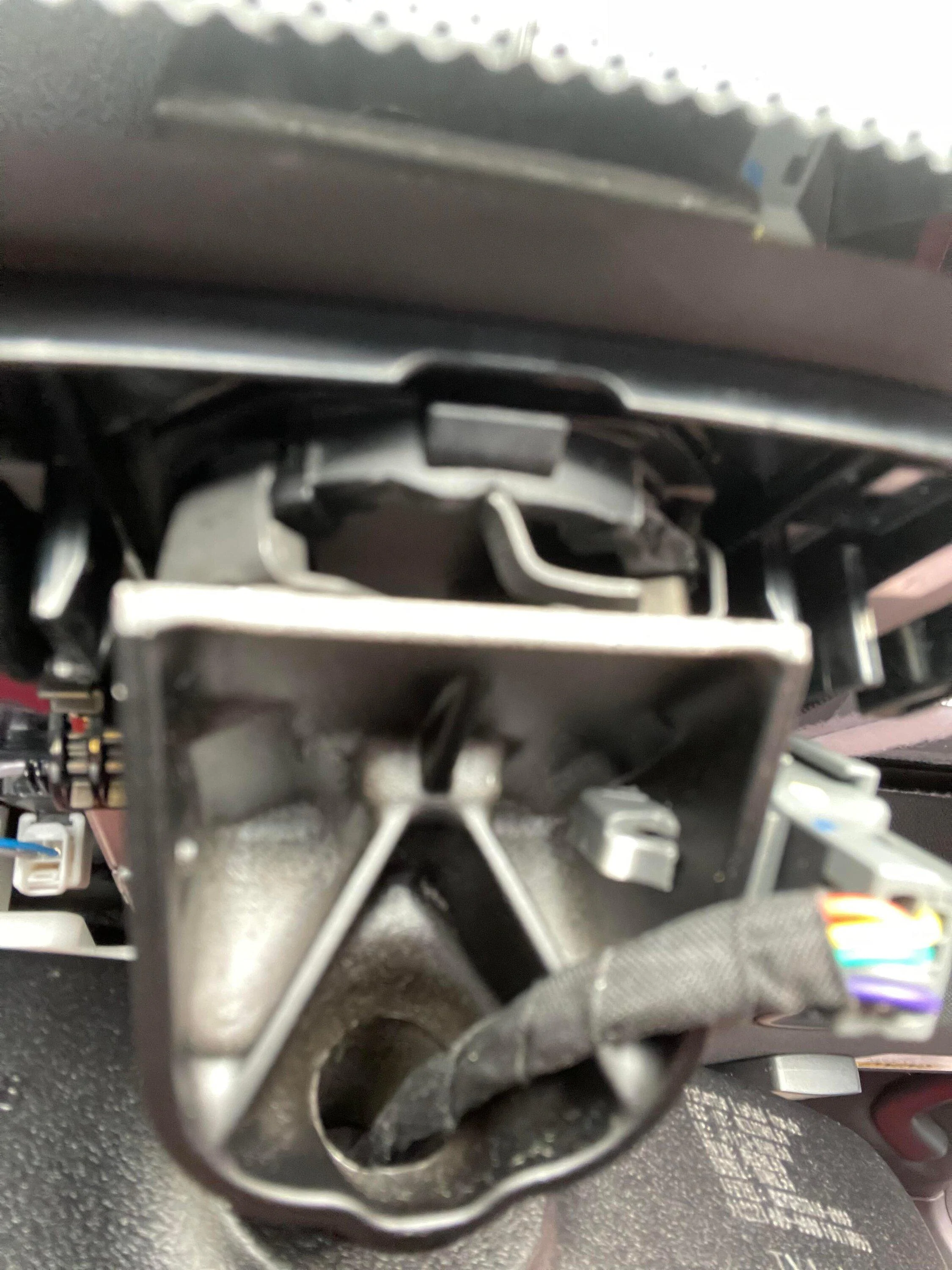

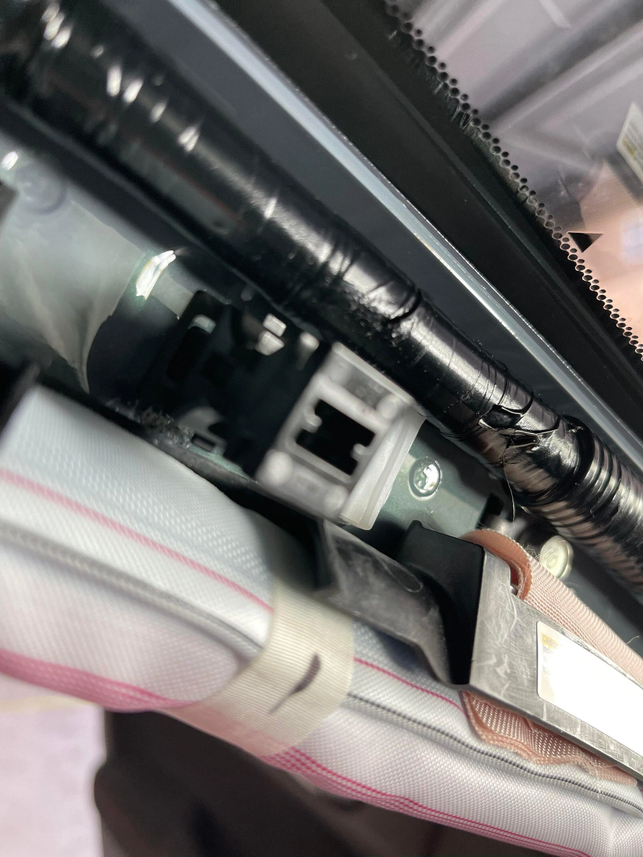

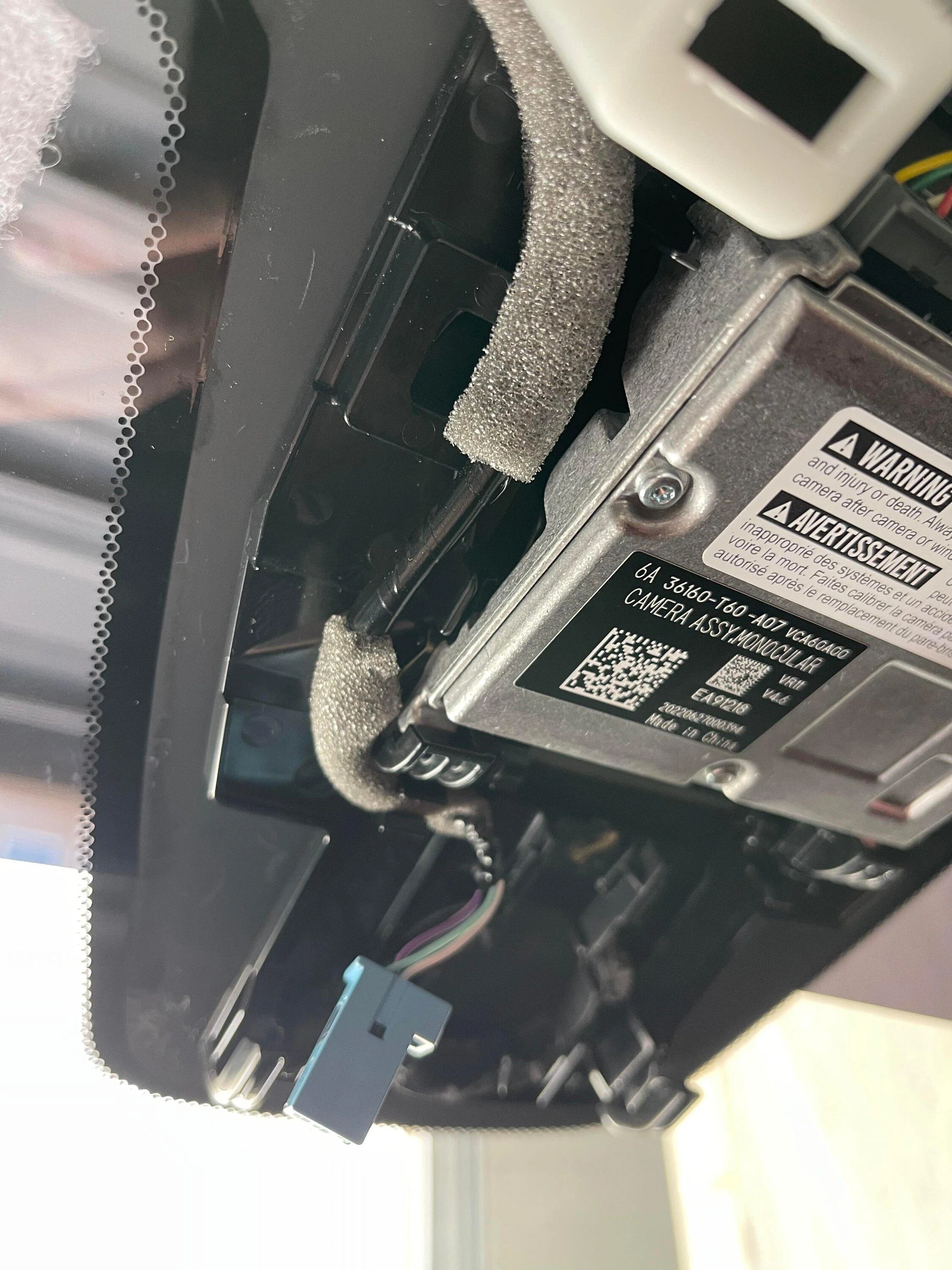

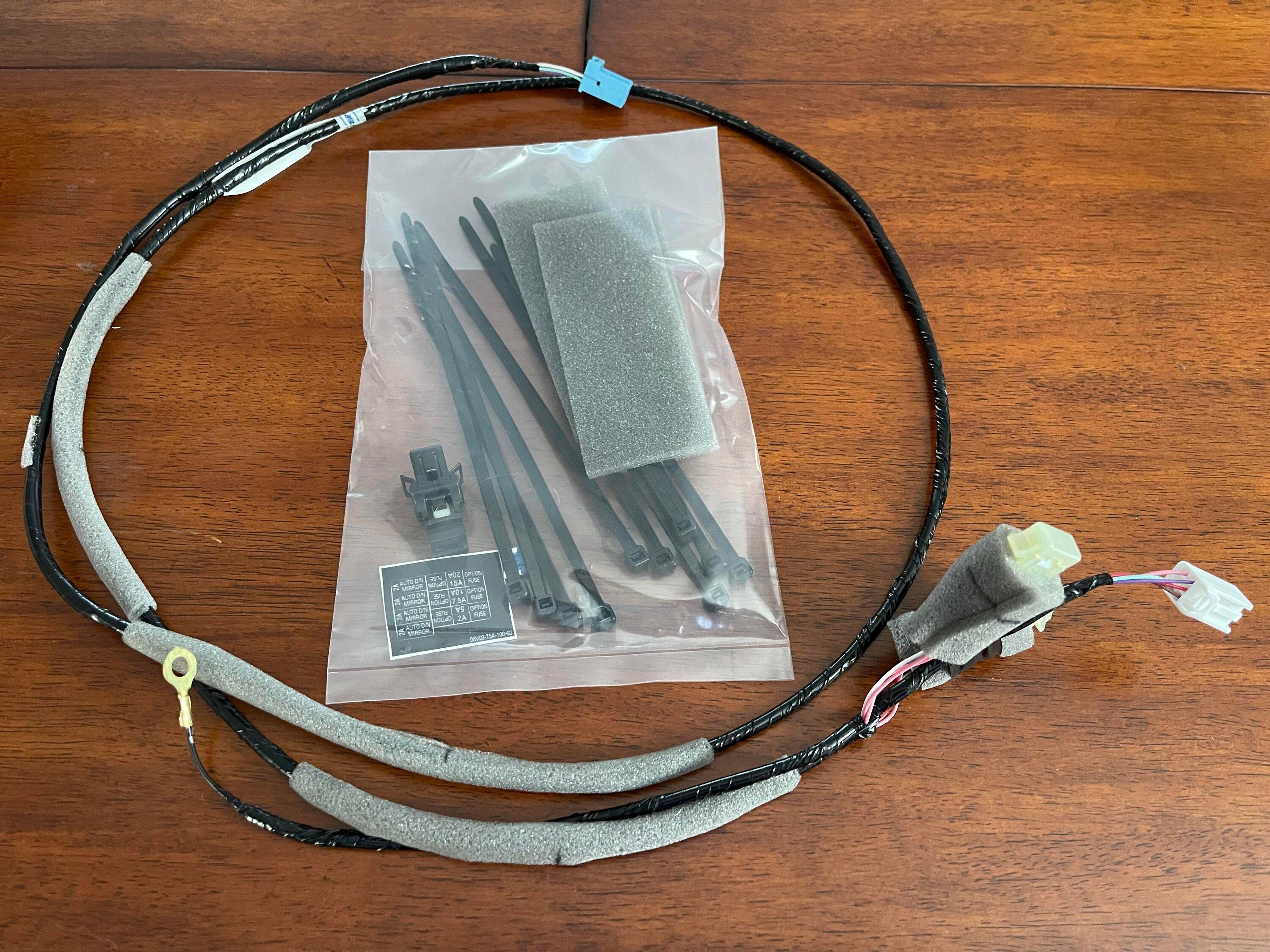

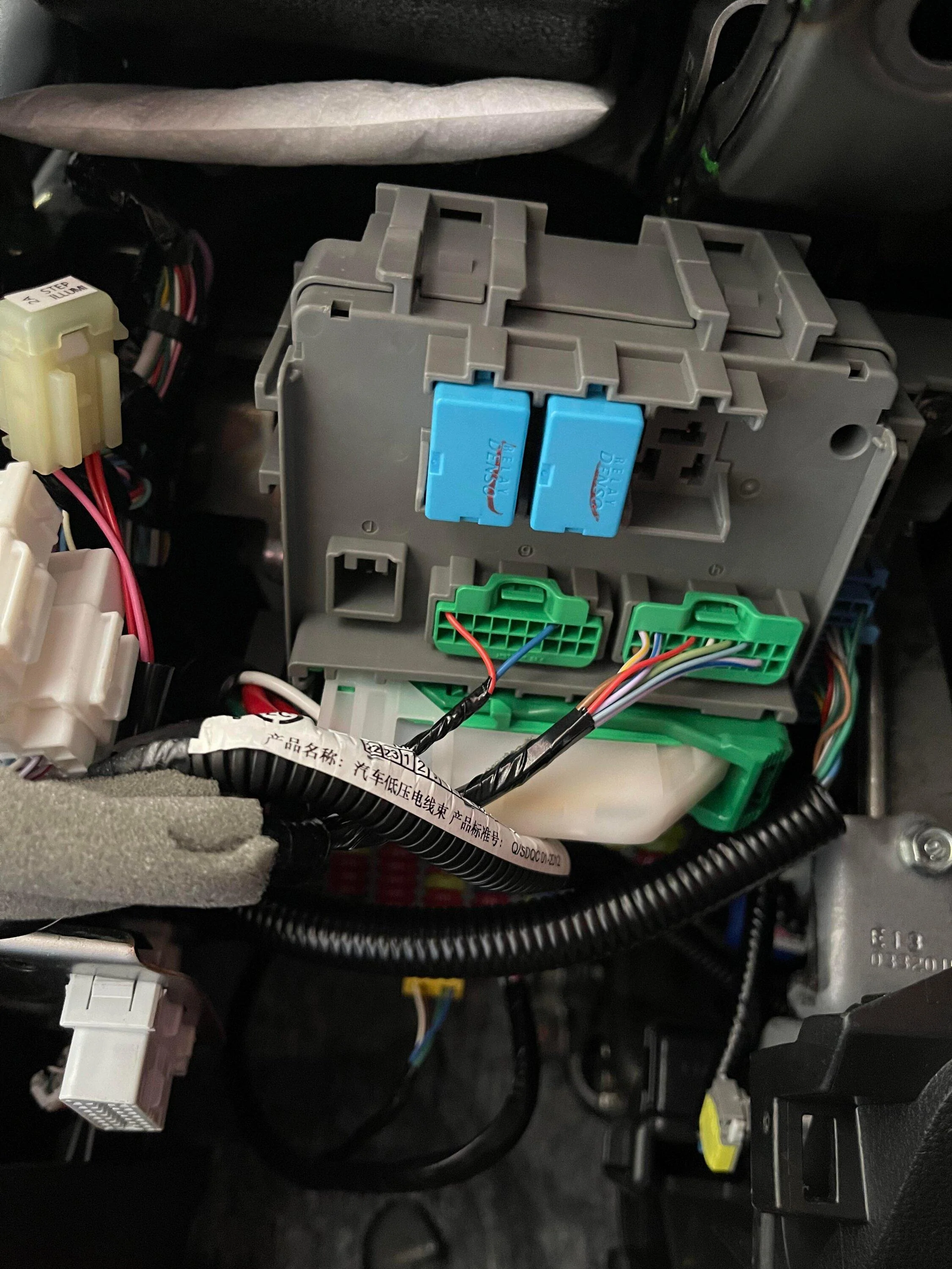

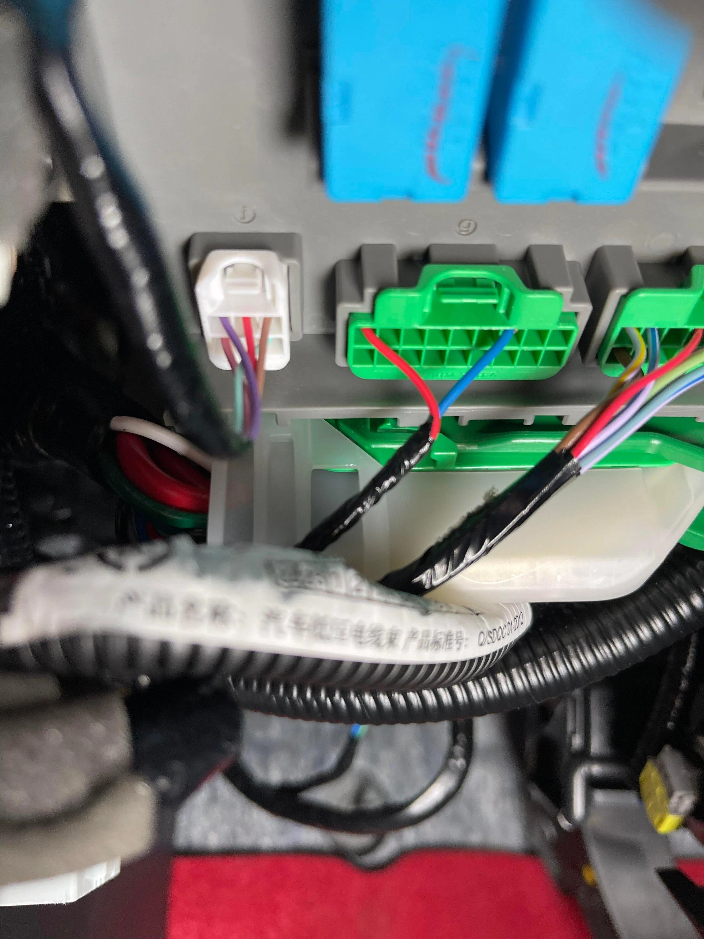

We now have an option available for the FL5 for those of us that have been wanting to add Homelink to the Civic Type-R :thumbsup:
Here is what will be needed.
Plug and play harness 08V03-30A-100
Homelink Mirror 08V03-3A0-100
I will be doing a brief walkthrough of how to install this in the next few days and will update this thread when needed but here are a few pictures and PDF instructions for a 2023 Accord to hold you over till then.
:coffee:
