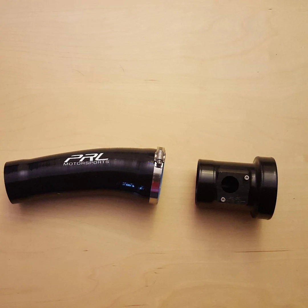

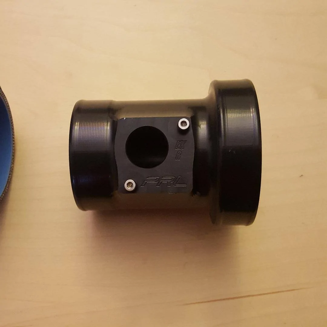

PRL doesn't goof around. The Race maf arrived a few hours ago. Thanks PRL! In the meantime, I'll get the PRL CAI installed and then will contact Ktuner afterwards. A little premature to contact now. Definitely will be testing the PRL CAI and stock maf vs the Race maf at the dragstrip. Particularly interested in the trap speed but everything else as well. I have no expectations. Just like testing things instead of hearsay.
Will take measurments and all as well just for personal documentation.
In all honesty, I'm hoping to knock off 1/10th - 2/10th in the 1/4 mile to a 13.7-13.8 or so. A little progress is always better than none at all. Maybe an extra 1mph in trap speed. Will see! Weather pending of course.
