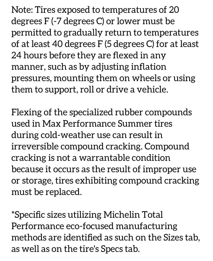

I was doing some recon on the 4s and found that the compound runs the risk of cracking if under duress (flexing) in cold weather. Below is a description from Tire Rack describing it for this particular model of tire.
That said, how do we (in the north) taking delivery in the winter, know that the tires are not cracked out (yes its funny haha) from transport through the cold weather. I just got a quote on all seasons for over $1k just so i can store this beast on a different set of tires. Messed up.

Im just wondering how Honda gets away with transporting them to the tundra without them getting jacked up?

The cars are hardly driven during transportation. I'm sure they're fine even in sub zero temps.
Were you planning to drive the FL5 in the winter? Just bring a set of winters/all-seasons to the dealer to put on. If not, flatbed the car to your storage location.

If its any help, when I owned my FRS, I once drove on my Michelin Super Sports for two weeks in mild subzero weather (25-32 degress) before I changed to my winter tires. Luckily there was no snow or rain during that period in November. As long as its dry and you're gentle with the throttle and turning, you'll be able to get to where you need to go. No cracking from the Super Sports, either.

19" is an odd size and you'll also pay more for 19" tires due to them being an odd size (odd as in a non-standard size). Winter tire choices are going to be limited, same goes for 20". 18" rims or smaller would be recommended for Winter tires
The cracking being referenced isn't usually externally visible until the failure happens [AFAIK], as they're micro-cracks that occur in the structure of the tire, which will eventually cause failure. Summer tires do not function properly once their temperature drops <40F - summer tires have a chemistry that causes them to become sticky once at operating temperature, enhancing grip, however when used at operating temperatures <40F the rubber remains stuff and inflexible, resulting in poor grip and chattering (tire skipping across pavement from an inability to grip the surface).
It's simply dangerous to run summer tires at temps <40F and when doing so, the driver must be aware their stopping distances need to drastically increase at higher speeds, fast-cornering should be avoided due to risk of oversteer [fishtailing], etc. The same is also applicable to All Seasons in areas where snow and ice are common, as they're poorly designed for snow and ice, whereas Winter tires are for snow and ice exclusively (the tread of winter tires remains soft and flexible below 0F, so soft you can literally push your thumb into the tread)
