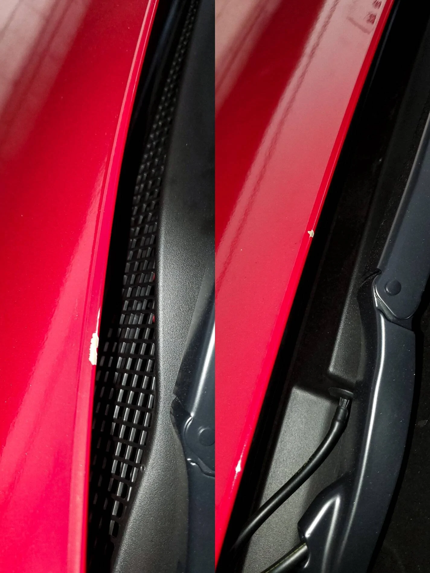

[PSA] Watch out for the new wipers, as paint quality still very cheap
irok
Jul 10, 2021
Los Angeles
'18EX, '22EX
11th Gen Honda Civic [PSA] Watch out for the new wipers, as paint quality still very cheap Fotor_162913328688720
This might be a design flaw.
I had the 10th gen, paint quality wasn't good either, but this chipping never happened & early
The new wipers are more complicated & way heavier, watch out when you put them up, especially if you turn off or turn on the engine, they will move a lot more than the old one.
Had 1 small rock paint chip in the bumper too, but this one is annoying since you see it all the time.

Hey irok! I assume both of these areas are at the top of the hood, closest to the windshield?
Yeah, i also have paint chips in the bumper already, it's very thin & soft
i saw a YouTube video that the 11th gen paint is like almost 2x thinner than the 10th gen, which was already thin in the first place

Oh yeah I've made some comments on the other forum about those videos. How did your chips happen? Can you share a video of how they rub against the edge?
They just fall easy because it's heavy since the jets are on the wipers now & too close to the hood. Also when the engine starts, the wiper blades move

Those chips are 1-2 inches from the wipers. How the hell do they move down that much? Mind posting a quick vid? I'm having a hard time visualizing...
If that's from the wipers, this is a serious problem! Those chips are unacceptable!!!! Yikes!
It's when you put them up, sorry I'm scared to chip more paint lol i seen 2 other people with it including the guy in the video

That looks pretty bad. Did you contact your dealer?

I think I see what you mean--so when you lift the wiper blade, say to wash underneath it, correct? I guess it's important to always put the wipers in the service position when moving them manually.
When the engines turn on or off they move a lot

I chipped the edge of my hood in the same place. I was cleaning the windshield and had the wipers up.I lifted the hood to check the oil and hit the wipers. Here's my sign ?

Lots of misinformation in this video. Though I question any guy giving advice on paint if he can't figure out the paint code...
1) Paint code is B593M, not AG5. Aegean Blue metallic is the same as Brilliant Sporty Blue Metallic. Sales picks the name to sell it under.
2) You can't compare film builds from two cars built at different factories using different materials and different equipment. There is no difference in the paint thickness between a 10th gen and 11th gen built at the same factory with the same colour. That being said, all factories are held to the same durability requirements. Solventborne vs. waterborne vs wet on wet vs wet on dry vs etc. all play huge parts in the paint materials.
3) The fact that he's getting so much lower film readings on both hoods tells me his gauge likely is not calibrated to read properly on aluminum vs the rest of the car being steel. Honda does not skimp on the hood. There's an extra layer of material on all Honda hoods specifically for improving chipping durability.
Fact checking is important.

Dude, I did that once in my old BMW 328 and my S2000 when my wipers where up and I opened my hood.
This isn’t due to cheap paint… it’s due to Metal On Metal. That’s basic life man.
