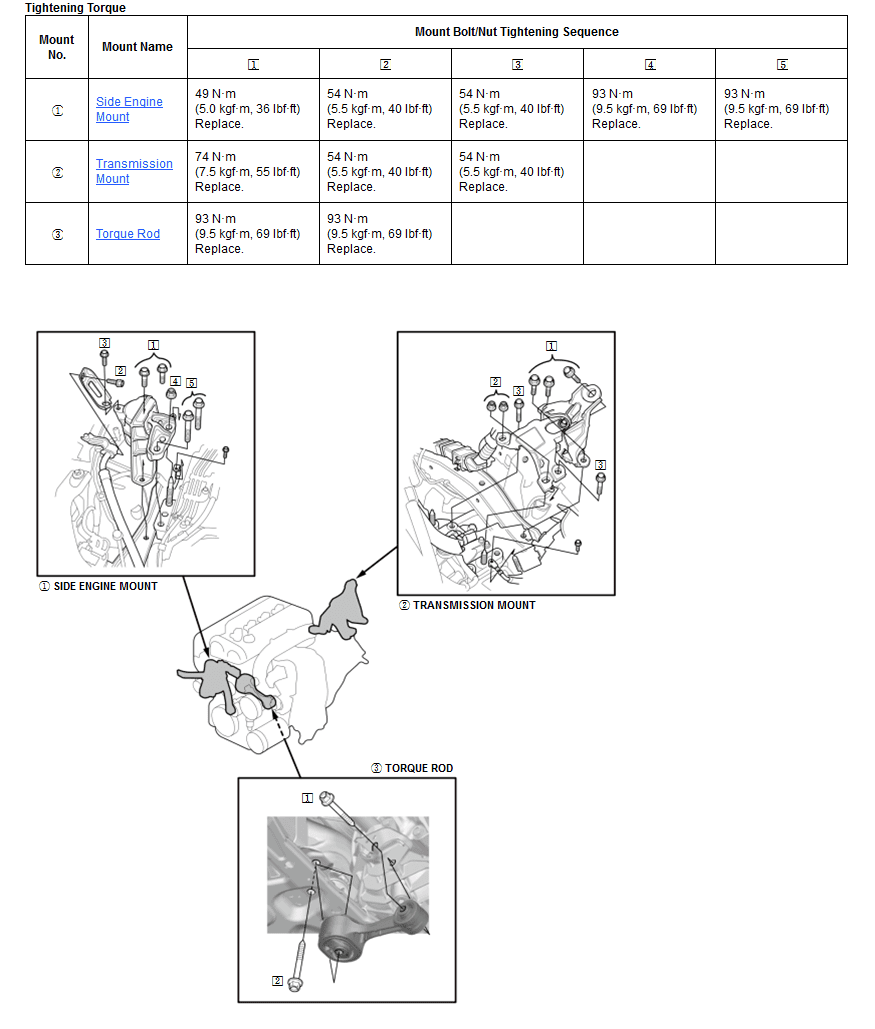

I'm looking to install my PRL rear motor mount soon, and I'd like to get the torque spec to be correct. I looked at a couple install videos and it generally seems like people are using a normal 19mm wrench to get in the space for the horizontal bolt. But it doesn't really look like there's enough space to get a socket with a torque wrench in there. Has anyone who installed it ran into an issue torquing the horizontal bolt to spec? Or maybe most people didn't use a torque wrench? I'm pretty new to working on my car/installing mods to my car so any advice would be helpful!

Not only torque spec but I'd wonder about lock tight blue or red, just to make sure it stays tight.

I use an open end ratcheting combo wrench for the bolt closest to the downpipe and a crowfoot wrench with a torque wrench to torque it down.
I use the torque specs from the 10th Gen Civic/ FK8; 69ft lbs.

i saw someone use a torque wrench in a video with long extension. i just used a crow's foot wrench. had to work with what was available. used a torque wrench on the chassis side so i'd know approximately how much force to use. you can also just use a regular box wrench but i like how the crow's foot has more points of contact so less chance of rounding out the bolthead.
also 6-point sockets are superior to 12-point.
